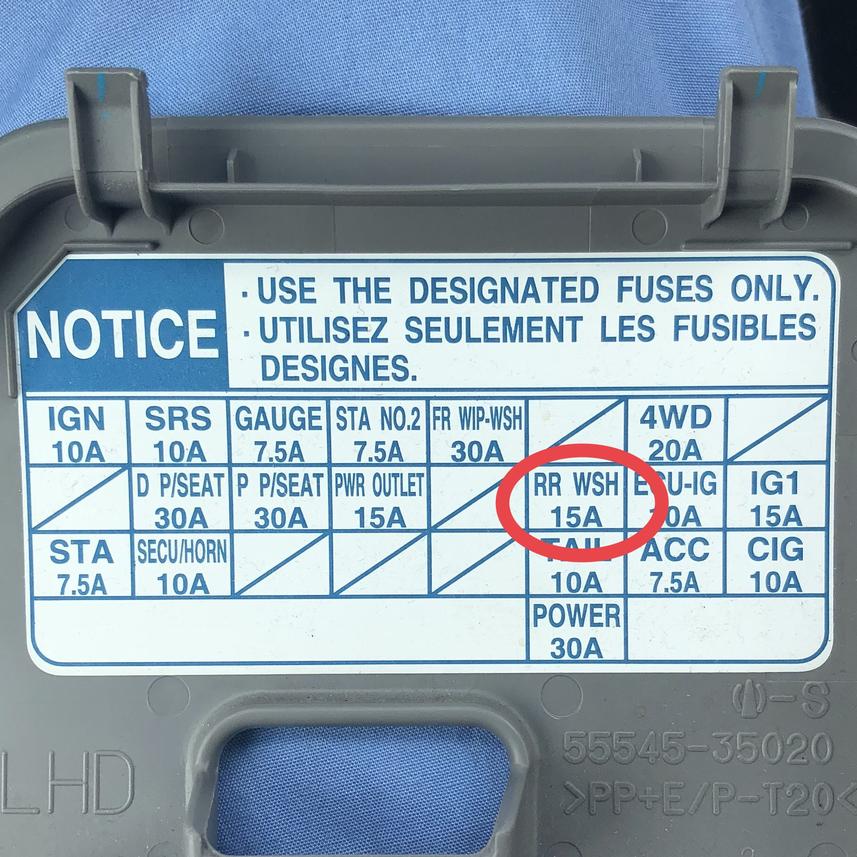

I’ve read through this thread and have even posted my question in it (last post of the thread. I’m sorry if I wasn’t clear but the solutions recommended in that thread have not helped as 1) through no method will my rear windo raise or lower, and 2) I’ve replaced the fuse I assume to be linked to the rear window (believe it’s RR WIND in the cabin fuse box.)

Am I referencing the correct fuse?

Also relevant, I suppose, every other window is functioning properly. The rear defrost asduminglynisnt working (based on the observation that the dash button won’t illuminate.)
The third post in this thread (below) indicates that power to the rear window (and the two rear side windows) is through the 30A Power fuse.
http://www.toyota-4runner.org/problems-warranty-issues/43351-power-rear-window-problem-4th-gen.html
Since you indicate that the other windows are functioning properly, that would likely rule out this fuse as the source of the problem.
