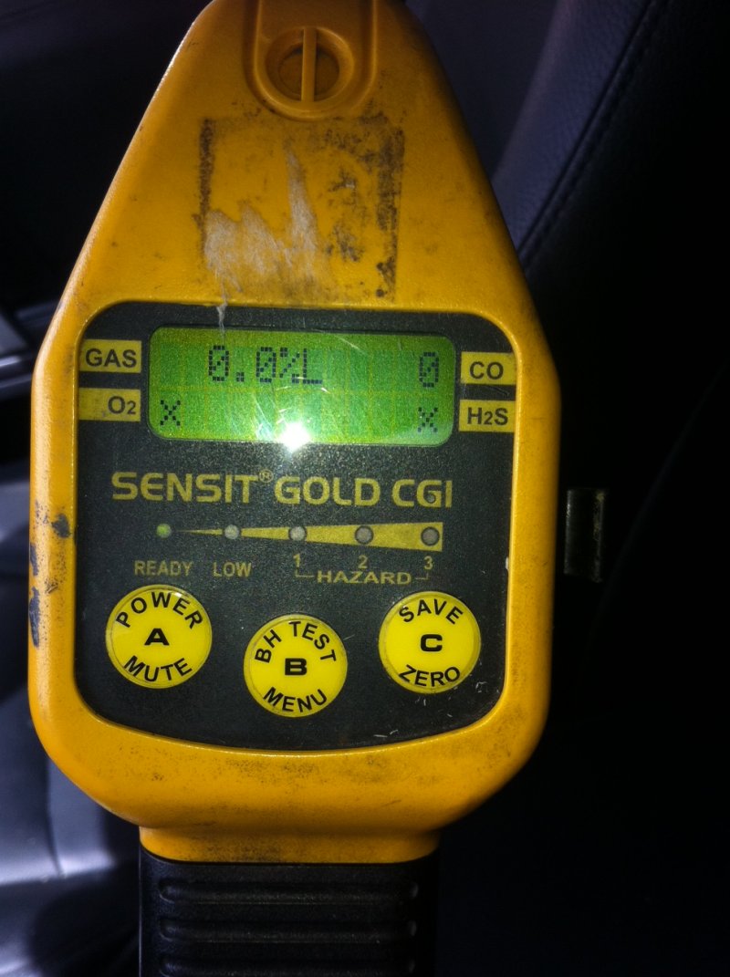

Ok, so we did the test about 30 minutes ago. I didn't get to go on the highway, because my coworker was pressed for time.
Keep in mind, regardless of the results I got, do not take this as an experiment done in a controlled environment. None of us are scientists.
We used a Sensit Gold CGI. I had a coworker sit in the back seat and position the sensor in the cargo area. My 4runner was at operating temperature and there was little to no wind here today. I had all windows closed and only the hatch window open.
Sitting idle in the parking lot:
When we were sitting idle, the CO reading was 0. It remained 0 until we backed up and went to leave the parking lot. At that time, it read 1 very briefly (a candle burns around 14, for comparative purposes)
Around town:
We drove around town for several minutes. There were stop lights and stop signs. We went into 25mph, 35mph zones and 45 mph zones. Stopping a few times at each part. The meter read 0 throughout this entire time
Hard acceleration:
I floored the car from a light (0-40mph roughly). It read 0
Idle
We then went back to the parking lot and positioned the sensor right in the backseat area this time, and let the truck idle. It still read 0 after several minutes
I had a conversation with one of our supervisors in the metering department. He said he was not surprised we got a reading of 0. He said the only time he would think any CO may enter the cabin area, is stopped at a light. But our test showed 0 when we idled in the parking lot.
Take this for what it's worth. I will continue driving with my rear window down.

The test was done in an actual day-to-day driving condition. The point is, we used one of the best CO detectors made. If there was CO in the cabin, it would have picked it up. This device is SUPER sensitive. This particular piece of equipment is used at tank yards, businesses and customers' homes, by our technicians, to find various types of gases/leaks. This is a detector several fire companies use across the nation. If CO was not registering when we were at stop lights, accelerating from stop lights, turning, or general stop and go traffic....when would it?
While none of us are scientists, it doesn't take a genius to figure out no CO was getting in. Our techs aren't scientists either and they have the ability to tell if there is a leak or not in various environments. Furthermore, I don't believe any other test has been conducted on a 5th gen, informal or not. As I stated in my previous post, operate your vehicle at your own risk.
