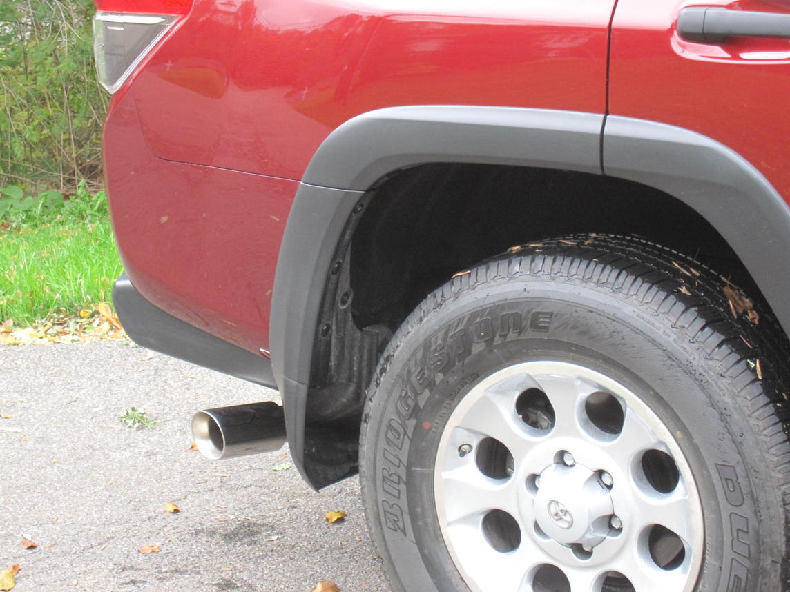

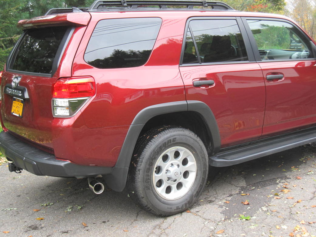

I went ahead and had the tailpipe rerouted to exit the passanger side behind the mudflap as a couple of others have done here. No maganflow or anything cool or special just the 2.5" pipe into a nice chrome tip that is also welded. The results were immediate. I can honestly now say that this has taken care of my sucked in exhaust problem. Also it won't be mistaken for a Rav4 from behind.

All hatchback and station wagon vehicle body types will draw up whatever is behind them and deposit it on the back of the vehicle because of the lower pressure that forms behind the vehicle as it speeds up. Trucks with cube boxes etc will do this as well. It's how air flows, and that's why there is a wiper back there to remove road spray and whatever else gets on the vehicle from being sucked up behind it.
Just wanted to see if the side exit exhaust fixed the fumes backing up into cargo department long term. I have a 2003 and can not use the back window due to fumes as well. If this is the fix, I'll remedy this weekend.
