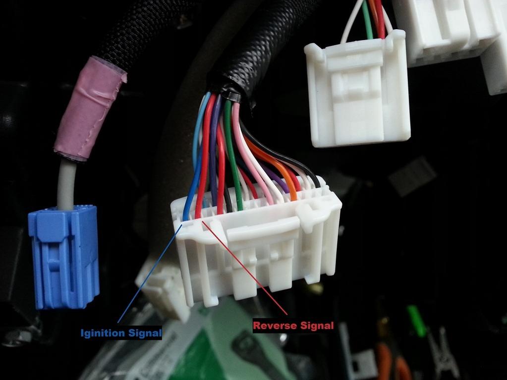

Ok, I did a bit of probing around in my car with a DMM and I've come down to this conclusion (note, this is based off a 2012 TE w/ entune nav, but I'd imagine that it should be pretty similar for all entune nav units).
I am about 90% certain that the below picture is the correct plug and pins you need to splice into for the rear camera mod, but of course my car is not operational so I can't verify these pins during actual operation.
I did however used the 2010 EWD posted by Nashman as a guide to tracing the wires at different junction points throughout the vehicle and this is how I deduced the pin layout depicted below.
It appears that most of the wiring harnesses are pretty similar between the 2010 and 2012 models throughout the vehicle, and only some wires were moved around to accommodate newer components.
The plug you are looking for is a 28 pin white plug, it should be pretty much self explanatory because this is the only plug back there that looks like this.
Once you've located this plug and before proceeding to cut and splice, could you please take a DMM and verify that the blue wire is a switched +12v ignition signal (which goes on and off with the ignition switch) and that the red wire is a switched +12v reverse signal (which goes on when the gear is placed into reverse)?
If the signals on each pin turn out to be correct according to your DMM, then the rest of the mod should be smooth sailing from there...(1) cut the red wire, (2) connect the nav end of the red wire to center pole of the SPDT, (2) connect the harness end of the red wire to one of the switched poles of the SPDT, (3) don't cut and just tap into the blue wire and connect that to the remaining switched pole of the SPDT.
Please someone correct me if I am wrong, but I think it seems like we should be in good shape?
If I beat you to this mod, I will of course update this thread, but please note that I work at a snail's pace when it comes to all things car related so don't hold your breath :p

I can successfully confirm " IT WORKS", this for a 2013 with Entune Nav.
All credit goes to Eddie on this one, I was just the first to hook it up.
