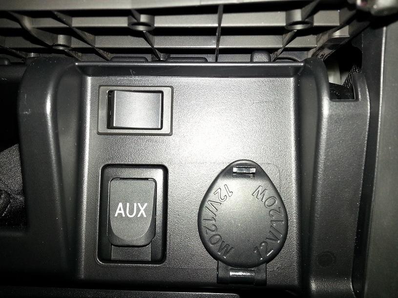

Is this factory fit and finish enough for ya? :)
OK so I just finished this mod on my 2013 TE w/ NAV. Here's some pix...
OK so one thing I'd like to say about installing the switch next to the cigarette lighter. Follow this order when disassembling:
1. Remove side dial covers
2. Remove AC Controls
3. Remove NAV
*4. Remove center console covering (Remove both shift knobs by unscrewing)
*5. Remove thin but wide grey plastic strip between bottom of Cigarette/USB peice and center console. You'll see it between the 4wd shift knob and black plastic of the Cigarette bin.
*6. Finally remove Cigarette lighter piece by pulling straight out.
