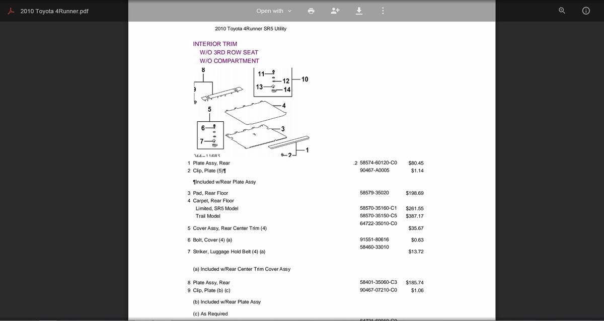

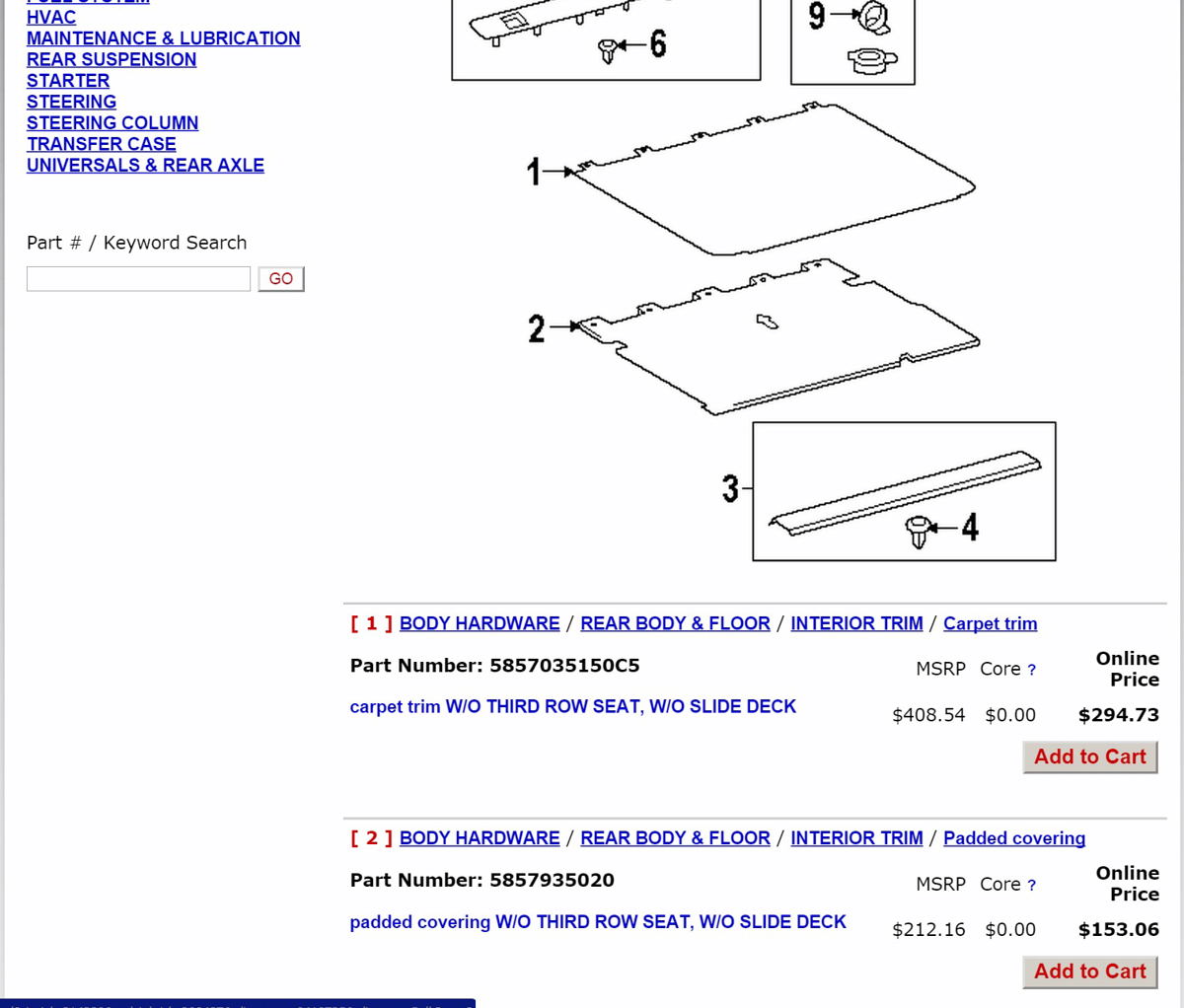

In the image you show, do you have the P# for the rear floor pad? Looks like that should return this area to the SR5 layout and all i would need after that is a weather tech or husky liner.
I also think you could move it back there without too much loss of reception.Those images are out of the repair manual that doesn't usually list part numbers. Part numbers are in parts manuals. I have a link in the "STICKIES"for the parts manual in pdf form in my google docs of a 2010 manual.Some part numbers and or parts of course do change over the years but this should get you in the ballpark. Or many dealership parts depts have the parts catalogs online,like this one that I usually buy from and they are one of the cheapest I found..... 2010 Parts - Camelback Toyota Parts - Genuine OEM Parts - Free Shipping
Here is the part number on page 170 of the manual I have that I copied for you and what that 58579-35020 part number came out to on their site..................
