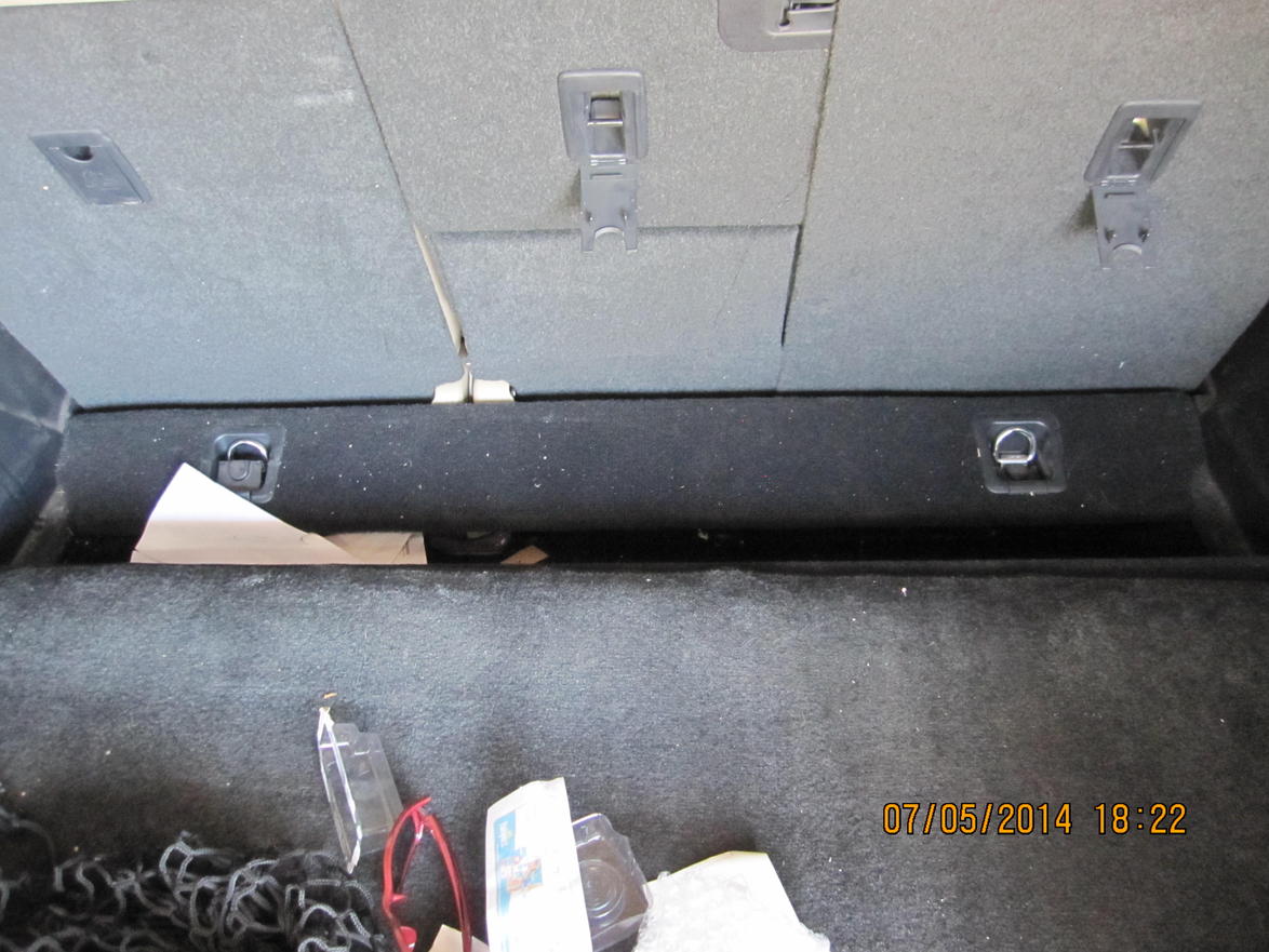

I was not aware of the box, mine came with sliding mechanism and was plug n play. fully extended tray these is hole but it`s not bothering me much.
maybe I should check it that box available by itself.

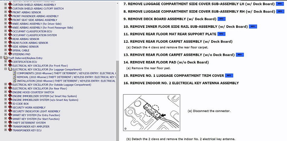

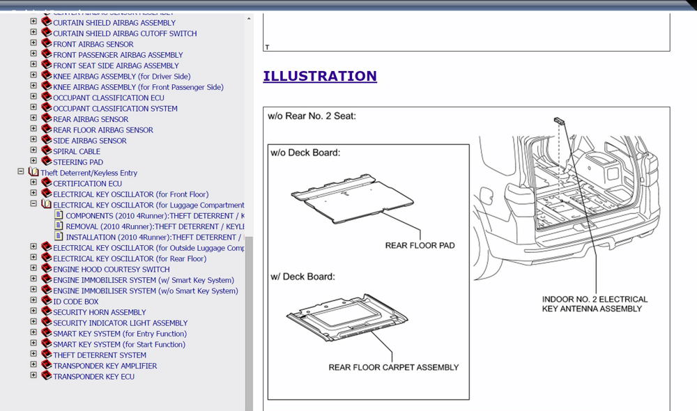

I pretty sure I found it in the repair manual!:50cal: It called a luggage compartment "Electrical Key Oscillator" or a key antenna . I guess it's to pick up the keyless entry signal from the rear of the truck.I had been looking under under crash sensors but they look different.
Removal

Thanks Harper, that's great news. Now I guess I don't need to tip-toe around that thing.
In the image you show, do you have the P# for the rear floor pad? Looks like that should return this area to the SR5 layout and all i would need after that is a weather tech or husky liner.
