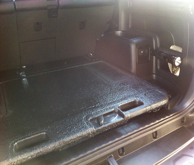

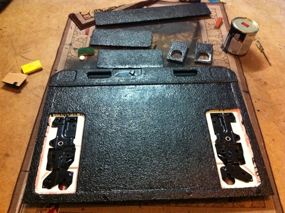

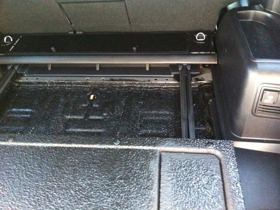

Yesterday I finally got my s#@t together and pulled apart my sliding tray. I had been kicking around the idea of putting Hurculiner down on the tray and on the bed underneath for a while now. I absolutely hate the carpet back there and as my dogs are in the back nearly every day the majority of my time spent cleaning is hunched over the tray and the back seats trying to pull Ridgeback hairs out. :ybrick: I followed the excellent write up by Harper7 and after ripping off the carpet from all the various pieces (huge PITA) I put down two coats of Herculiner on the tray, the bed underneath and all the pieces that cover the storage box. If I could do it over I would not have covered the plastic on the tray, might have looked cleaner. Oh well. Next step is to find a rubber mat that will last and cut it to fit. I have a Weathertech mat that covers the sliding tray but its to slippery for my dogs.
Still have to figure out what to do about the back of the seats. I know that some Runners have plastic backs to the seats but the parts department here in Hawaii doesn't think they exist, even though the one I test drove had them in it. WTF.
