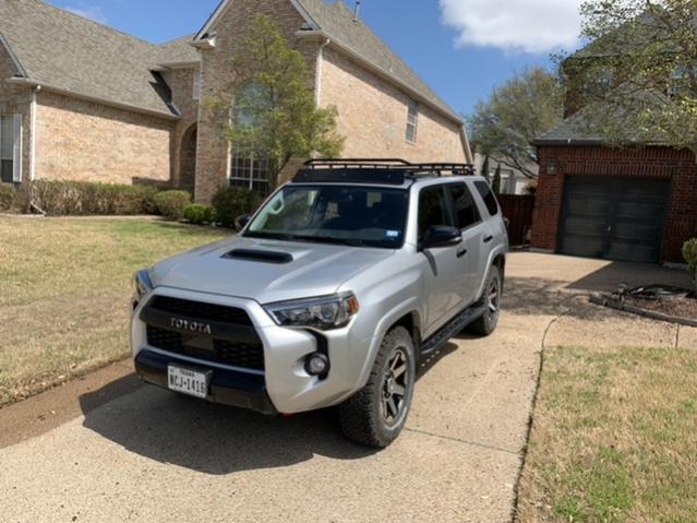

I put the pro grill on my Venture and didn’t have to remove the lights. The front is exactly the same as a TRD Off Road.

That dude just did the equivalent of pulling his pants down to fart; working too hard. They're the SAME exact front end..Ventures just have some fancy random stuff thrown onto it.
