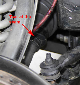

I have a tendency to agree with you here. My tear was exactly on the seam where it attaches to the axle. Figure this is the highest point of fatigue on a full reversing load on the boot. The rest of the boot was in great shape. After 320K mi, I would expect the boot to reach it's maximum stress. No surprise to me where the tear was after I lifted it.

Here's an up-close pic of the actual tear. Yea I get it, 320K miles of the same cyclic load, fatigue, heat stress, end-of-life criteria is met. Now change the geometry of the boot with a lift and it's going to tear. I'm Ok with that. I'm not OK with replacing it as you said with every oil change with just a mild change in the angle and a 1" diff drop. If that's the case I'll be buying an air powered “On-the-Car” installation tool, spare OEM boots and send my extended boots back.

I've got a band aid on it for now (shoe goo and self-fusing tape). No clicking sounds. It will get me through the winter if we get any snow and I have to chain up.
