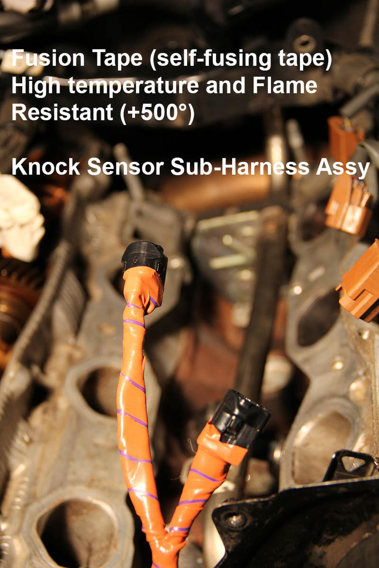

Example of High Temp Fusion Tape on Knock Sensor Harness
When I changed out my KS sub harness assembly, I noticed how brittle the wires and the connector were. They literally broke off due to beig subjected to the heat all the time.
I added the High Temperature fusion tape at the connector and worked my way back ensuring I had at least 50% overlap. Good stuff!
i actually did my entire wiring harness like that. I'll post in my build thread some day.
