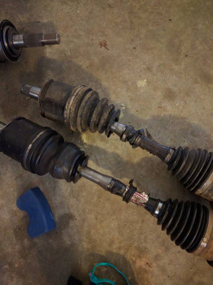

This issue is driving me nuts. Got my passenger side cv rebooted with oem boot kit before heading out to the trail this weekend. I did the boot stretch mod and left the old inner cv boot inside the cv groove to act as a stopper for the new boot. The boots held up fine all week on road and the ribs werent rubbing at all.
I take it off road and at the end of the day, i see the boot has ripped near the end (skinny part) of the inner boot.
Any suggestions? This isnt something i want to do every time i go offroading.

Honestly, I gave up on the after market boots and the boot stretch. I now have two sets of OEM axles that I'll just rotate out as the boots tear. I have the OEM kits on my shelf and will just reboot and replace. I'm hoping to get 10,000 miles out of each installation. I also lowered the front and sprayed the inside boots with dry lube. Not sure what else there is we can do.

Ugh. So frustrating. My boots have failed the same way twice after the boot stretch mod
Have performed the same stretch on my driver's side with no issues after several miles, however.

There's got to be a better mouse trap. All that's needed is something to keep the grease inside the tulip and the ability to flex with the axle. Yours tore completely off. Has nothing to do with rubbing. The OEM boots are quality.
Yeah it looks like there is a sweet spot with the "stretching"
Too much & you've exceeding the length this boot was intended to go
Too little & now your ribs are rubbing, The whole reason the boots ripped to begin with when the angle of your lift now causes your CV boot ribs to make contact with each other
Maybe no stretching with "O" rings where the ripping of the boot Is occurring to prevent the rubbing from Happening at all is the solution??????

Just ripped my drivers and passenger side boots. I've got a Toytec lift and it seems that the Toyota OEM CV boots really don't like being stretched. They both have ripped in roughly the same way (on the skinny end) and roughly at the same time.
Seeing how much longer the allpro (and possibly cvj) boots are I'll wager that putting them on correctly should last significantly longer than the Toyota ones. Its my personal opinion that one shouldn't remove the half shaft tulip out of the differential to swap cv axles. Just pop the clamp off and pull the shaft out, that way you're not dealing with gear oil or possibly ruining the seals. Popping the axle out of the differential is a pain and there's really no huge benefit to doing so. I think its fairly easy to load up the tulip with grease, some in the boot and just clamp it down.
Anyways this is my 3/4 CV boot rip and I'm tired of it. Swapping out boots every 2 oil changes isn't acceptable so I'll give the allpro / cvj boots a try.
