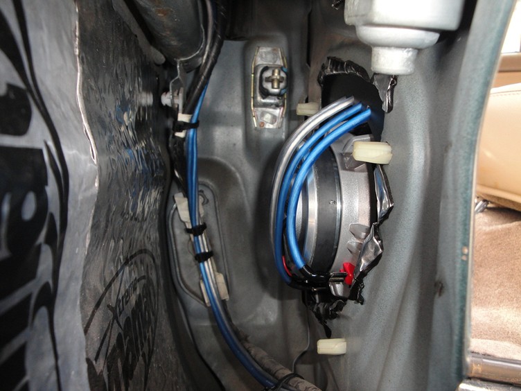

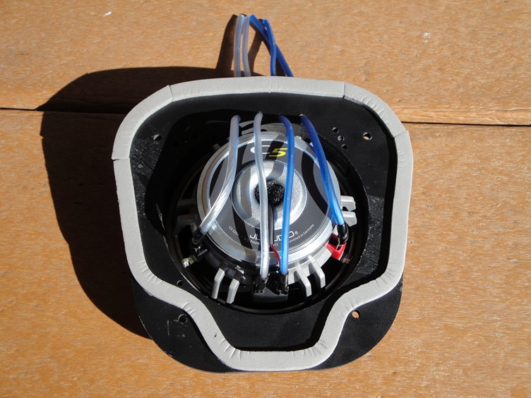

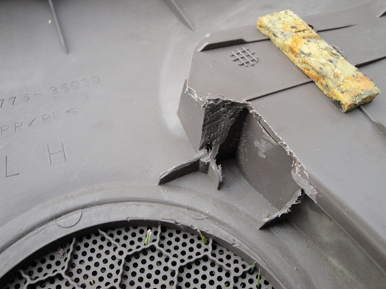

Don't go any larger than 5.25" in the rear unless you want to do some serious fabrication work. Here are pictures of my JL C5s in custom brackets. I used one adapter plate and three spacer rings to clear the window when it's rolled down. Then I had to trim both the spacer rings and the inside of the door pocket to make it fit. You can find adapter plates all over the internet for just about every car imaginable...except a 3rd Gen 4Runner. The stock adapters would not accomodate the basket on the rear of my JLs, so I had to build these. Luckily I found a store on eBay for these 4 brackets and glued them all together with PVC glue. Perhaps if you purchased shallow mount speakers you could get away without the spacer rings.
Good luck with your install. And I second the previous motion that an amplifier will also do wonders for your tunes.
