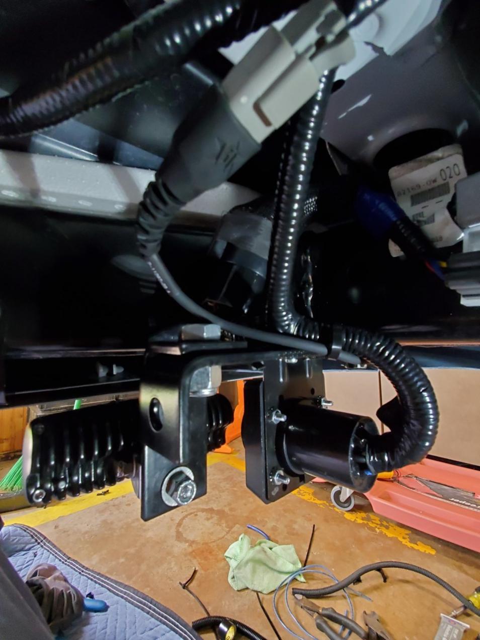

Rigid makes a diffused light kit- tap the hitch for power, turn on with shift to reverse, add a relay to dash switch and it doubles as tailgater repellent

Rainy nights are another good thing about these. Backup camera is useless on a rainy or snowing night. These lights let you use side and rearview mirrors to see what's going on. Also in my rear camera, even soaking wet I can see a spot where I always stop the rig in the garage. I hate guessing and have to move it!
What did you attach those reverse lights to?
Long L bracket from Menards. Thick gauge bolted to the 4runner frame bolt. Hitch has 12vt power source a black wire and the reverse trigger is yellow
