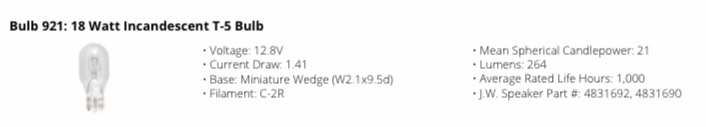

[MENTION=200736]ElectroBoy[/MENTION] thanks...how much improvement did you see with the vleds?
Stock incandescent 921 bulb is about 264 lumens.
VLEDS 921 @ 850 lumens. So 4x?
Here’s a good resource:
https://www.jwspeaker.com/content/uploads/halogen-and-led-bulb-spec-sheet-2016.pdf
The VLEDS website actually lists a warning to operate them no more than 10 minutes.
You may just want to go for the LASFITs instead of VLEDS. You have a 45 day money back guarantee period to try them out.
