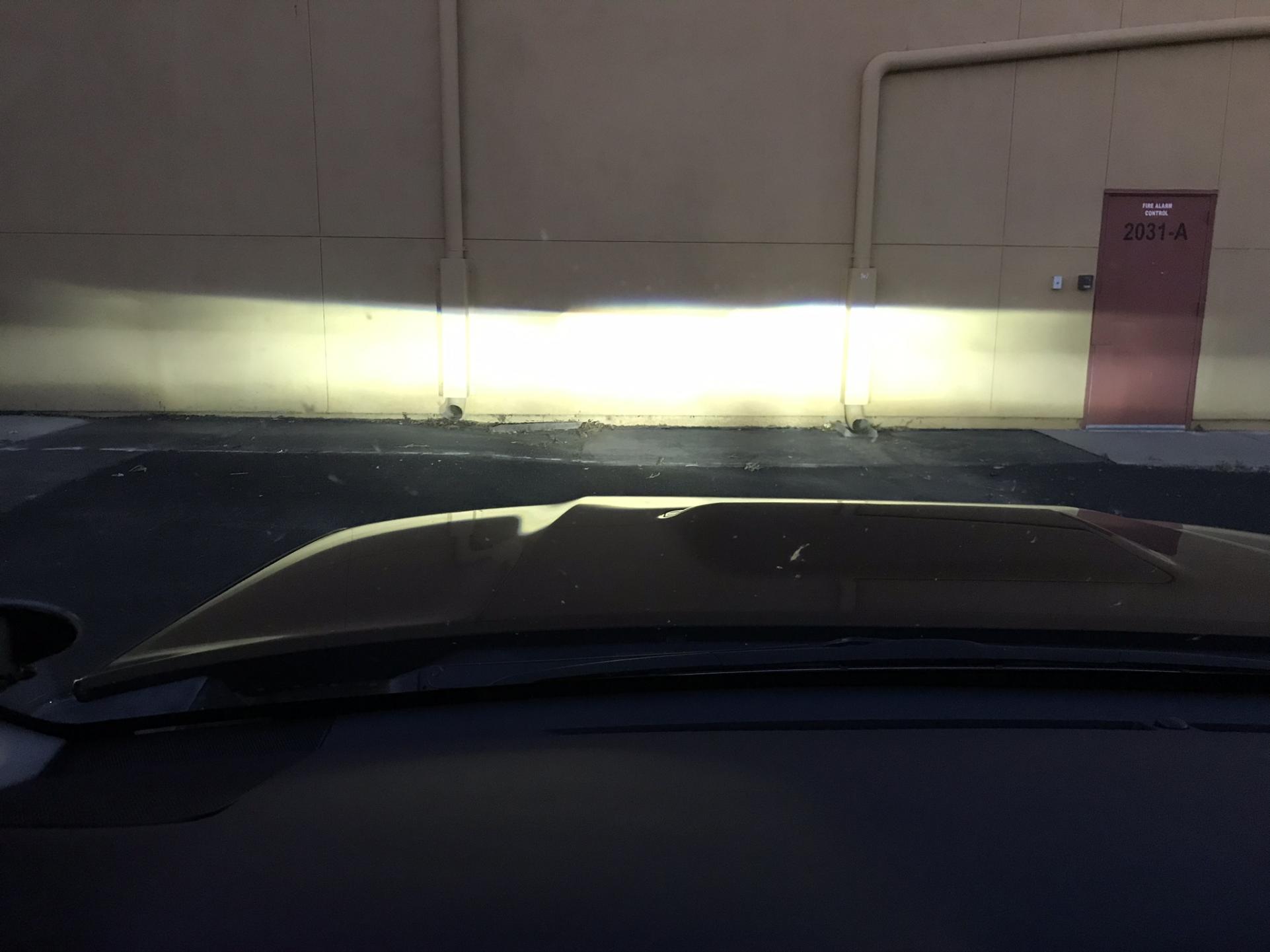

It seems as though someone really took their time making sure these projectors were perfectly aligned. Mine were level right out of the box. The steps are the same distance apart as my headlights are away from a wall and the cutoffs are even horizontally. That was what I was having nightmares about before installing and seeing a perfectly horizontal and crisp cutoff afterwards was a huge relief.
I read a few complaints about the cutoffs being crooked on some ford forums but the production numbers for those are probably way more.
Yeah your cut off lines look really good compared to mine. Mine aren’t that straight horizontally.
Here is what I got a few days ago. These are with OEM fogs. As you can see its not as straight as yours. Had to go back and lower the height yesterday.

Hmm. You have the original halogens in there?
I found that the area the bulbs sit in were finicky. Had to mess around with the bulb orientation until they "set". Its like a tight glove.
I have the Innovited 5000K Pure White HIDs. Not sure why the color looks like 3000K in that pic. It was taken at dusk.
I double checked the orientation on both H7’s and made sure they were level and locked in tight before mounting the assemblies. Maybe I got a flawed set?

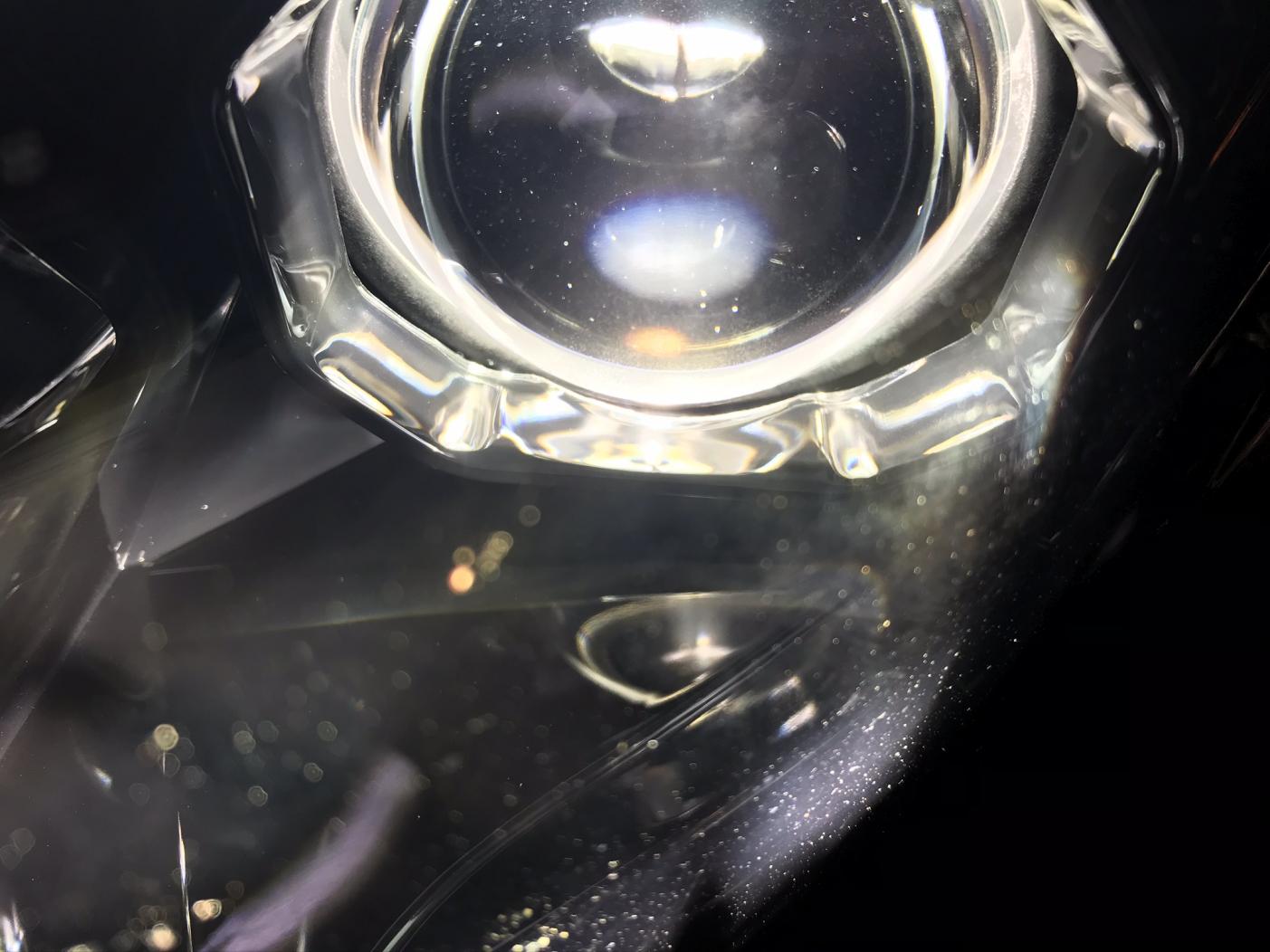

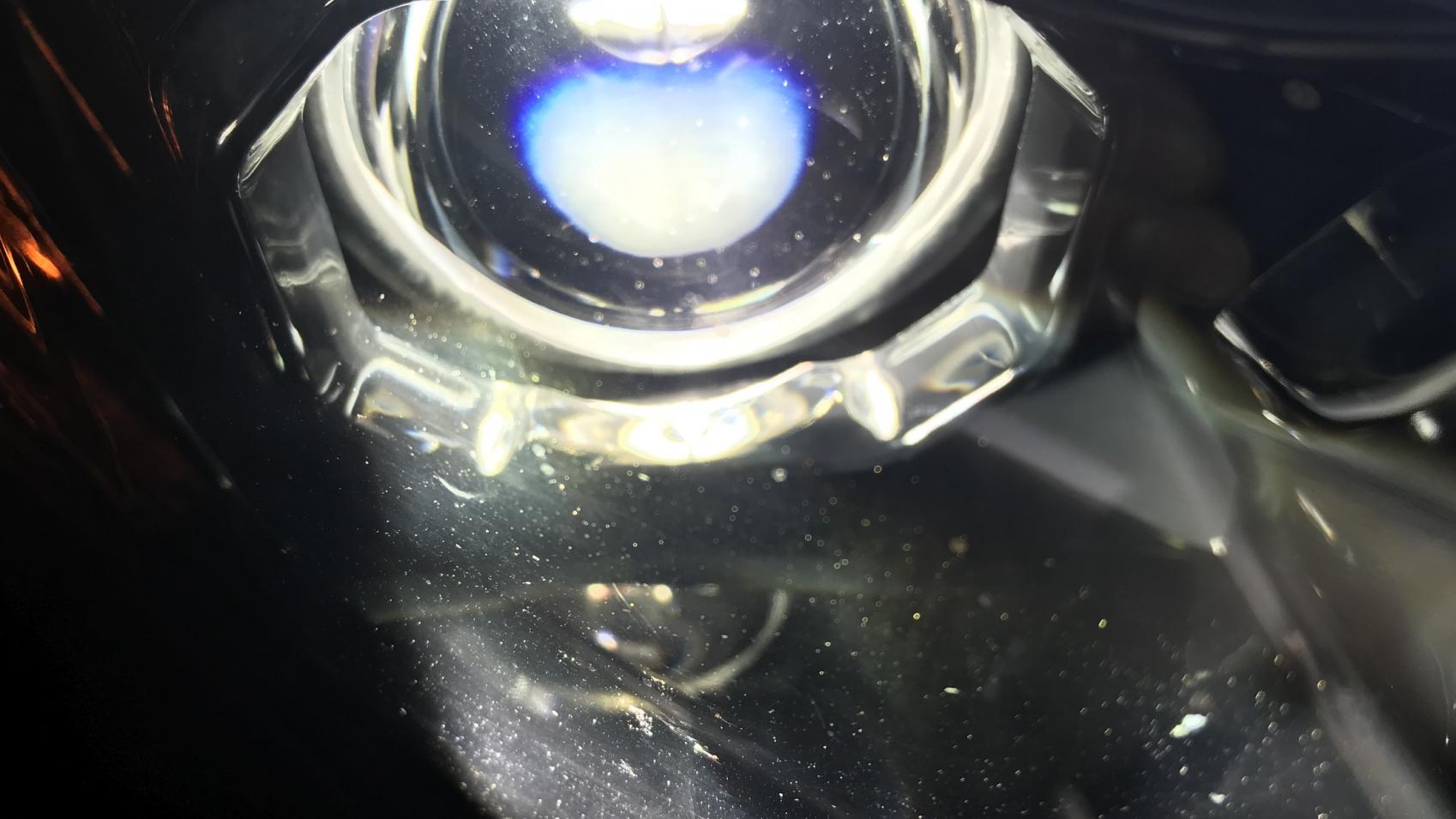

By any chance can check how both your projector lens sit in the housings?
On mine, I noticed there is a gap difference between the housings and low beam projectors. The drivers side sits a little further back than the passenger side.
So I removed my headlights to see how I insert them in because I wanted to make sure the "rod" was facing down on the bulb.
Turns out they weren't. I was at about a 10 o clock position with the tab and the rod was at 4.
I fixed it so I was at 12 o clock and the rod was now at 6 o clock.
Remounted the lights and now my passenger side had a wacky beam pattern!
I messed around with it a bit and 10 o clock gave me the best pattern on the passenger's side and 12 o clock on the driver's side.
I guess these cheap Amazon HID bulbs may not be on a perfect plane so you have to pick the right spot for them.
I would try to reclock before you return.
