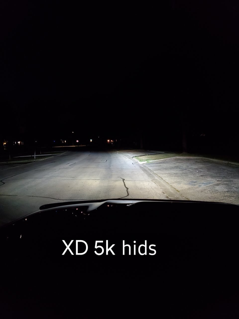

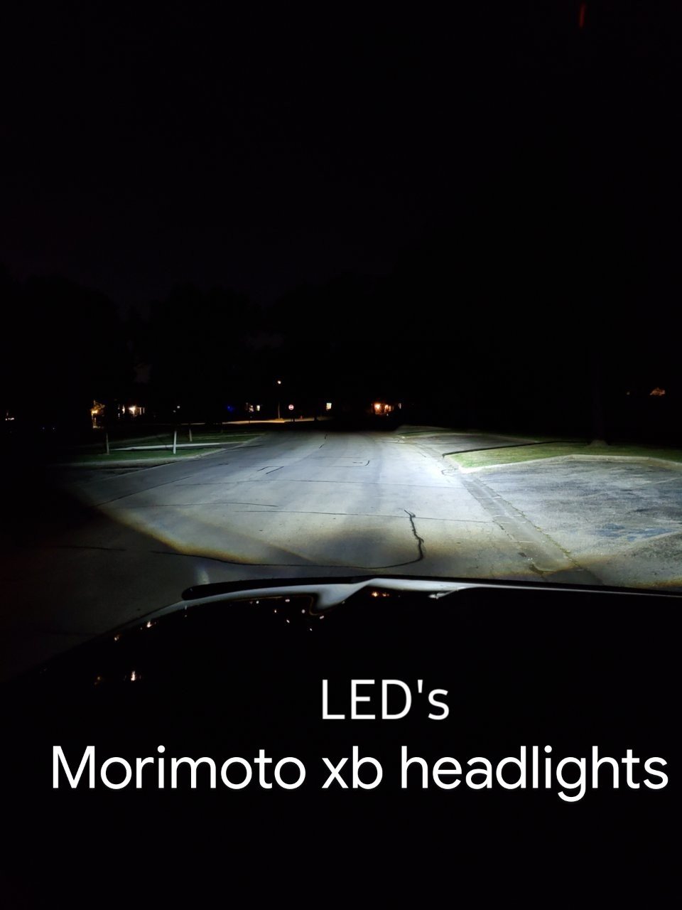

It's hard for me to tell on mobile. The XBs have a dead zero light zone up front and to the sides and looks similar to your pics. Is their useable light or do you need the fogs to see in that area? Thanks
Found my old example, hid vs XB showing the dead zone. These pics taken in the exact same spot camera front center of the steering wheel. Use the cracks in the road as reference, can't see some in the xb dark zone
There's more useable light than with the stock headlights.
