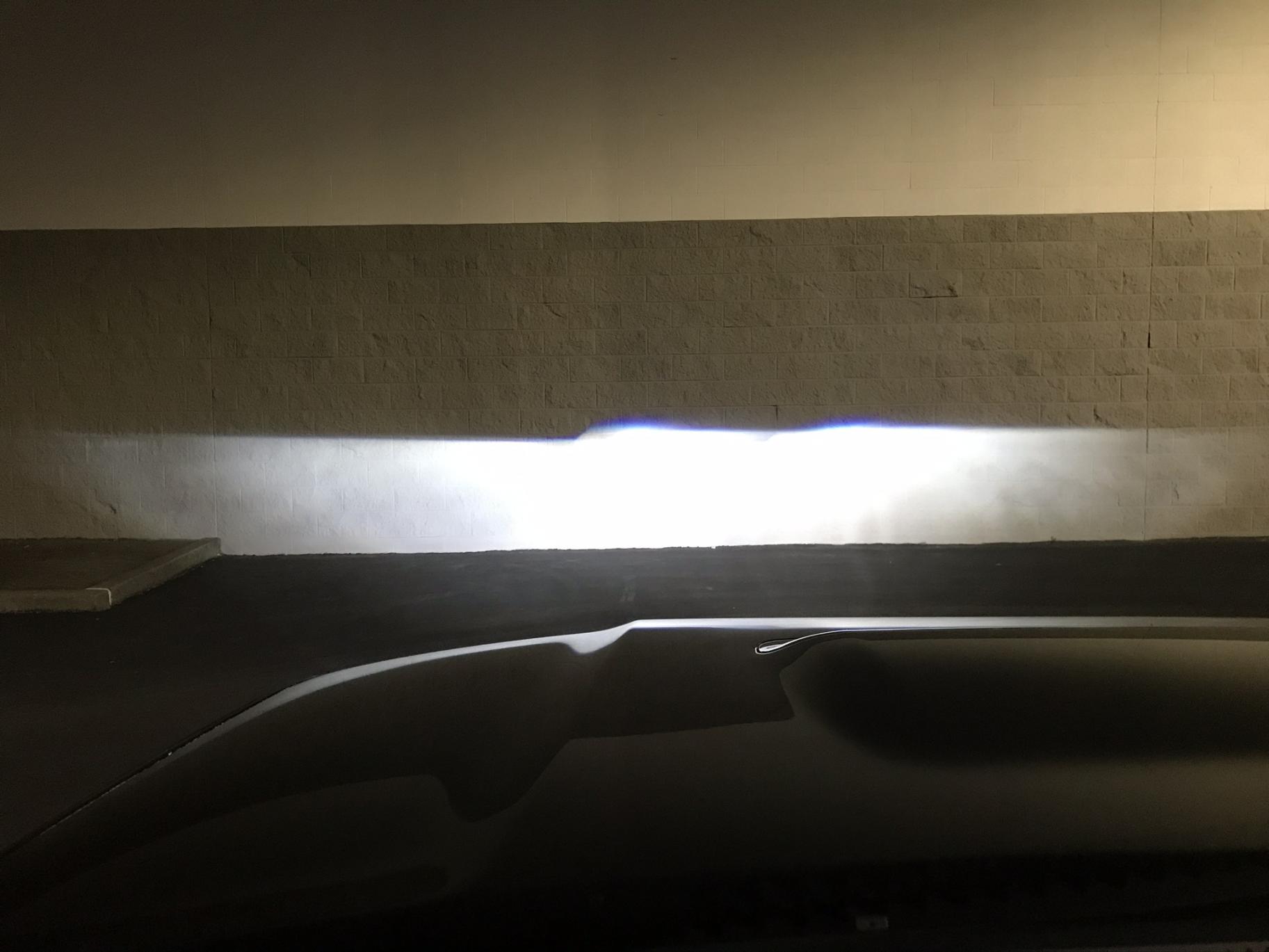

So after trying different clocking orientations here is the best cut off line I could get (LED fog lights are disconnected). Also, I did swap out the the Innovited 55W 5000K HID I originally installed to the Innovited 35W 6000K HIDs. With these, here is I how clocked them, tab @ 3o’clock and rod at 9o’clock on both driver and passenger low beam projectors. Cut off line is not as clean as yours, but I guess I can live with it. The wall and pavement I’m parked at is not level, so the wall’s line does look slanted.
Yeah that looks way better. I'd be happy with that cutoff. I'm going to swap my 55 watt out to 35 too. I was reading and they say 55 watt only lasts 1000 hours and 35 last 3000. This will be the sixth time i remove the bumper. Pro bumper removal status.
Yeah the same reason I went to 35W also. I think I’m around that sixth number also. I just hope I don’t reach Legendary status. Even gave me a reason to buy a Milwaukee cordless 3/8 ratchet just for the job.
