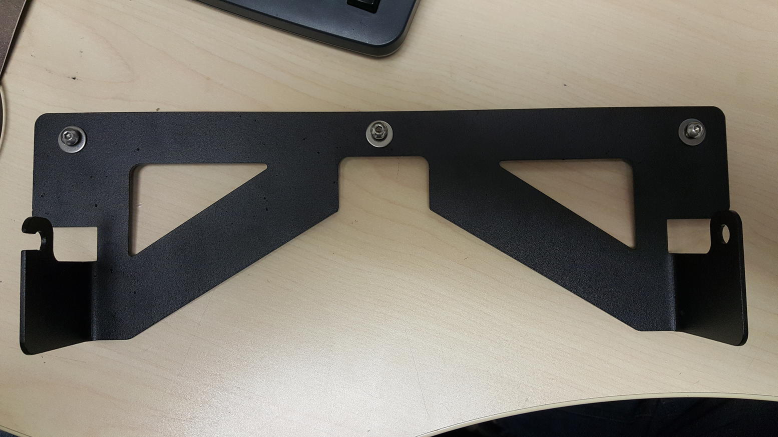

RIGID Hyper Spots bolted to CBI hood mounts
I forgot to mention this, but during the install of the lights, I popped the vented plastic cover off that runs along the entire top of the engine bay (sits below the wipers) and that is where i ran the wires for the lights. The wires are very well hidden in that little spot.
Looks awesome. How bad is the hood glare with those lights? Cause I have 100w Hella 500s driving pattern and I get some hella bright hood glare (pun intended lol:D)
Thank you, appreciate the compliment.
The only thing I can say about the brackets is when you install them have someone ready to catch your hood. When i loosened the two bolts on the passenger side my hood came crashing down. It took everything i had to hold that hood up. Pinched my fingers/hand etc... it really sucked. And my hand still hurts. So i jammed a piece of 1x1 that was 8 feet long under the hood and to the floor to hold the hood up. Installing these is really a two man job, Can be done by yourself, but i don't recommend it.

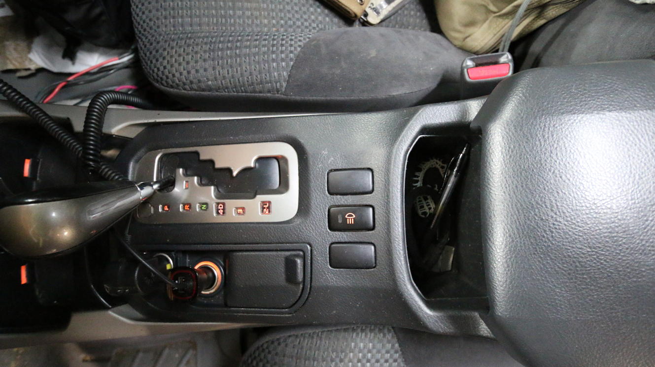

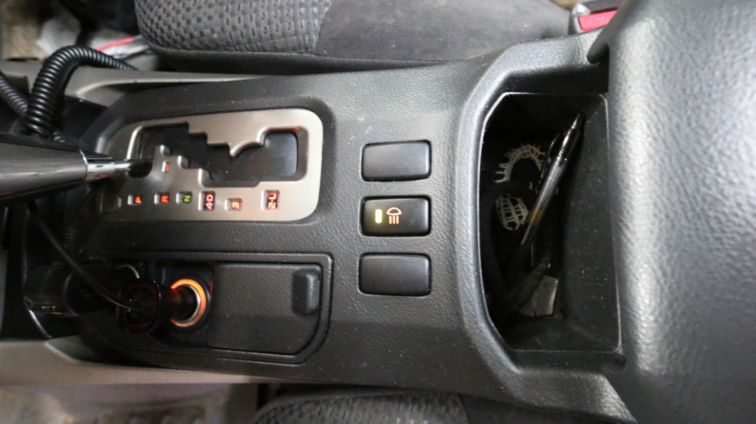

I put the switch in the middle of the console.

This is the chunk of wire that gets cut out of the FJ switch. It is a relay and as long as it is used in line the lighted switch will not work properly. I mentioned this earlier in the thread. Just wanted to share.
