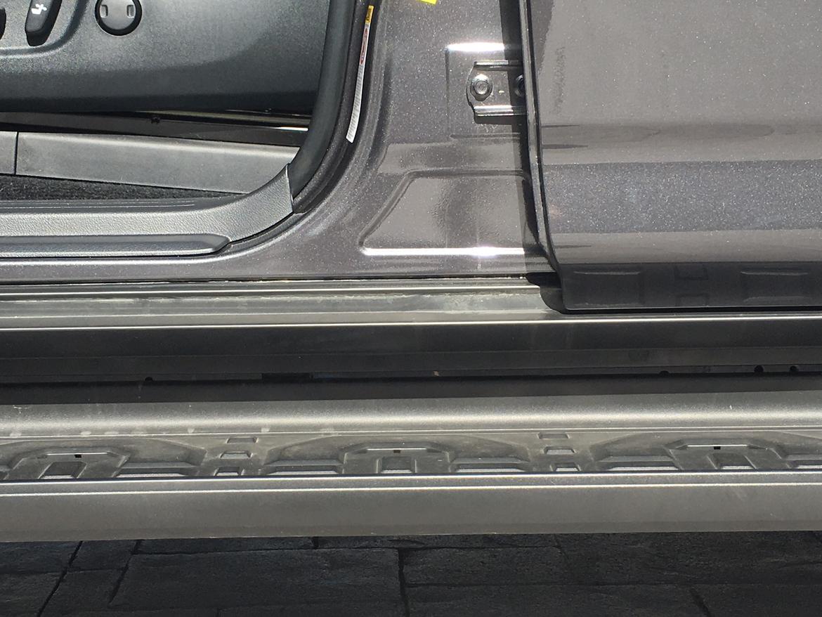

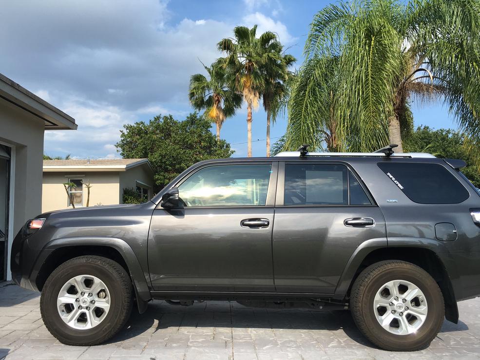

Phil, I have these and I don't think they will with 2010 SR5 rocker trim. IIRC it is the reason why it is only a port accessory for the 2014-2016 SR5 and trail and not the limited. You could do some trimming or see if someone is putting their trim up on the classifieds.
Below is a pic, and as you can see they sit pretty tight up against my 2015 SR5 trim piece.
They are a nice option, very practical and look good, especially for mostly on road or light off-road/trail driving, but probably not worth the conversion hassle.
My.02
Hopefully I'm wrong and someone can rebuke my response so it works out for you.

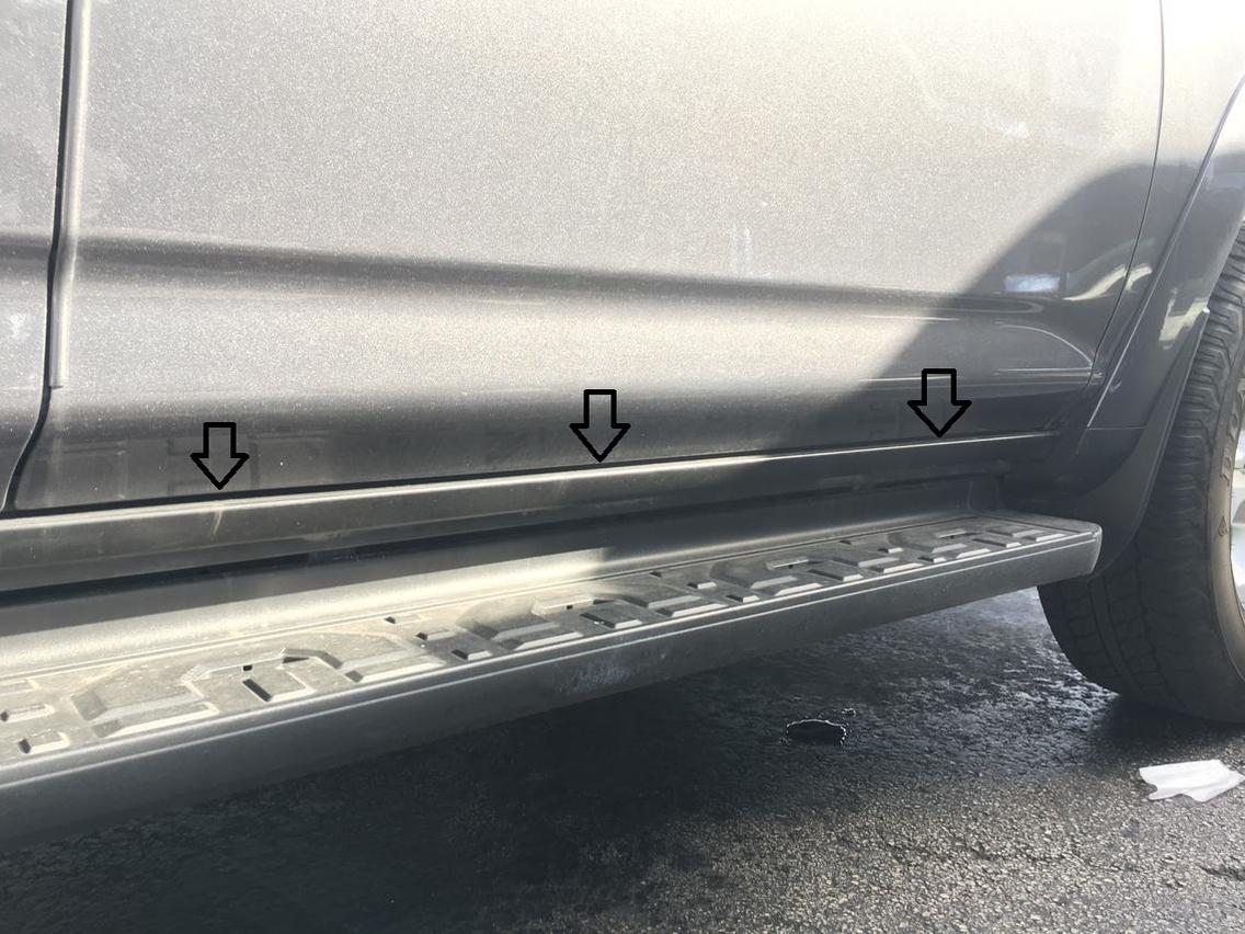

So, is this ...
... the trim piece you speak of, or is it below this? If that's it, it looks to be a PITA, plus unsightly if missing.

So, is this ...

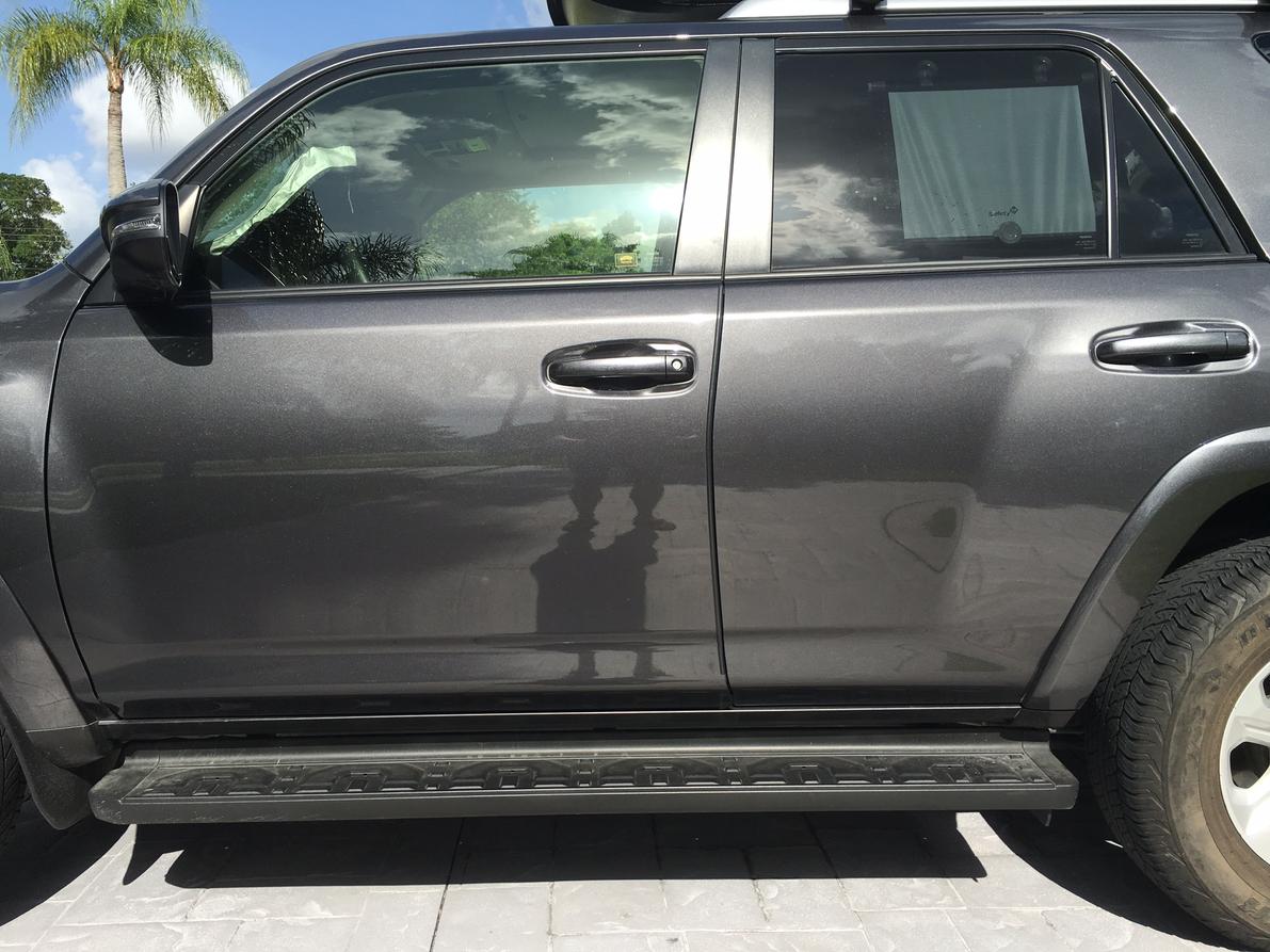

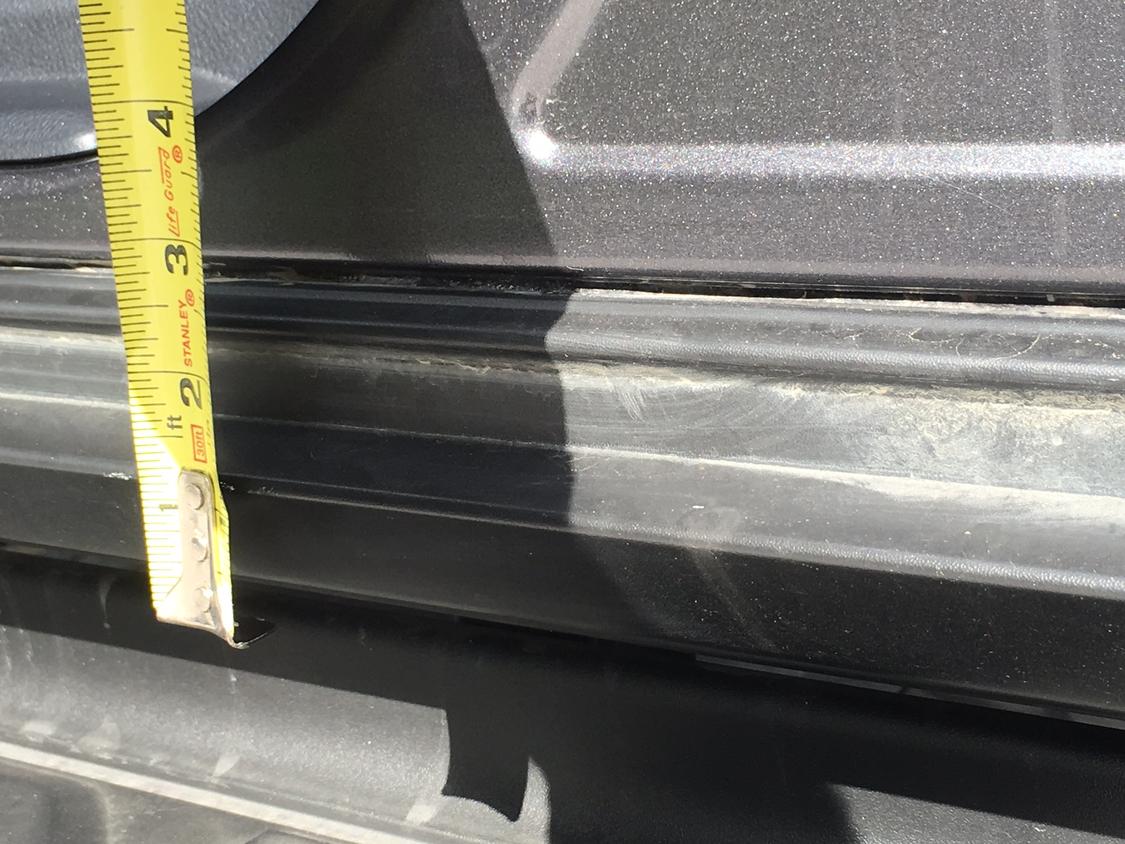

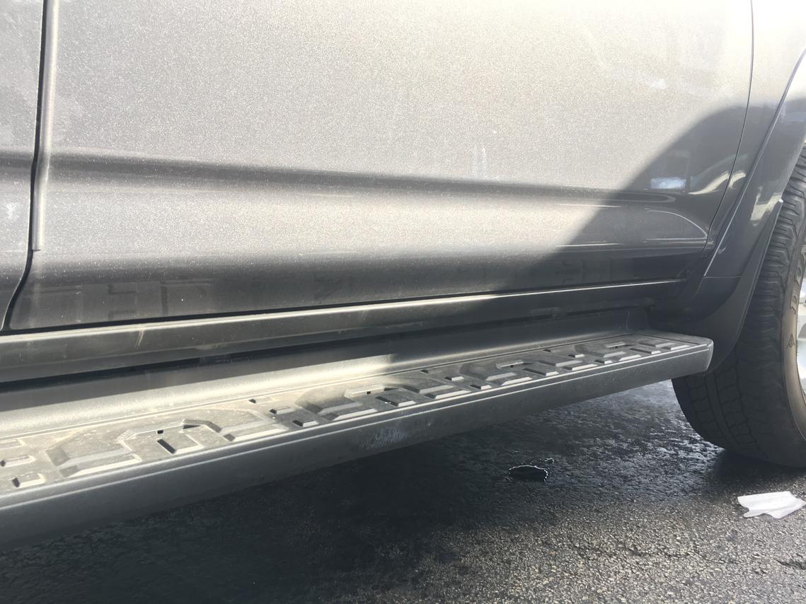

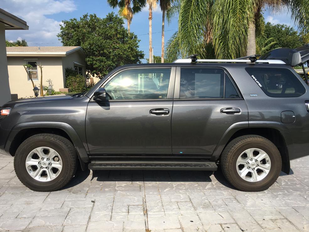

Yes, that is the piece. I took a picture off of the web and then took a couple shots of mine. With the doors open I think you can see the difference a little better (hopefully). The rocker trim piece on mine is about 3 inches total, top to bottom, if you want to measure and compare directly to yours. The brackets on the running boards align and have it sit almost flush against the bottom of the rocker trim (maybe 1/4" gap) so there is not much wiggle room if your rocker is thicker.
The last two pics are with the running boards on and off, again I think it helps to see the trim differences.
This is a reason why when people with a limited or 2010-2013 SR5 model order shrockworks sliders they offer a "trail" rocker trim piece to replace the original.

Just for clarification, the PT938-89100 part # is for the running boards that were made for the '10-'13 trail. The new KH option shown in Cymon's pics is not what you'd get with the PT938-89100 part #. They do work/look great on the '14-'16 though. Put 'em on mine and have been very happy, wasn't ready for sliders yet. I think at least to me they sit a little tighter/slimmer than the KH rigid running board. As others have said, would need to replace the SR5 trim with the Trail trim for 'em to fit though.
