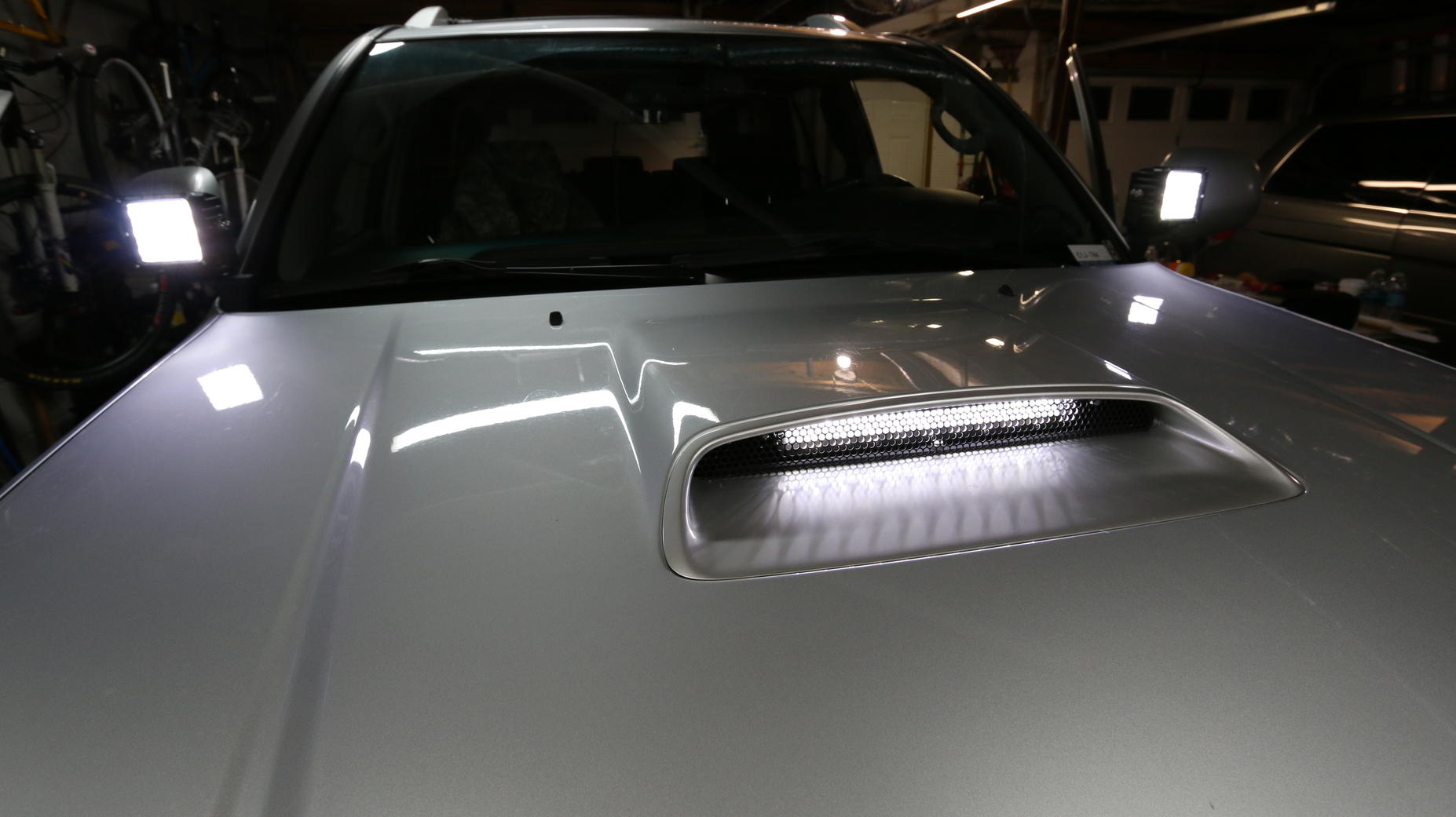

I'm currently attempting to install mine.
Is the method of installing from Rigid extremely frustrating? What am I missing? The "compression spacer" allows the supplied bolt to spin while attempting to tighten the bolt…
How is anyone suppose to install the brackets into these lights?
My SR2 arrived today and I have the same issue. One end will tighten up with no problem. The other end just spins. Apparently there is a design flaw because one end of the casting will keep the bolt from spinning, whereas the other will not. I'll figure out how to fix it later when I have more time.
Yup, thats the issue I had and it was on both ends. But ended up getting it on just fine. Good luck!
