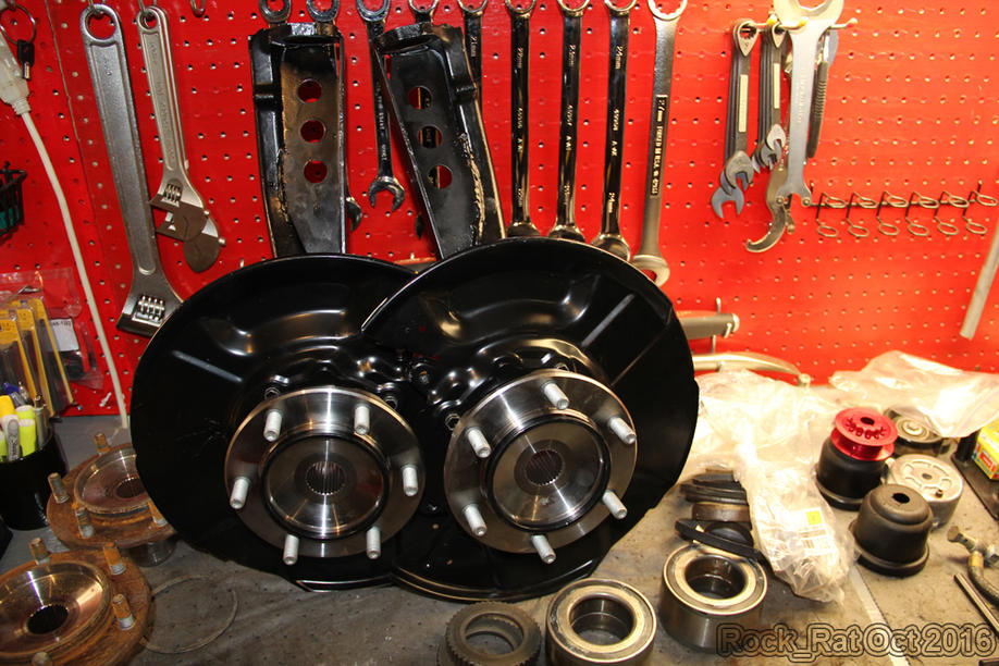

Amazing I know...I actually just finished up one of my main projects. Spindles with the new Total Chaos gussets are finally all back together. They go back together nicely with new shiny parts and a 20 ton press.
I'm down to my LCA bushings (which I'm hesitating on because of the whiteline bushings I have sitting in my freezer and the problem Alex had with them) and the SC which I'm still undecided on whether to get a larger fuel pump and bigger fuel injectors ($500 plus - ouch) with the 2.2 pulley.
So pretty! Dont forget me on the old spindles/welding etc...I'm in. I'll do that with the LCA bushings next spring.

What was the problem with the LCA and whiteline bushings? I installed the whitelines about a year ago and aside from a lot of unbolting don't recall running into any issues.
Spindles look great man!

Alex installed whitelines and after about four or five months he said they started squeaking on him. I'm more than likely going to install them anyway but I keep going back and forth on them or OEM.
