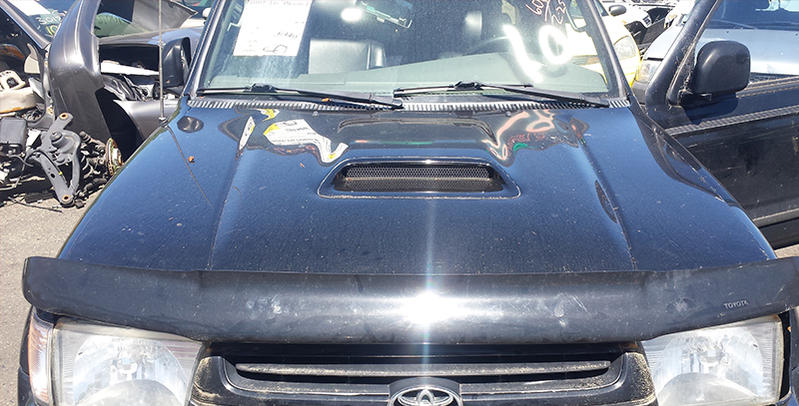

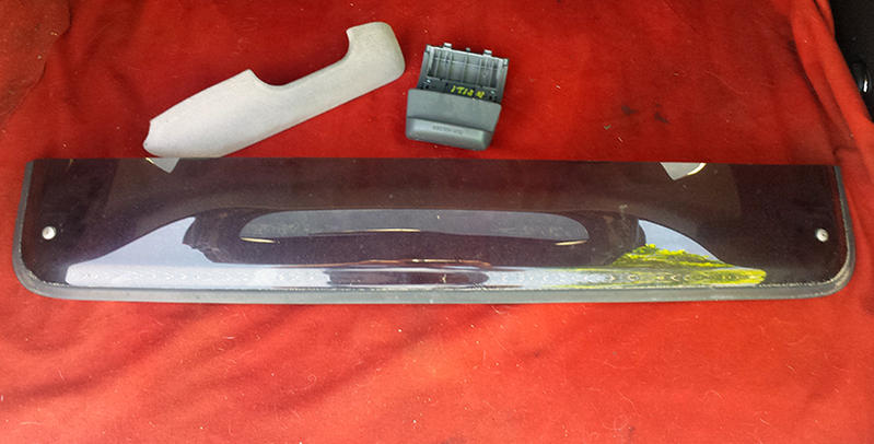

So...this Black 01 pops up on CL in one of our local junk yards. Tally ho, I immediately lock onto the OEM Moon Roof wind Deflector/Visor! :banana:
If you look in my original pics you'll see I used to have one of these babies until the clips broke off and I lost it. :(
Again, patience has paid off. I also acquired a new arm rest for my very worn out drivers side and a new rear cup holder for my back seat after many years of abuse by the kids. $40 well spent.
What a great lunch break today!
If anyone is interested and willing to drive, the sport hood is in great shape. He's asking $300, but the problem with a hood is it has to be crated - $$$$$$$.

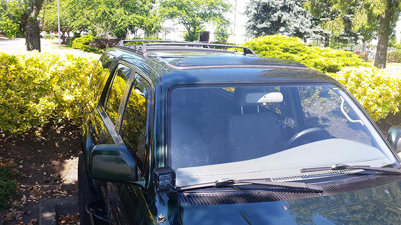

Installed my "New to Me" Deflector
Must admit, the wind deflector/sun visor looks much better on my rig than on the one it came off of in the junk yard. This will stay on until I build a full length roof rack.

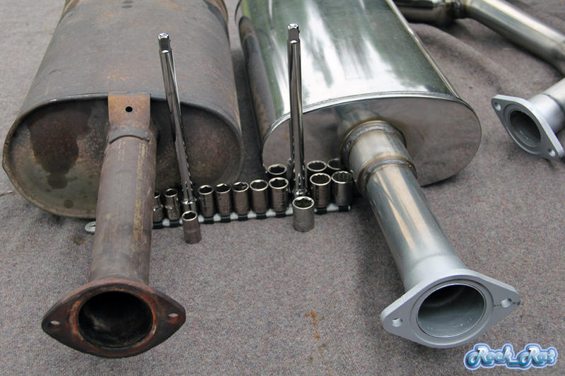

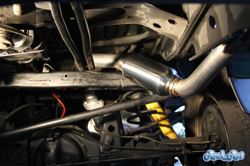

TRD Cat Back Installation
Finally had a little time today to install the TRD Catback exhaust system. For part number and cost, see my original link here
It looks much better on my 4Runner than in the box! Very basic removal/installation. Should only take about two hours.
Tools Needed
  • WD 40 or PB Blaster for the bolts attaching the muffler to the Catalytic converter.
  • Sawzawl.
  • Basic sockets, extension and ratchet or air tools .
Steps
  • Jack the right side of your vehicle
  • Loosen bolts securing muffler to Catalytic converter
  • Cut the tail pipe off
  • Work the muffler and tail pipe out of the rubber hangars

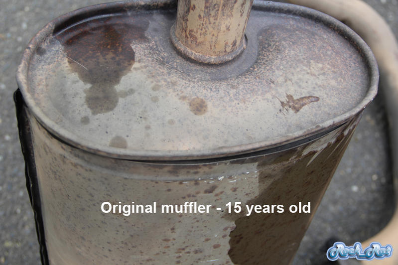

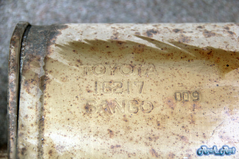

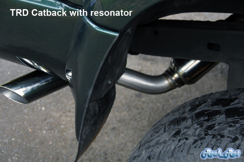

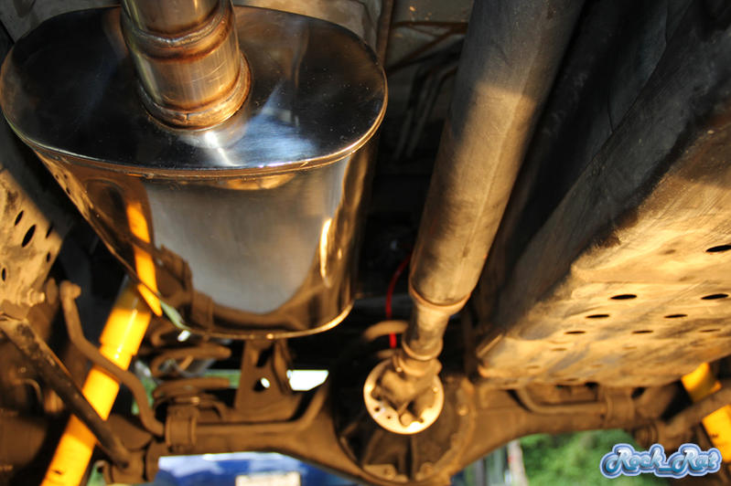

I'm liking the resonator and the stainless steel. Took it for a spin and it sounds great. Better than the original. The next step is the headers and the high flow cat. You can also see the new set of 4.88's in the back. Enjoy the pics...
EDIT: The first pic gives you an idea on the difference in the height. The 2nd and 3rd pics you can see where the original muffler was falling apart.

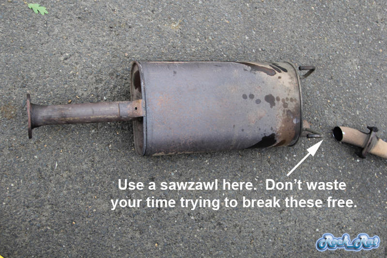

Here's where the sawzawl comes in handy. Using a diablo blade, cut your tail pipe off.

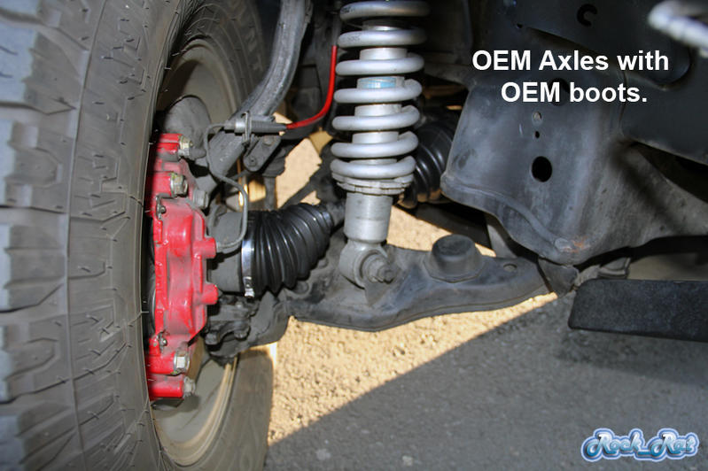

Axles with new OEM Boots
Here's a photo of the OEM axles I rebuilt using OEM boots instead of the aftermarket boots.
The fusion tape held up OK but the CV joint was dry. No lube anywhere. Needle bearings were OK along with the rest of the axle.
I'll rebuild my original axles using OEM boots so now I'll have a spare.

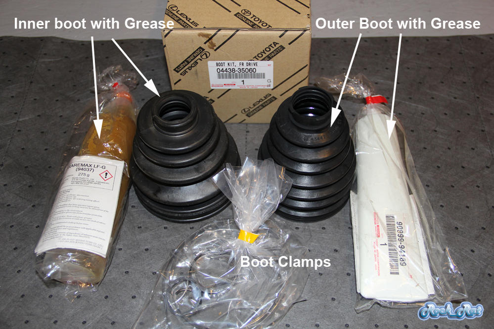

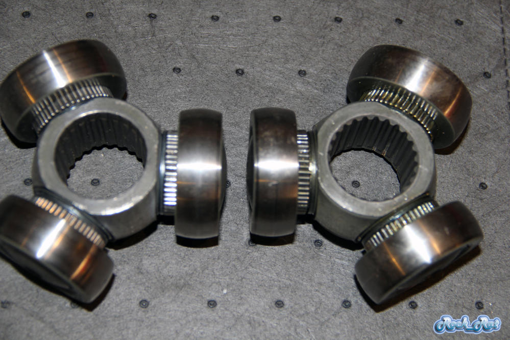

Inner CV joints
Here's a pretty up close picture of the needle bearings. I'll be cleaning these up really good before I put the boots on. They look good for having been driven round without any grease on them.
If you purchase an OEM boot kit it comes with everything you need. Be sure to use the correct grease for the inner and the outer CV joints.

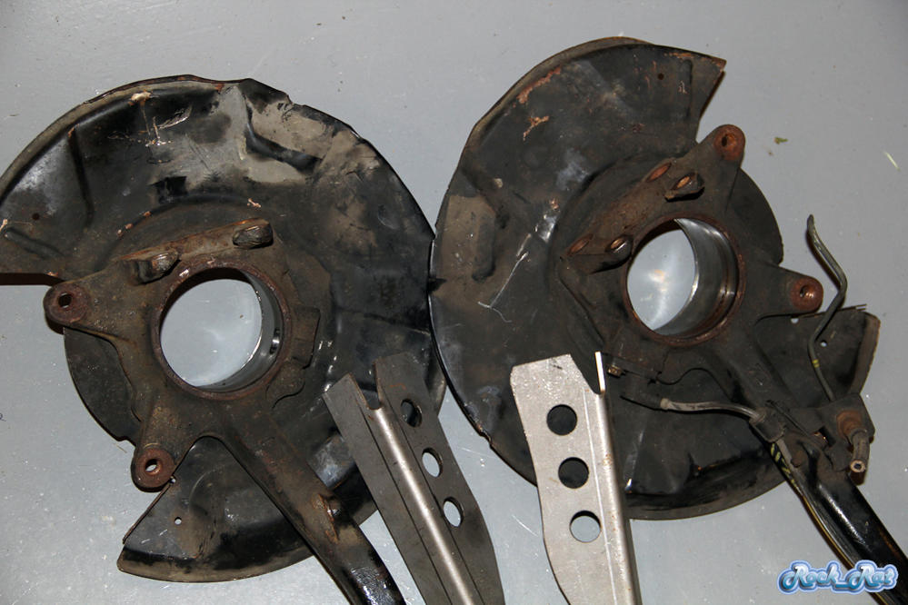

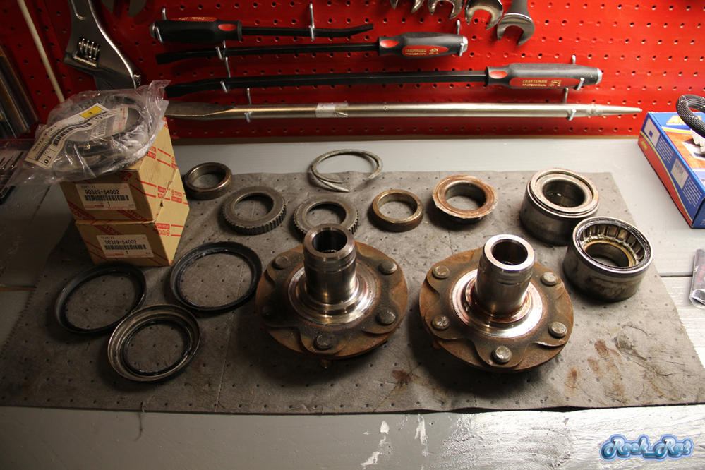

Pressed Bearings and hubs out of front spindles
Had some time to get the hubs and the bearings out of the front spindles. Getting another step closer to finishing up the entire front end. I'll remove the dust shields and then weld on the Total Chaos gussetts. Have them powder coated and then press everything back together.
The bearings felt great BTW but figured I might as well replace them since I'm getting ready to weld. They should be good for another 300K miles.

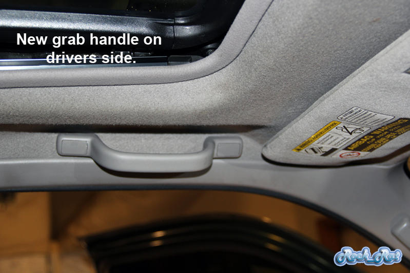

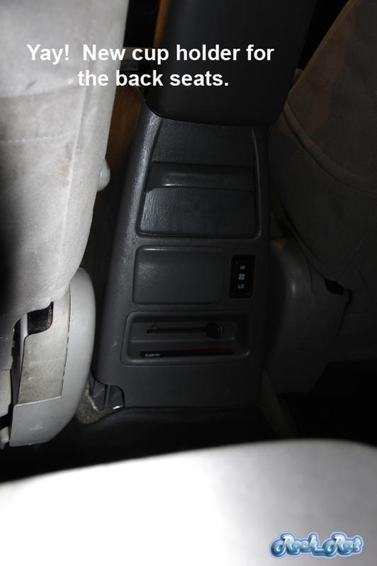

Installed New Cup Holder and Grab Handle Today
Finally found a replacement cup holder for my rear seats last week. It's been broken for quite some time after years of abuse with the kids. Decided to have fun this weekend and do some easy stuff.
Also scored the extra grab handle for the drivers side that for some reason, Toyota decided wasn't needed. Yet there's a place for it. Go figure.

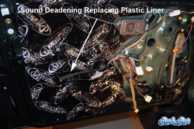

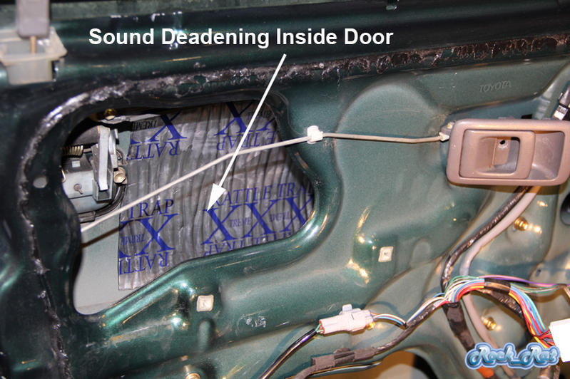

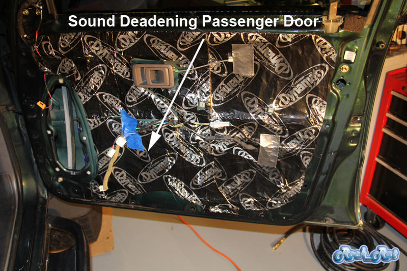

Sound Deadening on Doors Finally
Well, it's taken me a LOOOOONG time to finally get around to doing the doors, the front doors that is. I didn't plan on deadening the doors until I was ready to replace my speakers. That would allow me to just remove the interior panel once.
So it's time to install the new speakers (Alpine SPR-60C 6.5" Component System along with the Alpine Alpine PDXF6 since I'm not running a sub woofer) but first the deadening.
For a more in depth look at my sound deadening project go to this link.
Sound Deadening Project

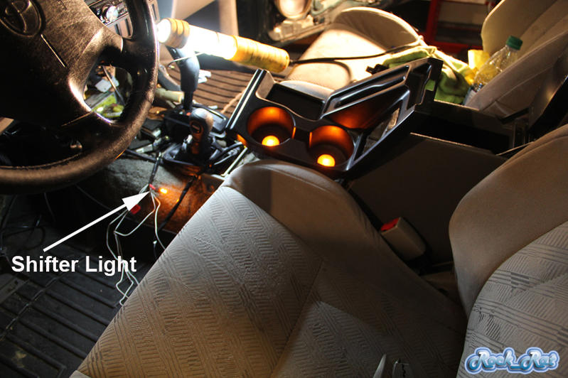

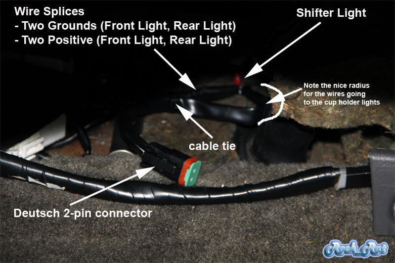

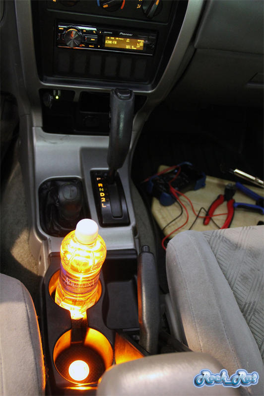

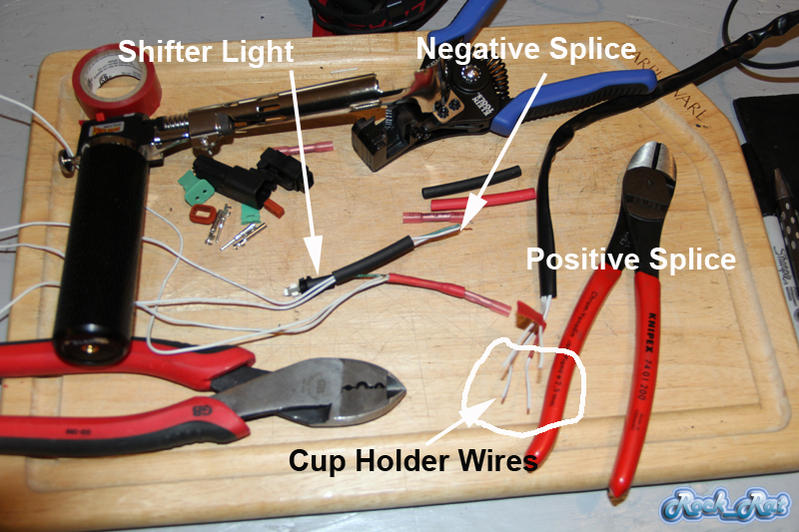

New Cup Holder Lights
I picked up these OPTX Marine Cup Holder Lights at West Marine. Here's a link to the product - LED Cup Holder Lights
I wanted to replace my existing cup holder lights as the LED world has opened up a whole new window of options compared to when the original cup mod came out.
My Requirements
  • Only powered on when the lights are on.
  • Must have a connector so I can remove and re-install the center console as needed. (cannot be hard-wired)
  • Must be able to clean the cup holders.
Source of Power
  • Splice into the Shifter light
  • It only comes on when the lights are turned on.
Connector
  • Deutsch 2-pin connector (black instead of grey - not weather proof)
How to Clean
  • Secure disks on the center console
  • Overlay discs with rubber cup holder. Requires cutting a circle out of the rubber.
For now, here are the pics. I'll come back and provide a little more detail on the installation.
Overall I love the way the cam out!!
I had a great weekend installing these. I was getting tired of working with CV joints, lower control arms, axles, differentials etc. I needed a break to just catch up on the fun stuff.
