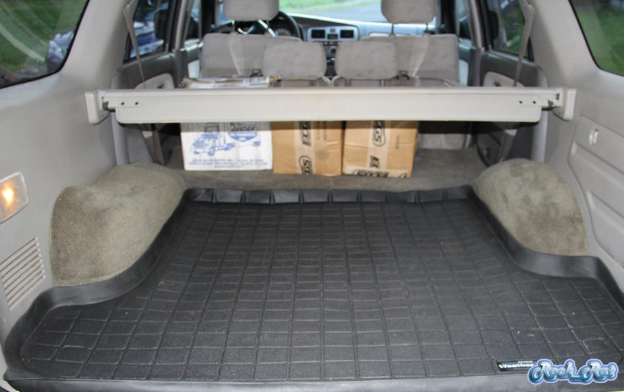

Well, nothing like having the work piling up on me with little down time. This past Saturday I came home to three boxes delivered from ECGS. Both the front and rear fully assembled 4.88 diffs arrived along with a box of Lucas oil.

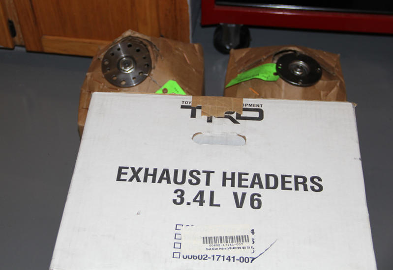

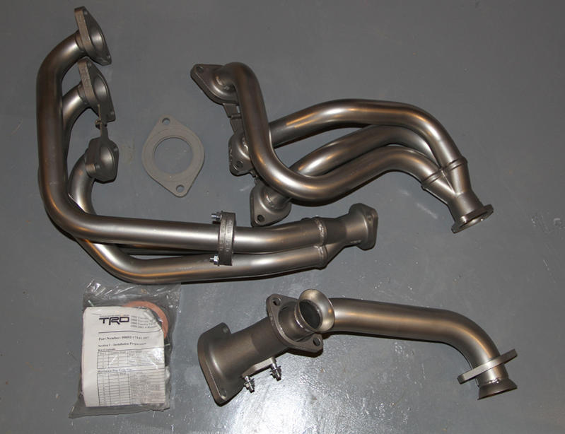

Today I came home to a nice box with TRD on the side of it. My headers arrived.
PN - 00602-17141-007 These fit the 1999-2001 4runner V6 - 2WD &4WD LEV spec only. Basically a dual cat. I'm pretty sure all domestic T4R's from 2001 up are FED/LEV. I'll edit if I'm wrong.
The good thing is the headers came with the improved bolts with the springs. I hope I'm not chasing exhaust leaks one they're installed. With the SC installed, I hope I can manage the heat in the engine bay. I have some concerns, but am happy to "open" the exhaust first on this motor before installing the SC.
Here's some pics for you.
I've also included all 12 pages of the instructions in PDF format.

Wow, those gears are going to be nice! Hope the install goes well..
Also those headers are just slick, can't wait to see them on there

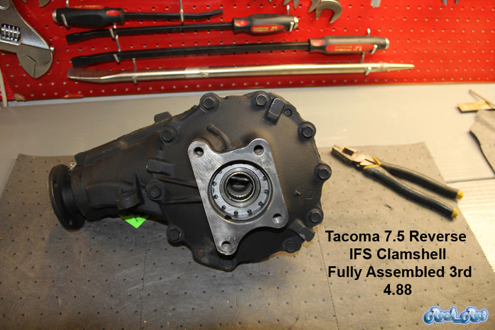

Installation of the 4.88 Gears
Don't look for a build on the 4.88's here. I'm too dang busy and lazy to do the installation myself. I'm having them installed over the weekend.

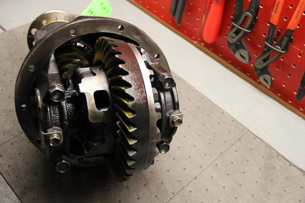

For what it's worth here's a breakdown on the diffs. These are fully assembled front and rear differentials with a gear ratio of 4.88:1. I decided to leave them open instead of adding the ARB locker.
Total Cost(with the core charge) - $1977
Subrtract the Core Charge - $300 + $250 ($550)
Total from ECGS - $1427
Gear Oil is Lucas - 85-140 High Performance Oil
Rear Diff
  • PN# - DIFF-BUILD-TV6 Link to ECGS Website for This Product HERE
  • Nitro 4.88 Ring and Pinion
  • All New Timken, or Koyo bearings
  • Solid Spacer Installed
Front Diff
  • PN# - DIFF-BUILD-T7.5CS Link to ECGS Website for This Product HERE
Here's a few photos of them on my bench as I examined them to ensure everything was OK. And off they went...

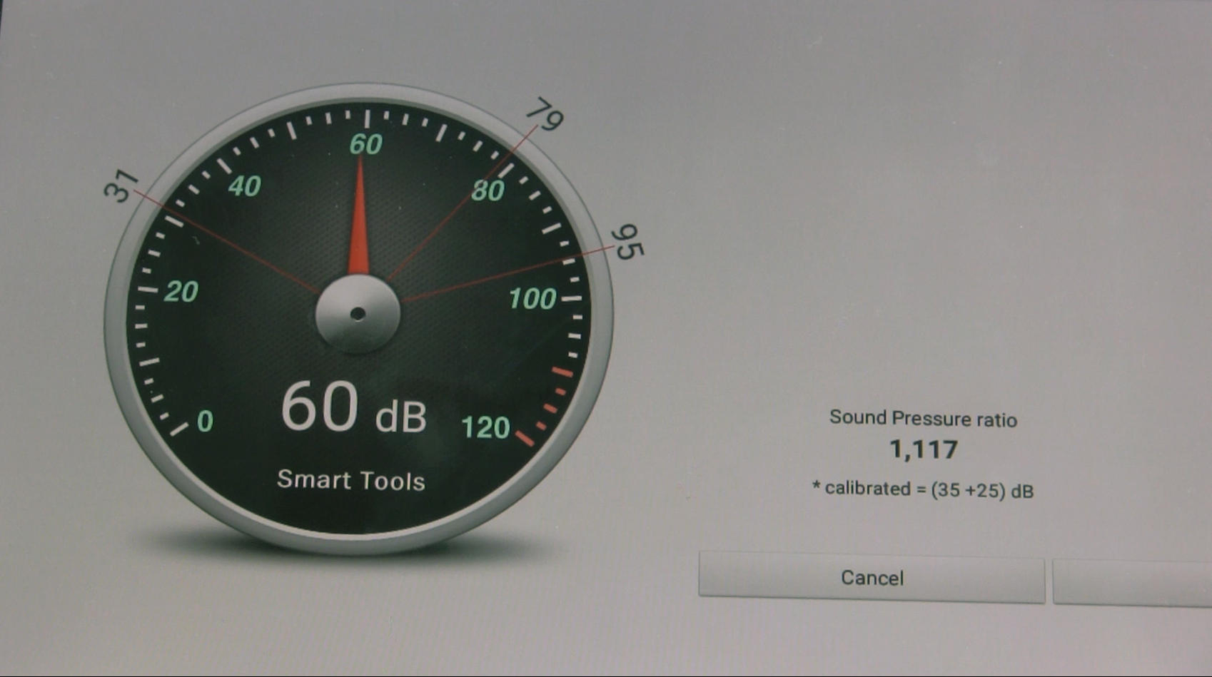

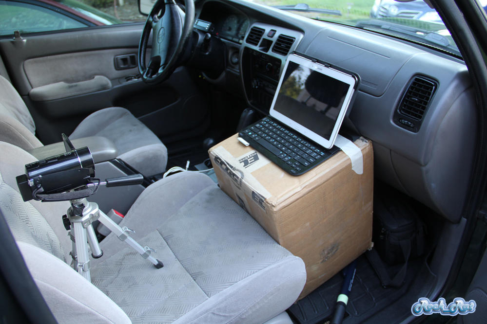

Began Doing Some Baseline Recording Today
Here's the basic setup.
  • Samsung Tablet
  • Sound Meter App by Smart Tools (Free Version)
  • Calibration - None (Added 25dB)
Video Camera - Canon HD CMOS Pro
Type of driving- Stretch of Highway on I-5 in Cowlitz County WA
Here's the screenshot. When I'm done with the video I'll add the link here.
My Vehicle
  • ISR
  • Deckplate
  • OEM gears 4.10
  • OEM exhaust
  • Sound Deadening

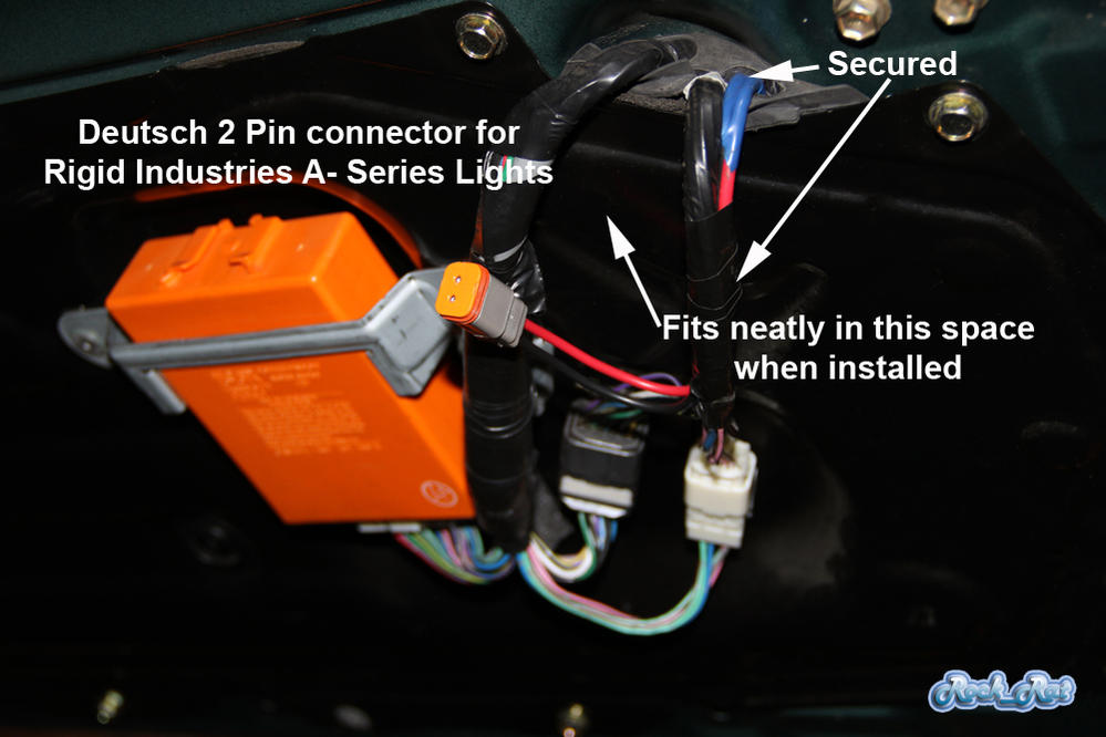

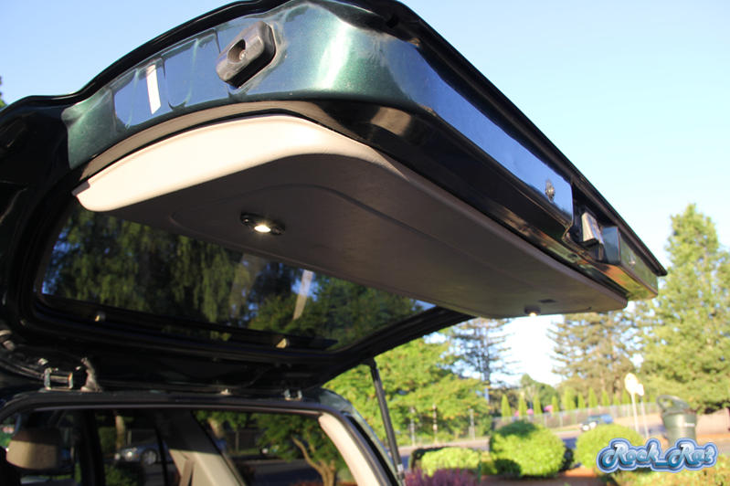

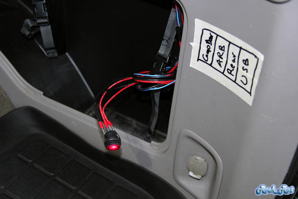

The following two photos are related to this post "Rigid Industries A-Series Lights in Cargo Door"
I used a Deutsch Dt Series 2 Pin Connector Kit with Solid Connectors
This allows me to SAFELY install the lights and wiring and still have the ability to remove the interior cargo door panel as needed.
My temporary switch for the lights is the one that came with the Rigid Industries Hyper Spots. Again, neatly tucked inside the storage compartment. Because they're wired in with the dome light switch, the cargo lights come on whenever the cargo door is raised. They turn off when the door is closed.
For some reason I can't seem to get my masking tape switches to work. I must have them wired wrong.
Actually I'm still deciding whether or not I want the switches exposed or neatly tucked away inside. Not sure what switches I want back there. Any ideas let me know. Definitely cargo lights and compressor, stove/and or table lamp, etc.....
