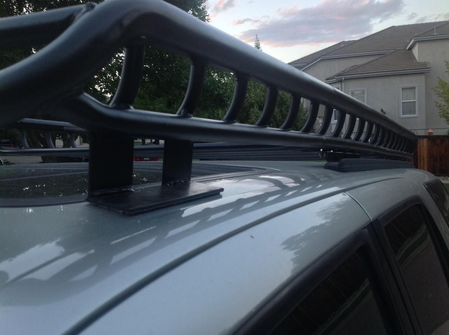

Is there any chance of you putting up a pic of the finished product?? Now I got the itch to bring the rack down a bit and .75 sounds good
Sure. Here is a close-up of the mount with the lower brackets as well as a shot of the front support bracket that I fabricated.

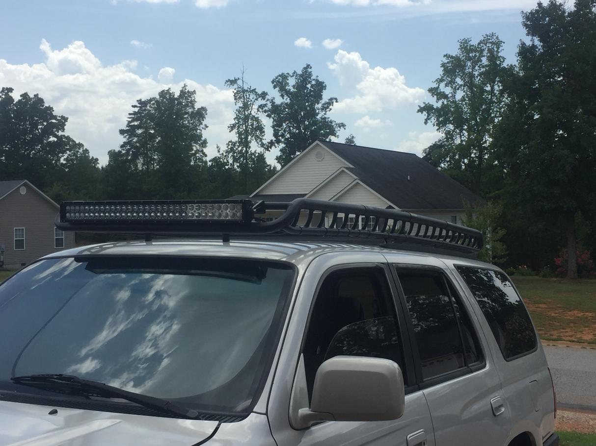

Here is my set up. Added 2 extentions w low homemade mounts. Strong as roof will allow. LOL. Used 2 rubber extentions as mounts for front. Also using curved light.
This is what I want to do, I'm worried about the max weight though. Rola says 150 LBS. I need to be able to put a couple hundred up there. I plan on welding L shaped angle iron like you did in the front all around the rack.

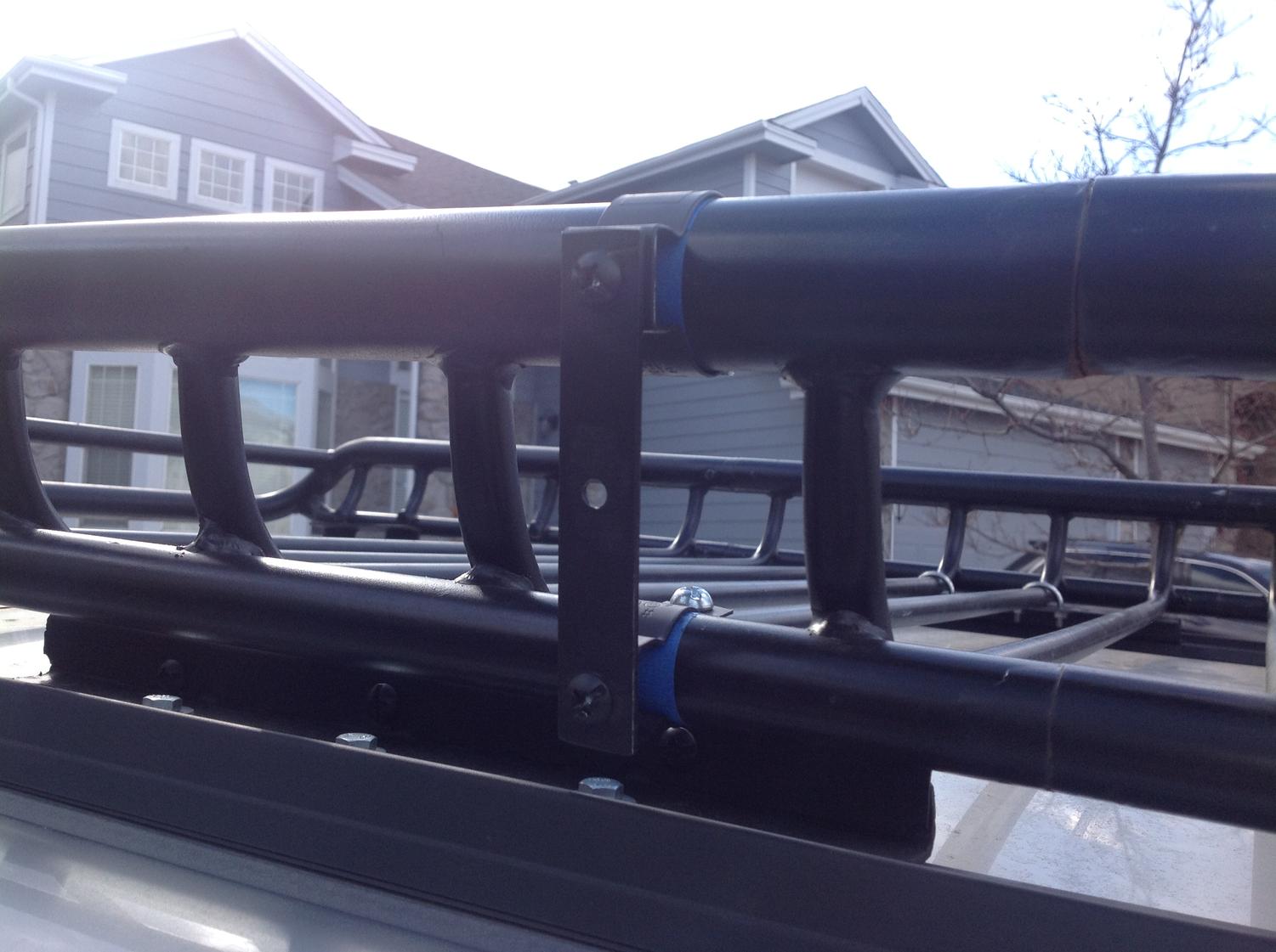

Attaching awning to Rola rack
I picked up an awning for my 3rd Gen, but struggled with how to mount it to the round bars on the Rola rack. After looking at over-priced aluminum mounts online, I watched an episode of MacGyver and then headed to Home Depot. I found that conduit hangers are perfect mounts for the Rola rack. I believe I used a #1 for the small lower tube, and a #2.5 for the upper tube. I then stretched 3/4" steel plate between the two and secured it with 1/2" screws. I made 5 mounts in total and ended up with the perfect flat surface to attach an awning.
