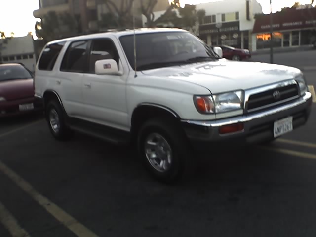

Starting... it was nothing special... a 1998 4Runner, V6, Auto, 2wd, white with an oak interior.

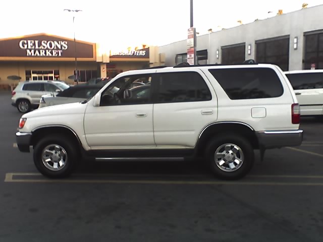

That picture was actually before body and paint - ended up shaving the drip rails and getting a fresh coat of paint and painted stripes (no decals) - the new colors are actually Toyota Super White and Anthracite stripes...

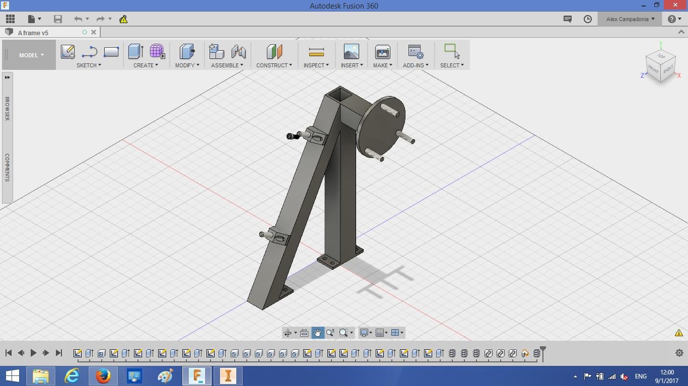

I want to keep the factory rear bumper but want to run a aux tank in the future... was thinking of making an internal spare tire mount - anyone done it?
Was playing with a CAD program and came up with something like this --- opinions?

[MENTION=63487]A.Wilson013[/MENTION] has something like this in his new GX470 I think.
Personally I wouldn't want the tire inside, you already don't have very much cargo room back there. You'd be loosing a lot of interior space.
Been thinking about that... just not sure how much space I really need back there... some sleeping bags, tent, stove, and some randomness here and there...
If you are looking at mounting a spare and aren't dead set on having it in the cab, maybe you could build something similar to a wilco hitch gate, it just slides into the factory receiver and then swings open and allows you to retain the factory hitch. It would let you keep your stock bumpers, and give you a tire carrier swing out. Sounds like you're fairly handy as well, find my buddy Jeremiah's (Dirtco) aux tank thread. He did an aux fuel tank on his 3rd gen in the spare tire location and it turned out pretty sweet. I got to see it in action on our trip last weekend and I works great! It basically gives him about 32 gallons of fuel total and is tucked up tight between the frame rails.
I agree with not putting the spare in the cargo area, that is a small area anyway and a spare just takes up a ton of valuable space.
Read Dirtco's thread - very detailed and very informative --- lots of good ideas. I am fairly handy - just looking at trying to keep this thing from spiraling into a money pit -- A hitch mounted spare mount would be pretty interesting
