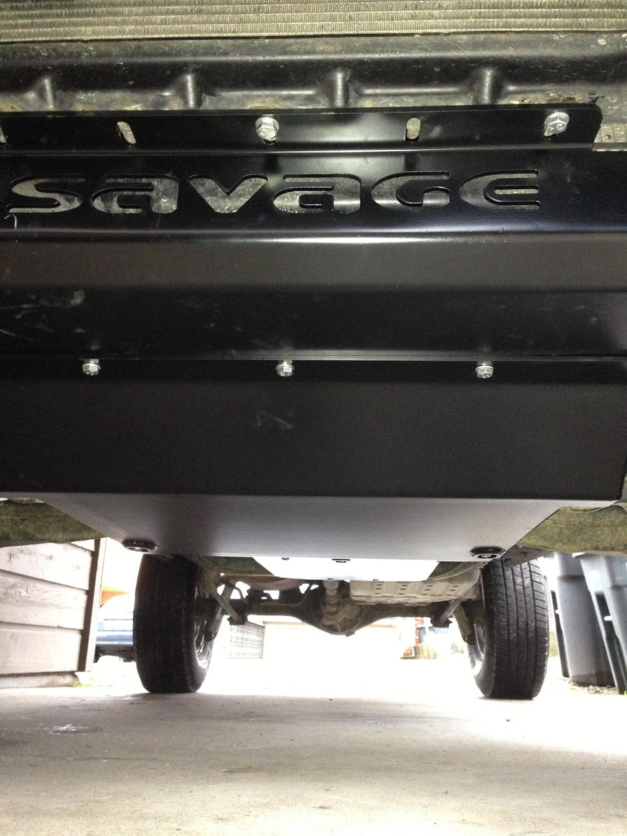

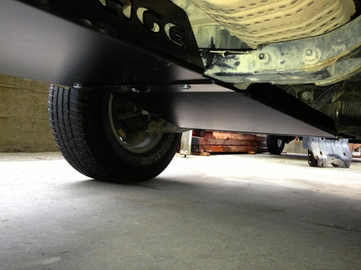

hey can you do a detailed photoshoot of the skids. this is my main option i have right now and would like a better look at the overall coverage.
please and thank you.
Here's two pics I snapped with my phone after installing them.
Any more shots needed just let me know.

Very nice. Thank you for all the pics. And the idea of what to do with that cross member. Mine is bent as well.
