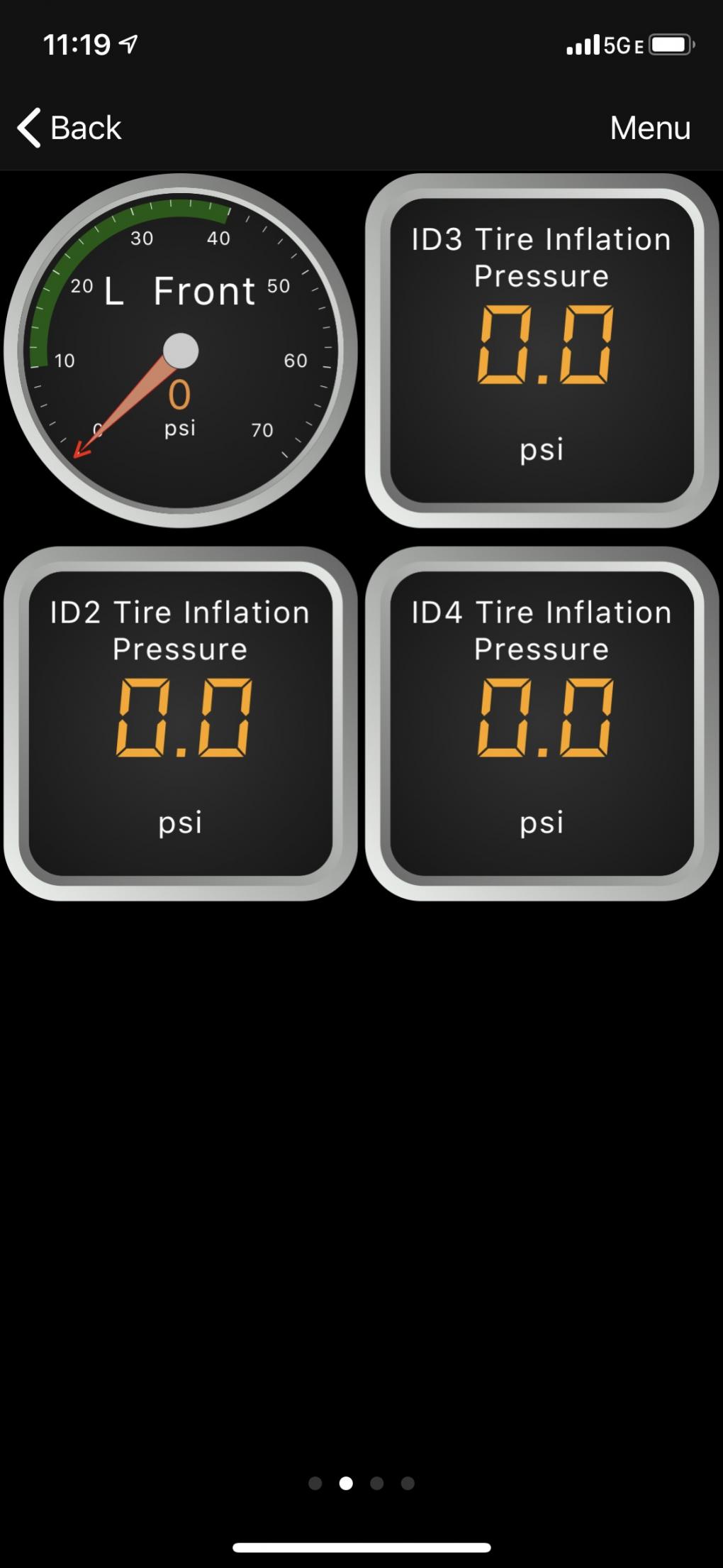

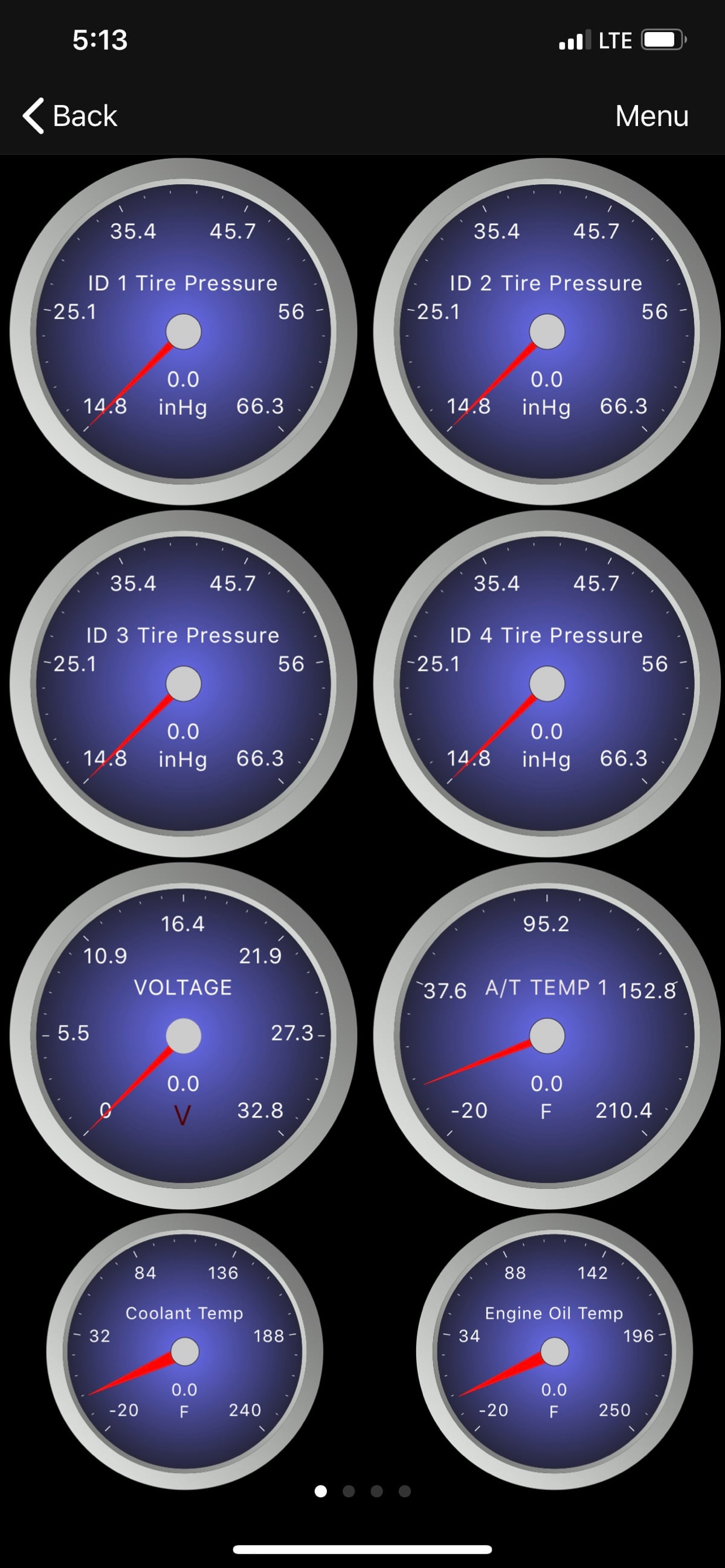

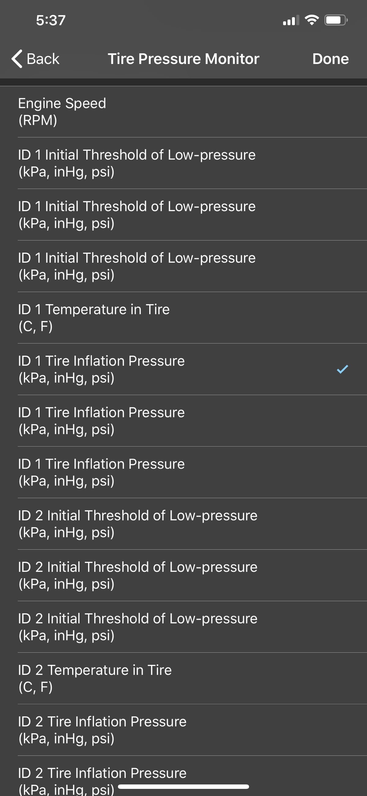

My OBDLINK MX+ arrived today. I setup a custom dashboard and everything works except tire pressure. I’ll link a couple screenshots in case I screwed up the settings somehow or in case I’m missing something. There seems to be multiple options to select each sensor, but there is no description indicating what is different...
Try going to Settings->preferences->Units->pressure and change it to PSI
Go back one menu step to communication->general+connection and make sure it is set to manual an enable prompt for ECU. This should give you the option to connect to different ECU’s
IIRC you can only connect you one ECU at a time and the TPMS system is on its own.

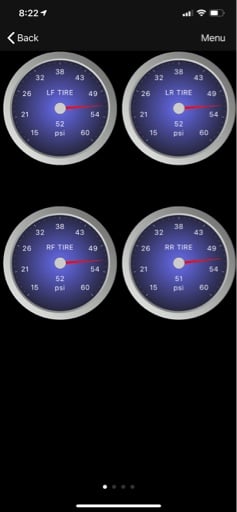

I figured it out. Updated firmware, the list of available id’s was decreased dramatically. I reselected the id1-id4 and reconnected. I was surprised to find all my tires set at 51-52 psi, the door jamb says 32 but the tire says 51 max. No lie this is even smoother riding than my wife’s 2015 CLA250 4Matic...
Ah cool! Yeah, that's familiar, I seem to recall it updating the firmware too.
Are your tires E-rated? If so, that could be a relatively "normal" pressure. But does seem a bit high if you aren't running loaded.
Actually they aren’t , and this is how it was delivered to me new on August 5th. I’m going to address that with the dealer, they dealer traded for it but should have checked it.

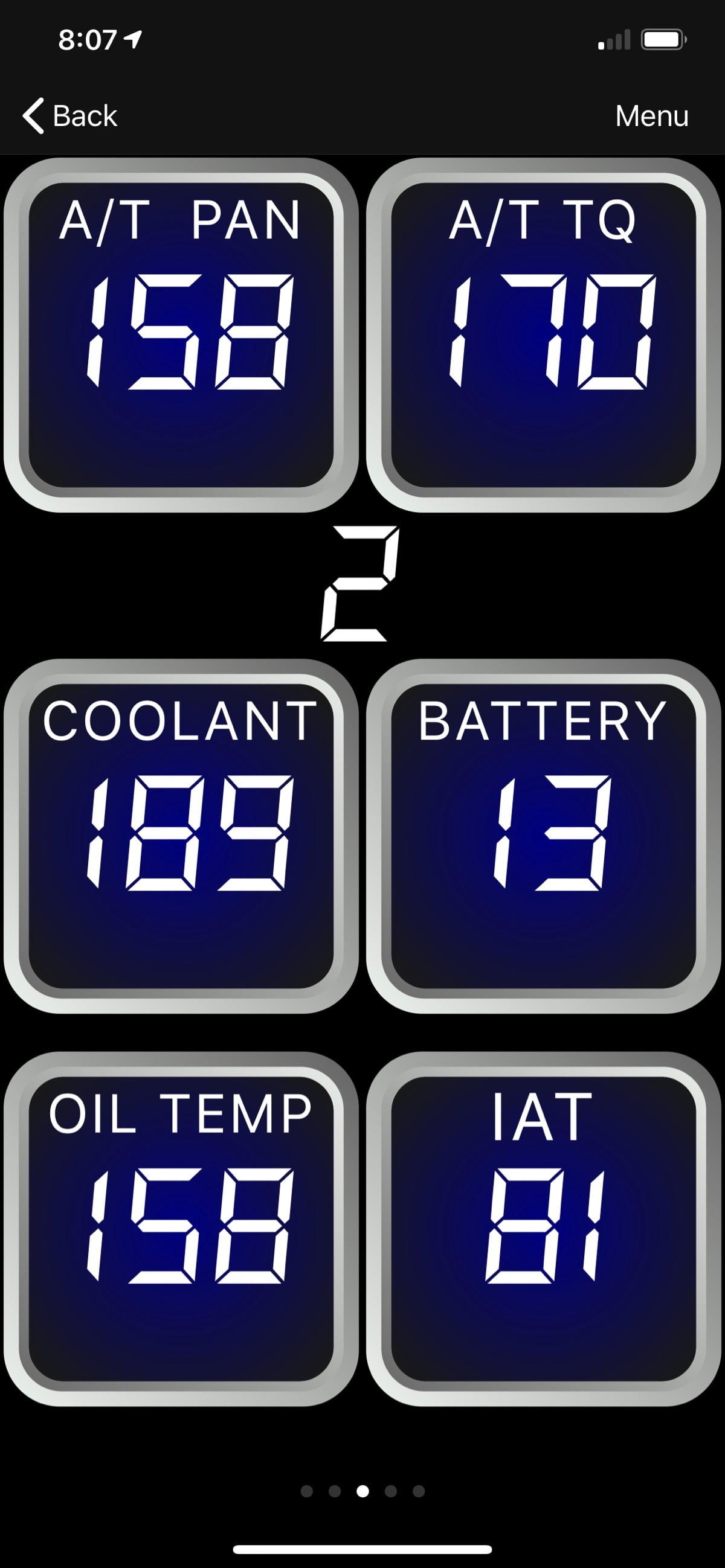

Can anyone confirm trans temp 1 is pan and 2 is TC?
Hmm not sure I would guess the cooler of the two to be the pan? as the hottest fluid would be traveling into the TC, of course, as I understand the transmission cooler is bypassed if the fluid isn't hot enough.
That is what I concluded as well based on other data I found online. Added tire pressure/temps with cluster color matched gauges

How did you change to that color scheme, and how did you get tire temp at the bottom of the pressure?
You can customize the colors in the app under style, I used photoshop to get the hex codes
the blue is FF0286FF (new blue darker FF234FA6
The red is FFFF0000
The temp gauge is another "display" that I added on top of the original (its all about the size and placement using no background colors) in the app.
I ended up switching to dial gauges also
