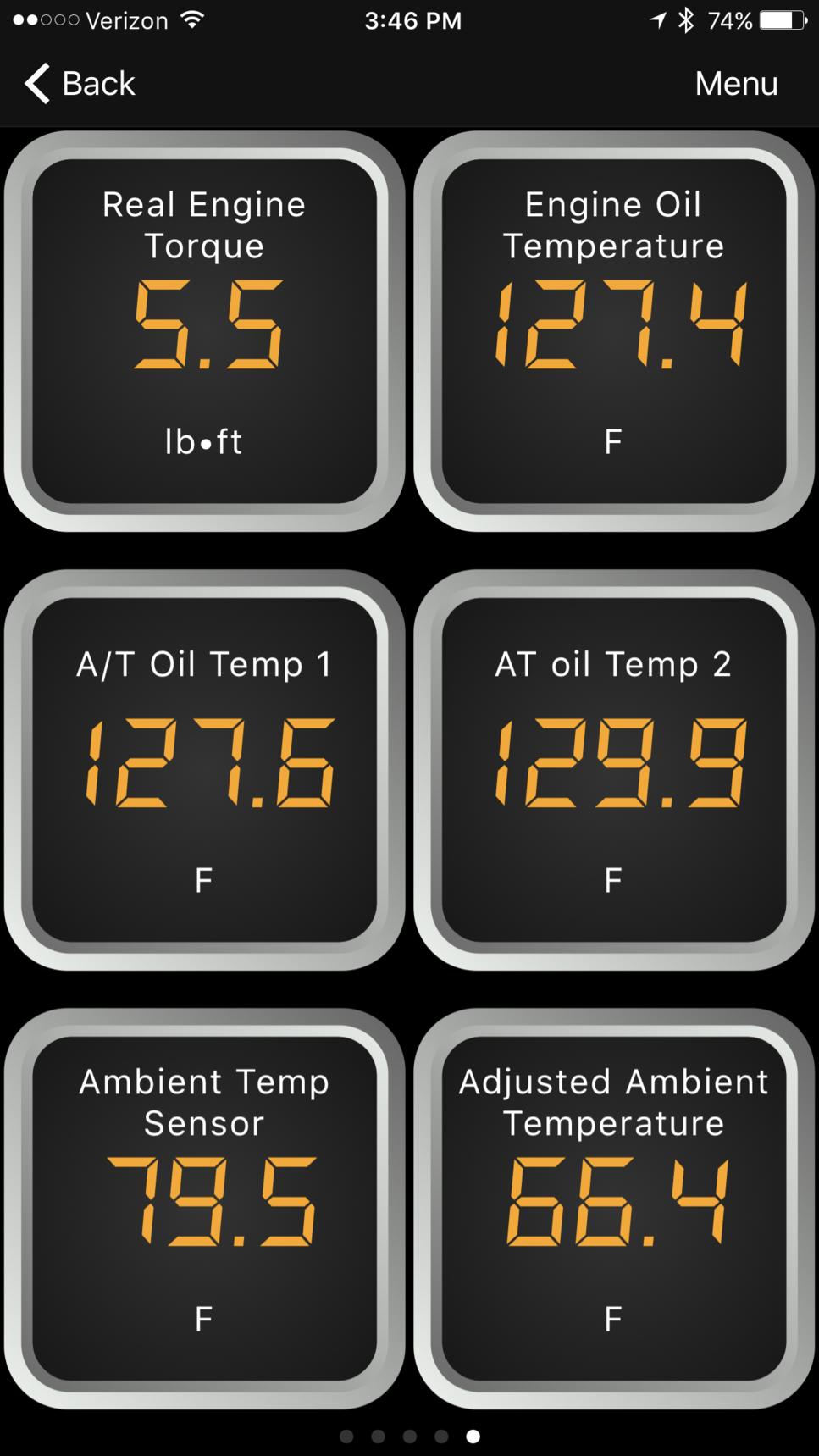

I've had the OBD Fusion app for some time along with a compatible ELM 327 imitation WIFI adapter for my iPhone. I've had the trans temps programmed in there through customer PIDs and have used it successfully for some time. They recently released an in app purchase that brings Toyota/Lexus/Scion specific scanning ability. I was just messing with it and it appears that it has the trans temp values as well as oil temp values straight in the app now. Screenshot below. All items did not require custom PIDs.
Also, it looks like the app supports TPMS and maybe KDSS but I haven't gotten that to work yet. Per my email with them, it looks like I need a genuine ELM327 adapter and not the imitation which most sell (genuine is more expensive).
There is A LOT more, most of it useless (like what your window is doing) but its there. I'm still going through it. What I did not see (maybe the car doesn't have it) is the gear the car is in or what the torque converter is doing. Additionally, I don't think this app does anything with customization (disable seat belt chime for instance).
What PID's are you using? I used the ones posted above, but the values its giving me are off, as in they're showing about 100 deg higher.
In my app (when I did it manually) I had the following for torque converter Temp:
((((C*256)+D )*(7/100)-400)/10)
I wonder if your values are in C vs F.
