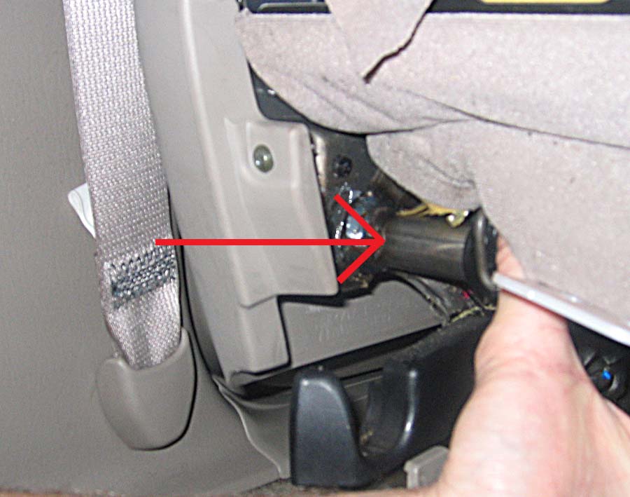

I found my seat has a cracked tube in the frame.
My seat one day started to have more up and down rock as described. The noise is so bad I have to turn up the radio to deal with it. I looked under the seat and to my shock I found the problem. On the bottom of the seat in the back there is a tube that goes accross the seat laying on top of the tracks. My T4R is a 2003 so the seat has a manual crank lever that you can use to raise and lower the seat cushion angle. (clear as mud?) Well this tube has a clean break all the way through it near the end. It is right at the weld and looks like it got to hot and caused the pipe to fail. I called the dealer and they said $450 to replace and another $140 in labor.
I called Toyota and they said its not covered.
You can view this from behind the drivers seat looking under it.
I suggest everyone take a look and see if that pipe is broke.

Not covered???? Are you still in your warranty period?
