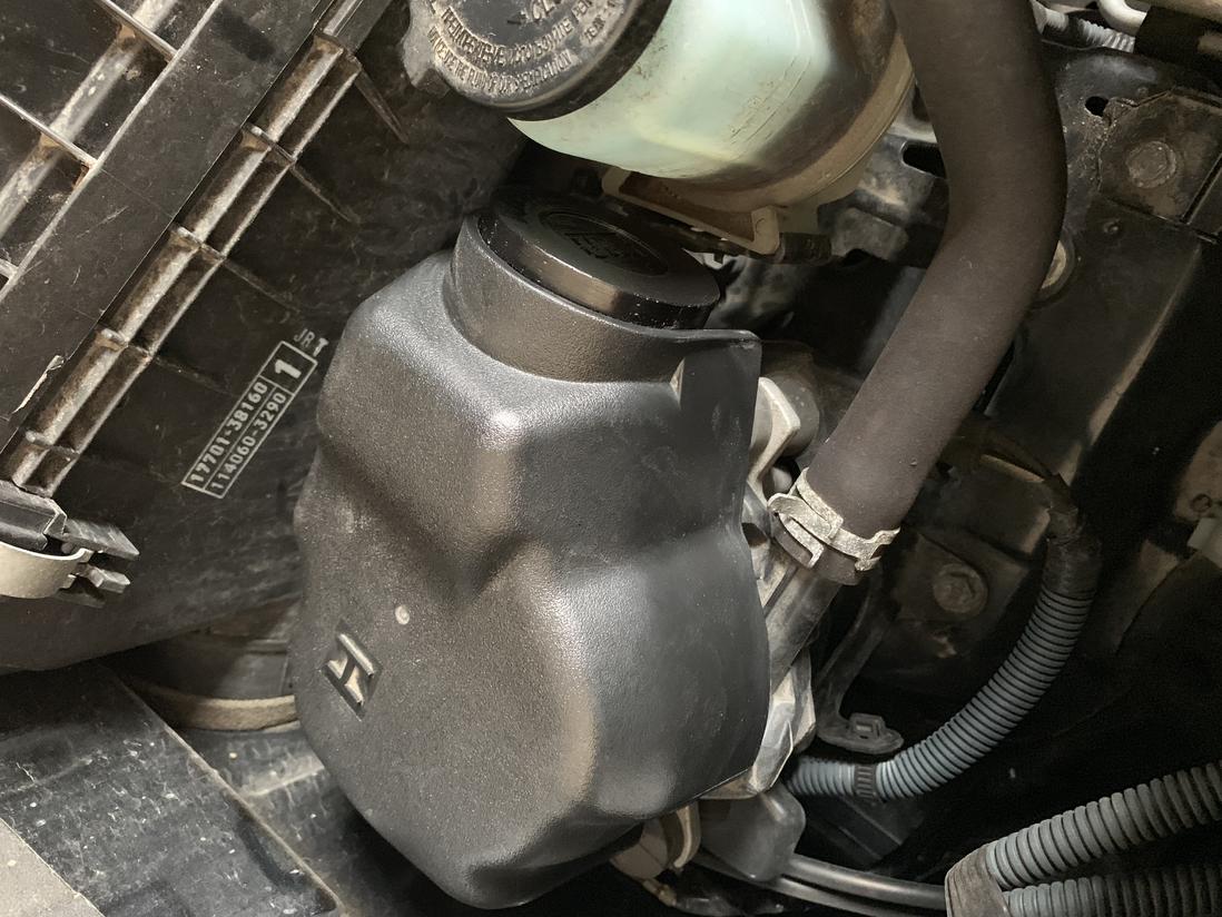

I put the Uni Filter UP-107 on last night. Super easy to swap, my foam filter didn't look too bad with a little over 90k miles on the truck but nice to have done as a just in case.

Mine appeared to be in good shape but got er done anyway.

What trimming are you all talking about on the uni up 107 filter? I found one pic where it was sticking out. Are you trimming the stem so it slides down farther?
