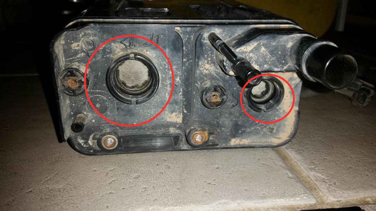

Sorry to hijack a old thread but being a new user I can't start my own yet.
I've been using this site and others for awhile for research and its been great. I've got a '01 Tacoma, a '12 Sequoia and I recently purchased a '01 4Runner with 144K miles for my son.
His 4Runner has been throwing P0440 and P0446 codes. I swapped my Tacoma's gas cap with his and my truck didn't throw the CEL and his didn't stop so I think I can rule that out. The filler neck appears to be in great shape.
Today we put 6v to the CCV and VSV under the hood, as well as to the VSV mounted to the charcoal canister. Each clicked when applied with voltage. I also checked that each of the plugs feeding the switches had 5v +/- when the truck was running. We pulled the charcoal canister and inspected it for cracks as well as inspected all the hoses - everything looked good.
With the cannister on the bench I tested it for leaks. Using soapy water and a bit of positive air pressure with my mouth, I noticed air leaking around the two ports where the mechanical valves mount. See attached pic with red circles. I pulled each of the valves out and cleaned the ports and the o-rings - they were filthy.
My question - shouldn't the canister be completely airtight at least to the pressure I can create by blowing? Could the leaking air from both of these ports cause the P0440 and P0446 codes?
We have not smelled any fuel vapors, the canister granules appeared to be dry, the cannister itself didn't stink of fuel, my son doesn't overfill the fuel tank at the gas station, and the truck itself runs great.
I ended up cleaning the o-rings and adding a bit of flex seal at the connection above the o-ring in an effort to seal up the leak. I figured it couldn't hurt.
Thanks for any feedback

I have a 2000 4runner that has a different style of canister but I checked mine for leaks similar to how u did with yours. In my case I had a pin hole leak and once fixed my PO446 went away. IMO if yours leaked when pressure testing that is what is causing the PO446 code. I think once you fix the leaks that code will go away. For the PO440 I have fixed that code a couple of times on my sequoia by replacing the gas cap. It sounds like u got that part fixed. Good luck
MikeM
Thanks Mike.
I wasn't sure if the cannister was supposed to be totally sealed or not. Sounds like it is supposed to be.
Fingers crossed. Maybe Flex Seal founder Phil Swift can add charcoal cannister repair to his commercial! :loco:
