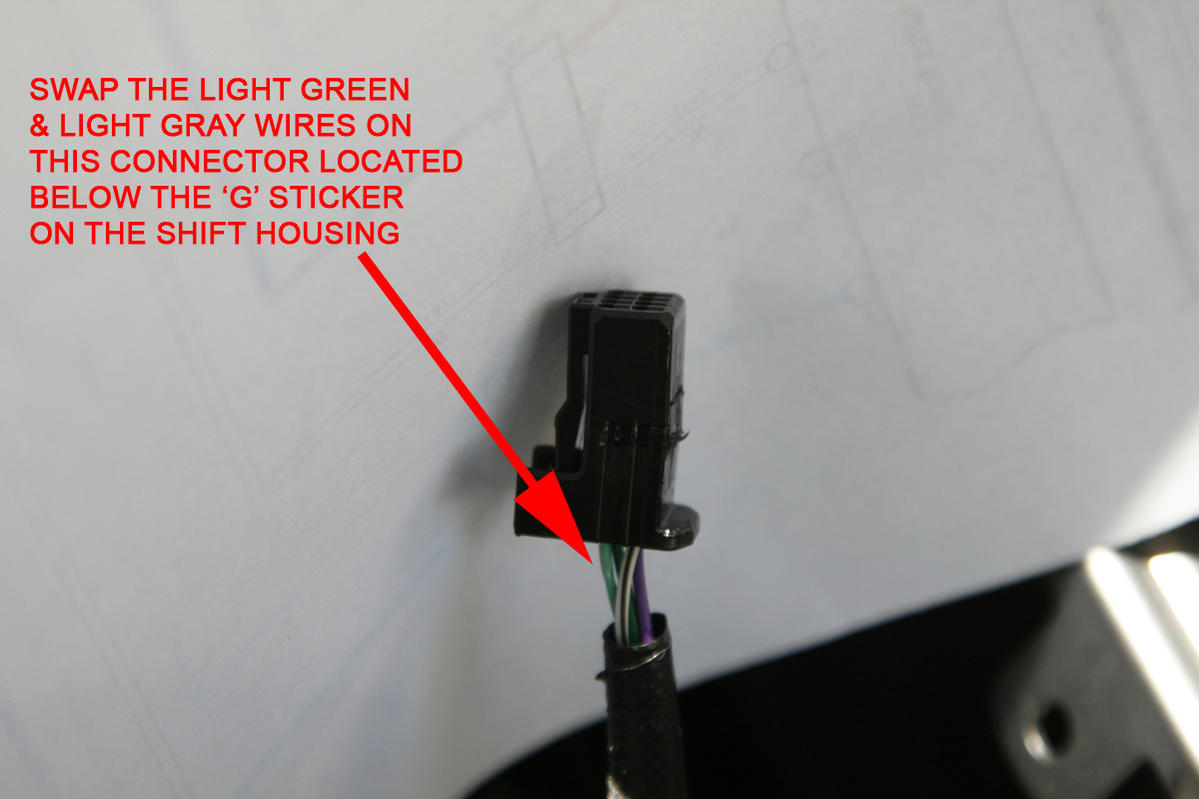

So…. time to mod: It is simply a matter of swapping the pins on the plug for the switch that get pressed when you bump the shifter. If you can extract the pins, this is a simple 30-minute fix. But, I had trouble removing a pin and broke the wire :-( So, I had to cut and solder. I used a RJ45 connector, which worked great. So, now I get to shift like Sebastian Loeb in my slug of a 4R.
I broke the light green wire on this plug. The gray removed just fine. If you can swap these two wires you are done.

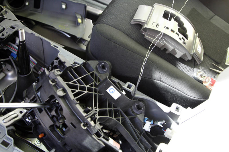

This is the other end of the plug. Both of these pins removed easily.

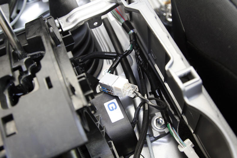

Solder, shrink tubing to extend the wire.
RJ45 with final connections. Now I just need to replace the '+' and '-' on the shift consol.
I broke one wire on this plug. The other removed just fine.

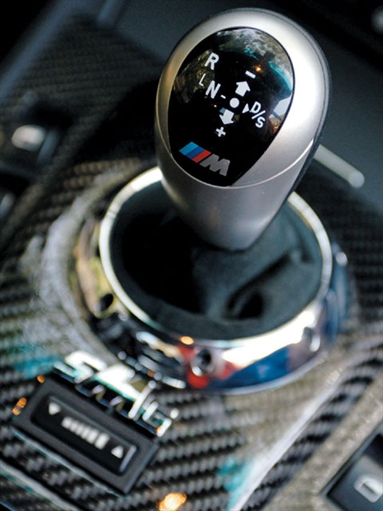

Never thought of that!Very cool mod and it did take some getting used to the "Toyota way" as my last car with the sequential was a M3 and as you stated the opposite way.Never liked or got used to the M3's paddle shifters as I grew up steering left handed with my right on the shifter with 4 and 5 speeds.
And also as you mentioned 270hp is plenty of power but designed to get good gas mileage and not put the power to the ground. Regearing fixes that! 4:56's and stock tires and you'll smoke them off !
Here's the M3 SMG shifter.............

That's a great mod. Which wire are you swapping? I see in the picture you have the shift block unbolted as well, do you have to do that in order to reach that connector? Thanks.
Swap the light green and light gray wires on the harness female connector. On the switch side male connector the colors are different, but you don't need to access the plug unless you brake the wire like I did.

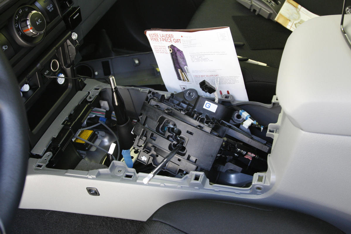

You can get to this connector by just removing the top trim piece. It is right below the sticker with the 'G' on it. No, you do not need to remove the shift housing. I did that because I broke the wire and had to get to the male connector.
