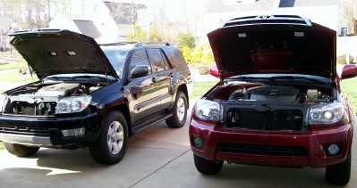

I just replaced mine about a month ago with the same belt from Autozone on my 04. It is even easier to check the routing when you can just open the hood next to you.:D
Yeah, that would have been nice and easy...as long as you do them one at a time, haha. Nice 4Rs.
