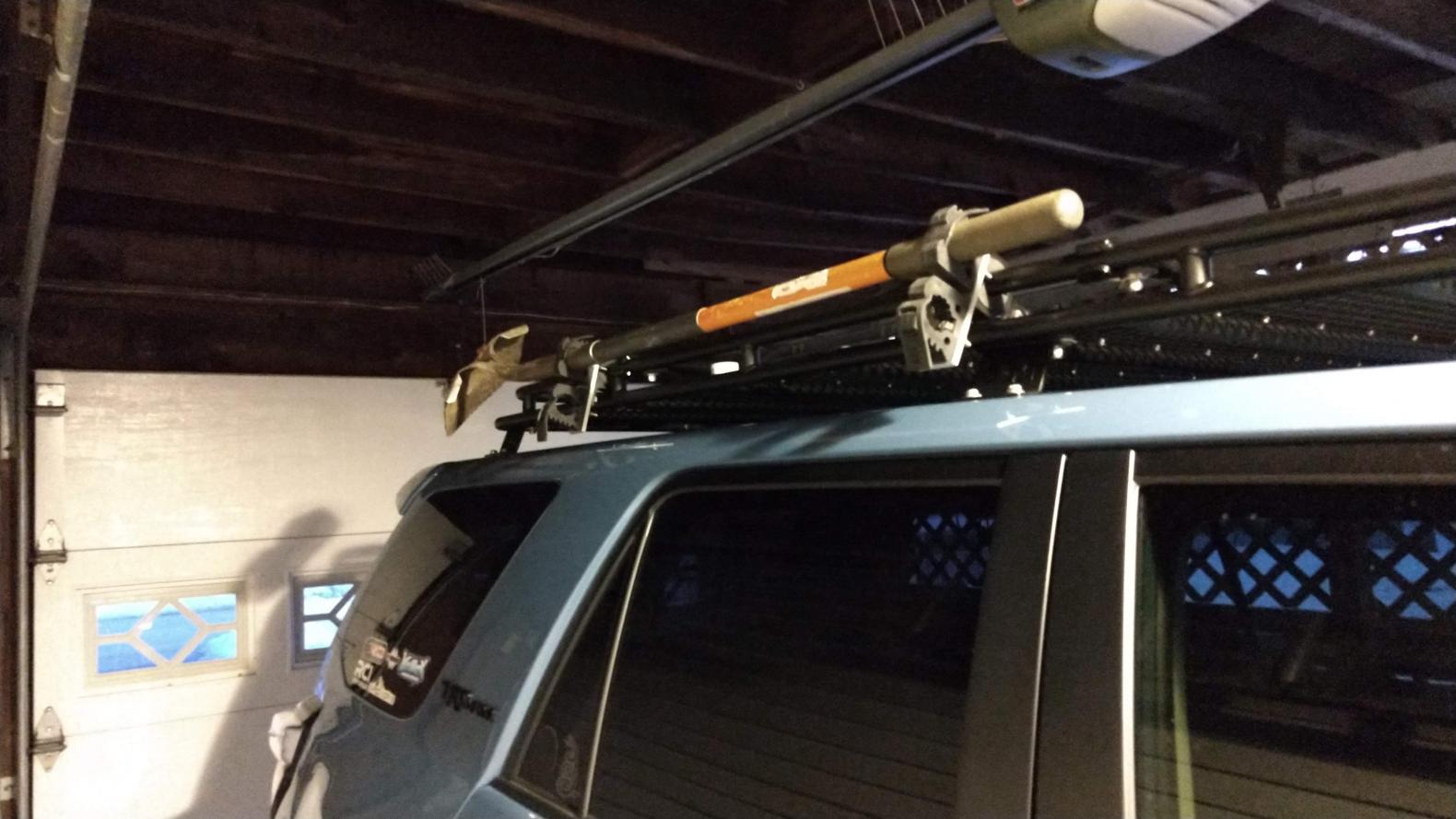

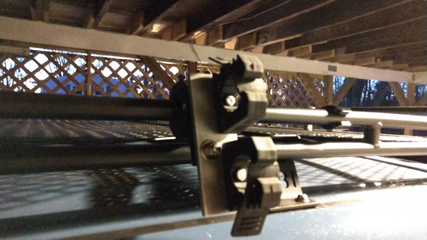

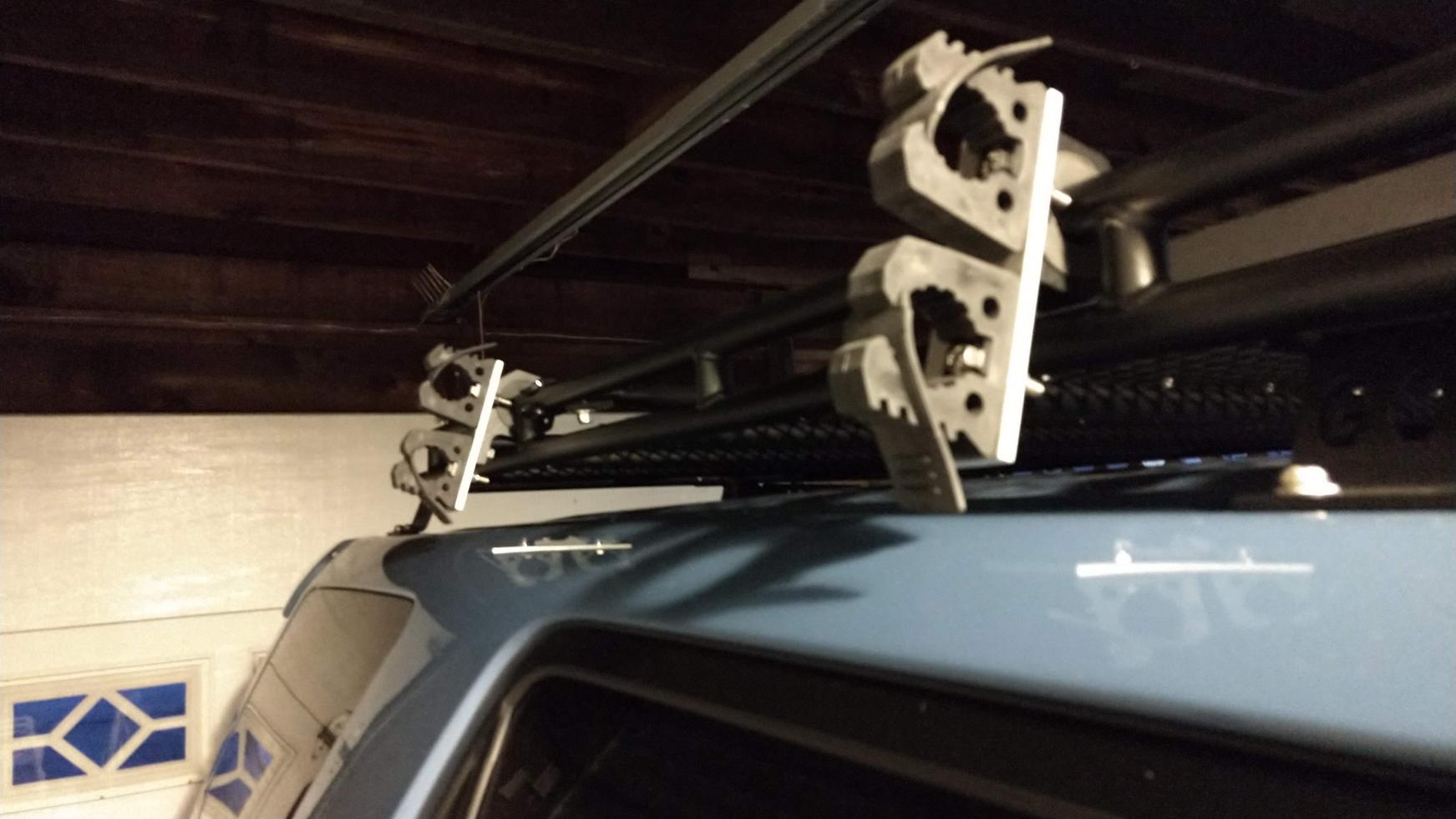

Here's my version. Same basic idea but with a few minor differences.
I had the machine shop at work waterjet two 1"x6" plates from 1/4" aluminum. Instead of tapping the light bar clamp I just added an extra hole for the 2nd QuickFist and offset them from the bar clamp. I also used 1/4" SS bolts vs #10 to secure the QuickFists. To prevent the clamps from spinning on the rack I just wrapped two pieces of cloth bicycle rim tape. Overall it seems to work pretty well. Thanks again [MENTION=128325]cutty01[/MENTION] for the idea.
