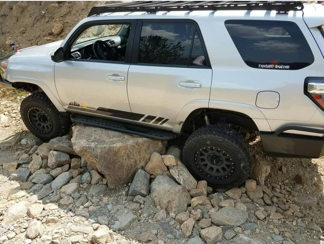

The sliders your are looking at have been great. Wife and kid love them for a step. Not sure the claim about them not being strong. They use .134 wall material where most use .120. I have abused mine, jacked the truck from them and no issues.
Used the winch to pull me off this rock and the sliders just lost some coating.

Going to need to know your credentials to make a statement like that. I have built and destroyed a lot of metal and Schrockworks is one manufacture I do not worry about being "just strong enough". Usually it is funny how many things have to be over built because the average user does not understand the strength in formed metal. A simple piece of 16 gauge metal is flimsy until you put a bend into it; then you have a stout piece of metal that is what most of the 70s and 80s Toyota trucks were made out of.
So how is a piece of 1/4" steel less strong than a 11 gauge frame? Generally the sliders are stronger than the frames they are attached to; but that is just my experience.

To save some people the googling - 5th gen frame is right at 1/8" inch thick. It is amazing the strength of a thin piece of steel once formed into a bent and welded shape.

Did you finish reading my post? In addition to what said in the last paragraph there about the front ends of the sliders, you cannot lift from the sliders behind the rear legs because they start touching the rocker panel before the rear wheel has lifted off. That is probably unimportant on trail unless backing down bigger rocks for some reason but that amount of deflection is still something I would rather not see.
Considering that the Xterra Shrock sliders have 3 legs, I don't understand why the 4R version has 2 legs.
