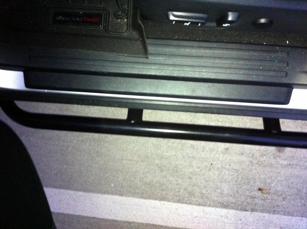

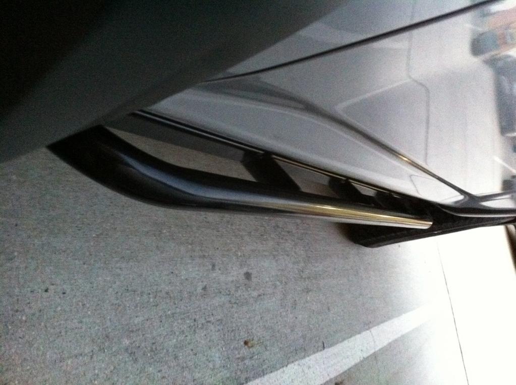

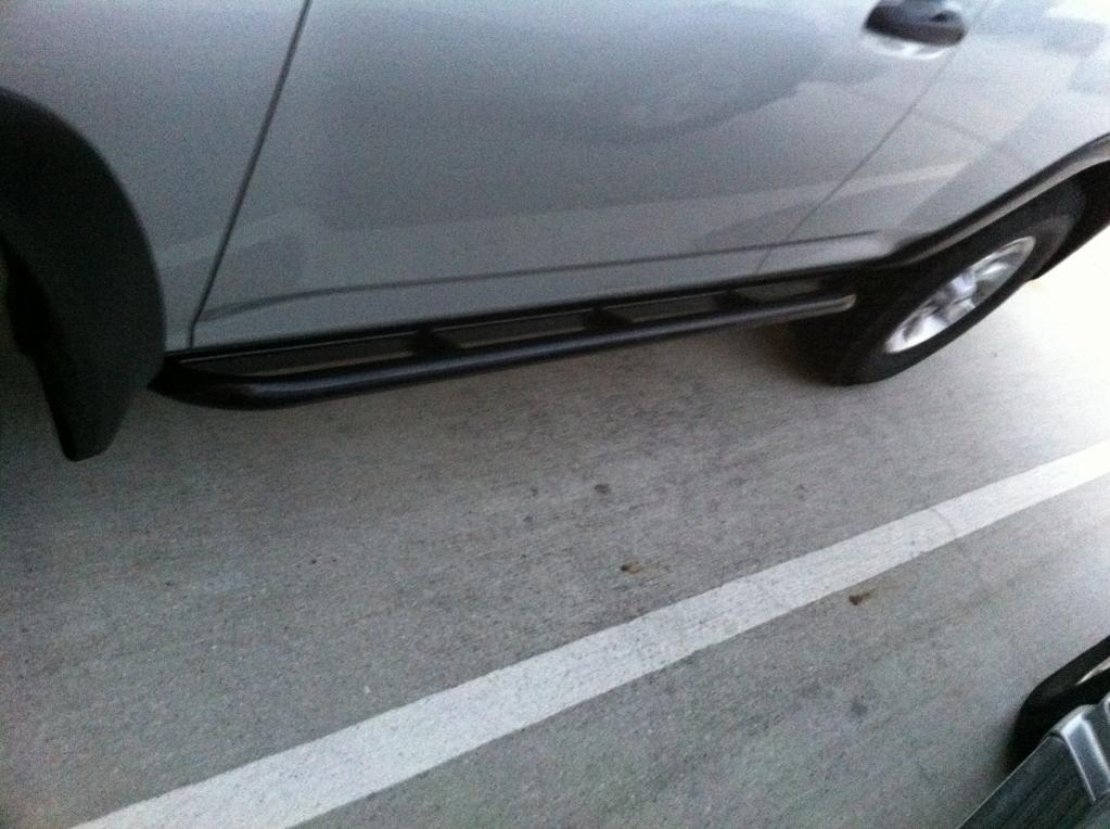

Here are some crappy pics; did this in my apartment complex parking lot and it was getting dark.
