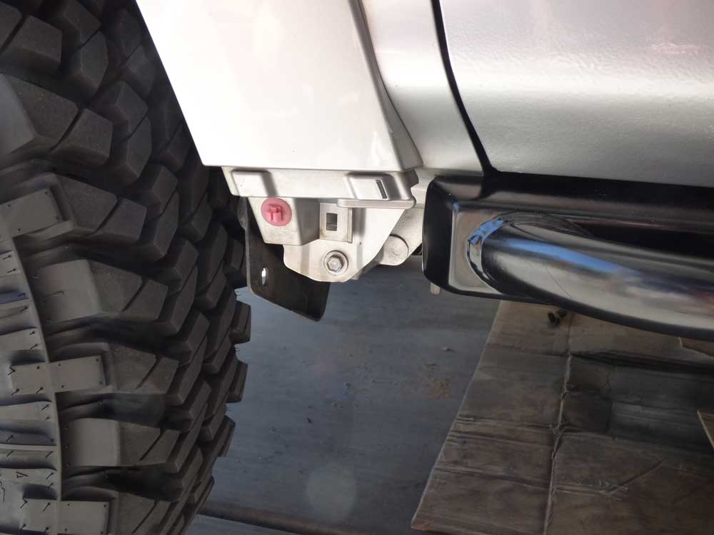

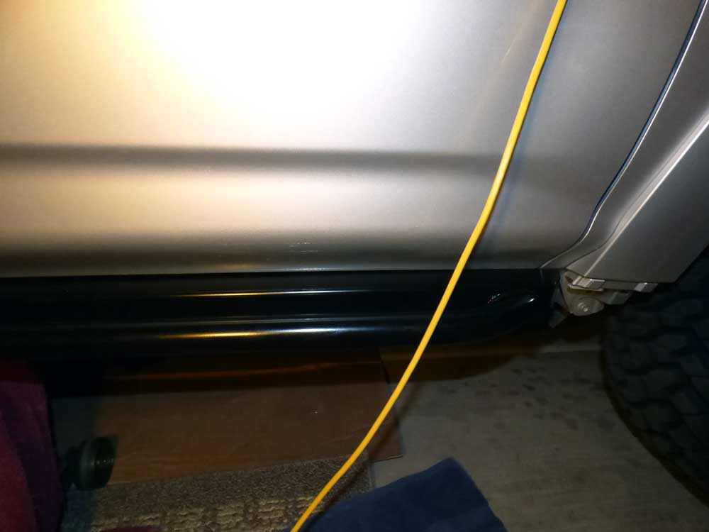

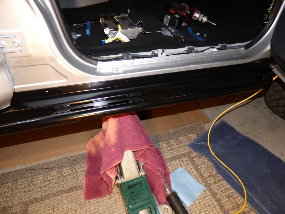

I finally picked out some sliders and got hem installed. I chose the Sleekster sliders from RED as I have used this style of slider before on my Jeep, and I likes that they tucked up tight and didn't require cutting the rocker panel (it is completely removed) or any type of filler panel (except for two end caps that Toyota charged $30 apiece for)

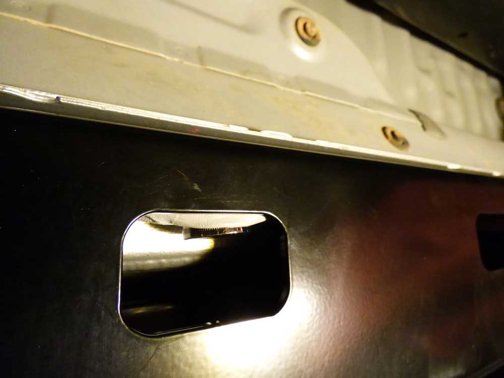

Following the advice on one of the threads I decided to use Rivet Nuts instead of rivets to mount the upper part. Although it may allow me to remove them later for cleaning, it made it almost impossible to install them in the perfect spots. Because the holes don't necessarily line up with flat sheet metal, there are a couple that end up on the slope of contoured metal. The end result is that there were a few of the upper holes without bolts in them. As these are not really for structural support, I think I will be OK.

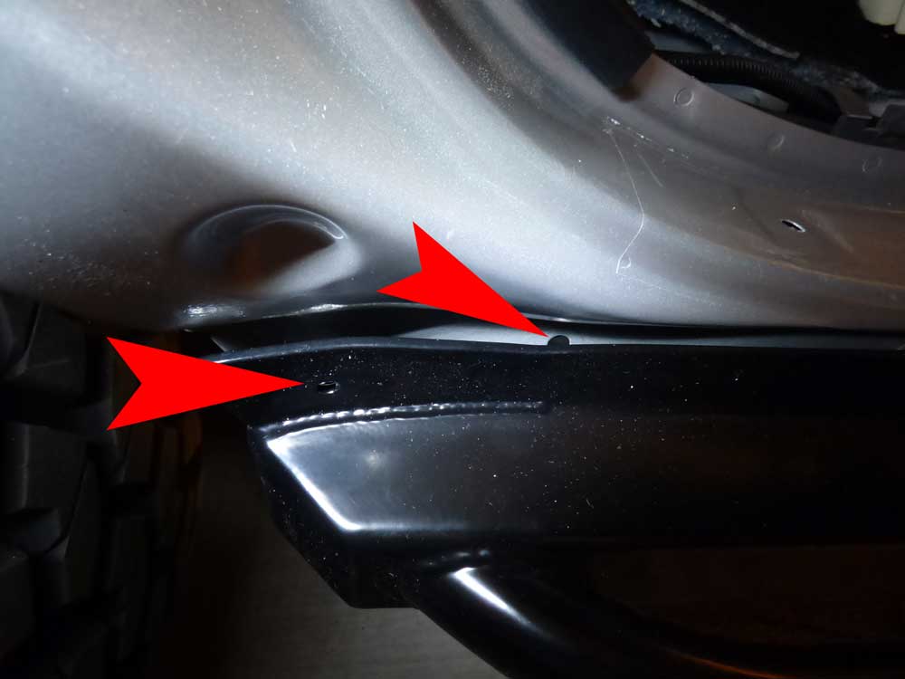

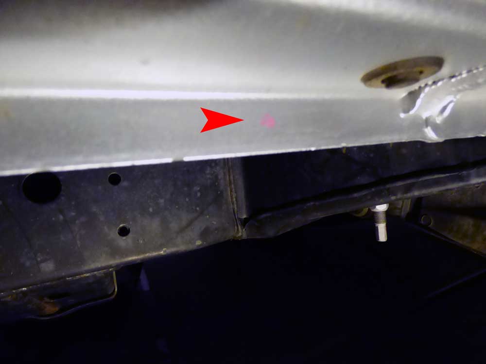

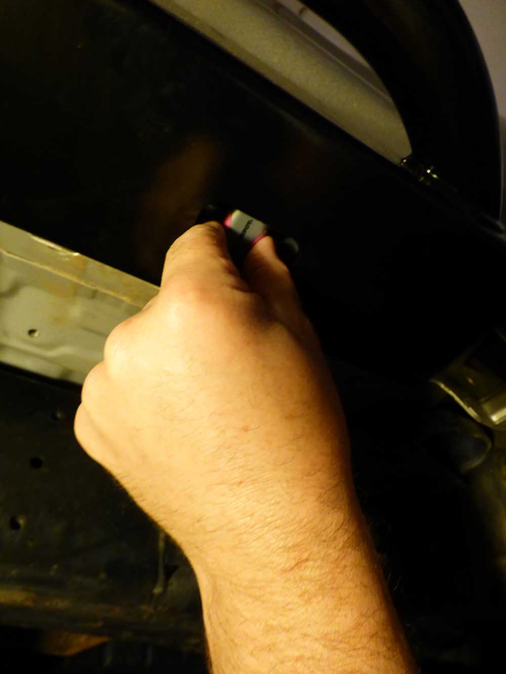

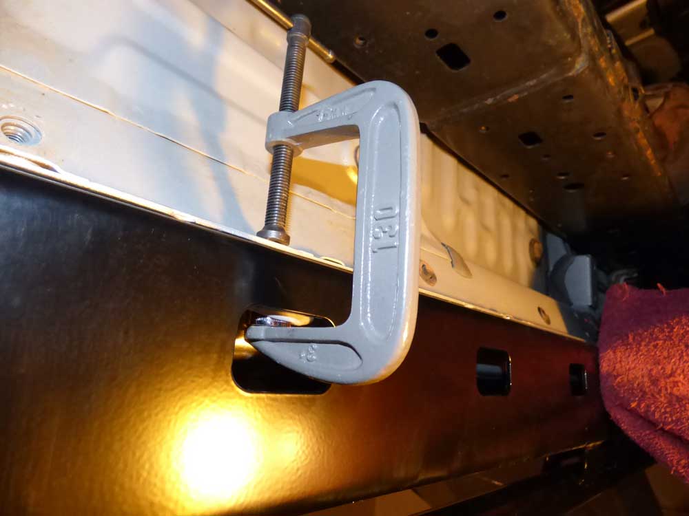

Install requires marking holes on the pinch seam through small windows on the bottom of the sliders. There is very little room to work with and if you hands are any bigger the a 4 year olds, you will have trouble.

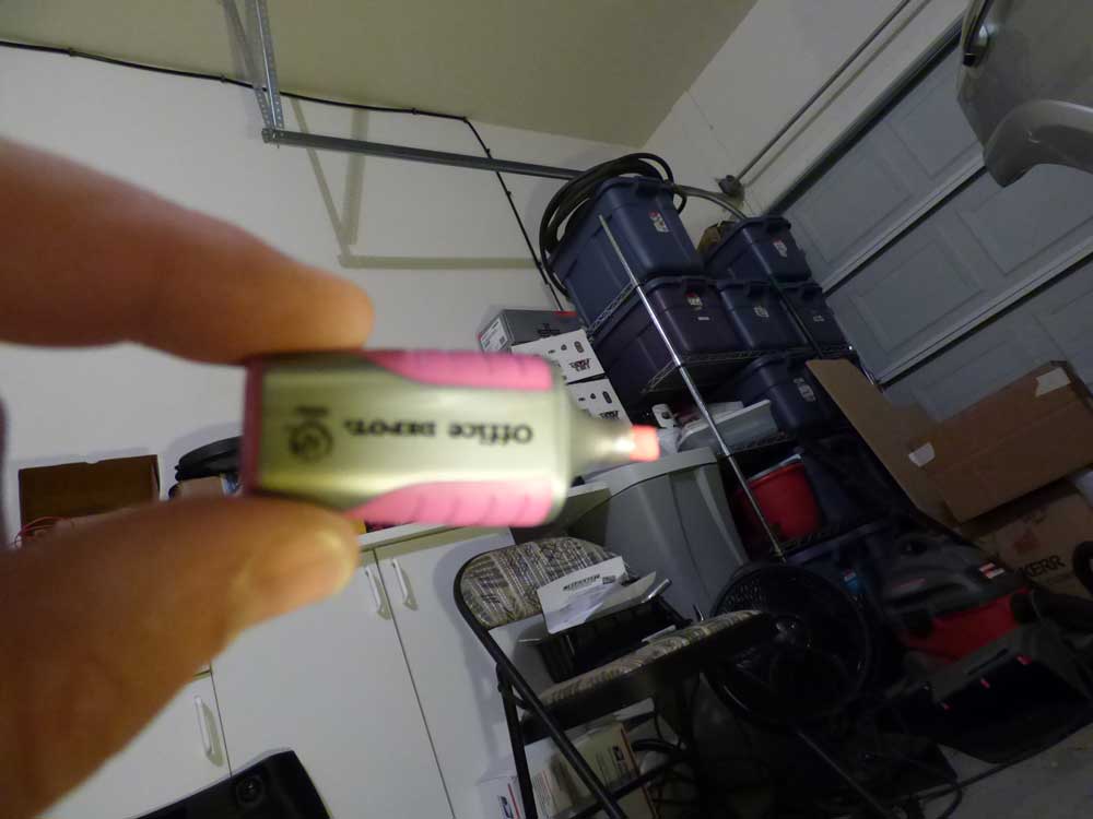

I found a small highlighter that I had that worked pretty well. Other than a few holes not lining up correctly, the install went pretty well.

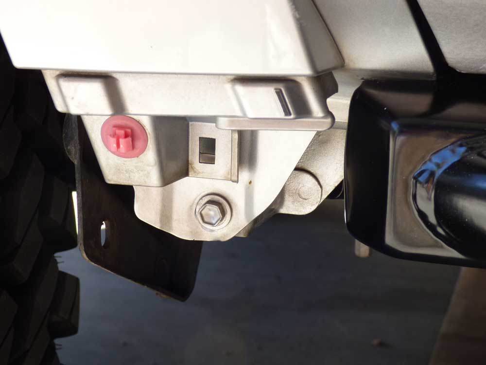

The instructions say that the rear upper hole lines up with a hole that the rocker panel uses. This is not the case on an SR5. You have to drill out that hole as well. I believe they will be updating their instructions to clarify this.

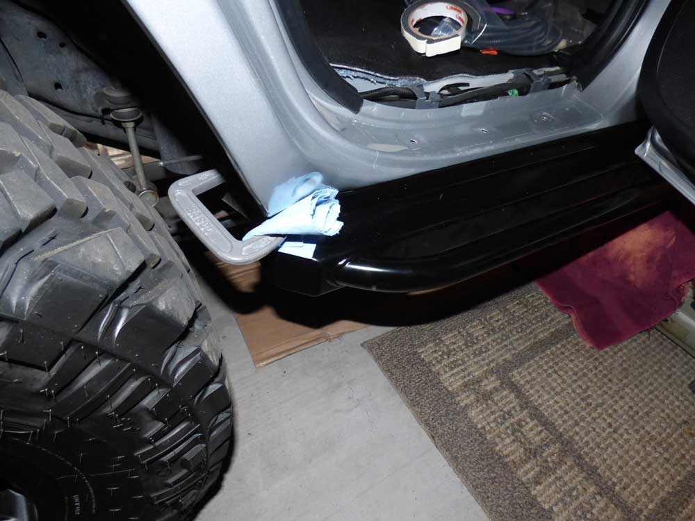

You have to clamp the slider to the body while you mark it. Since my clamp wouldn't reach the body through the little window, I used a socket with some duct tape on it (to keep it from rolling down the slider)

This is the highlighter I used. Seemed to work for me.

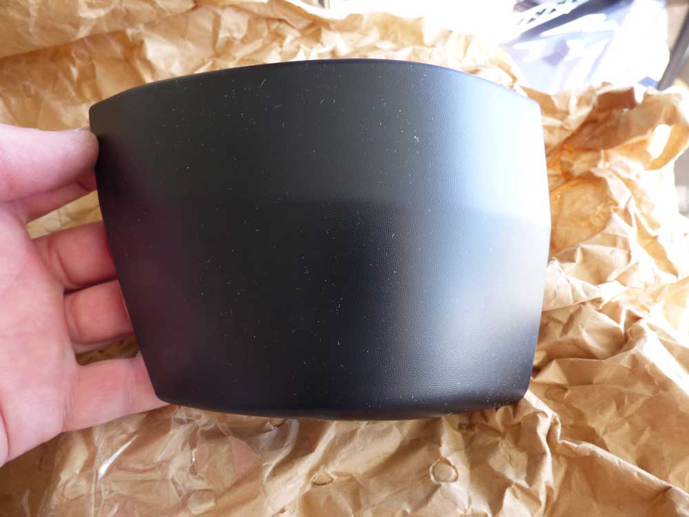

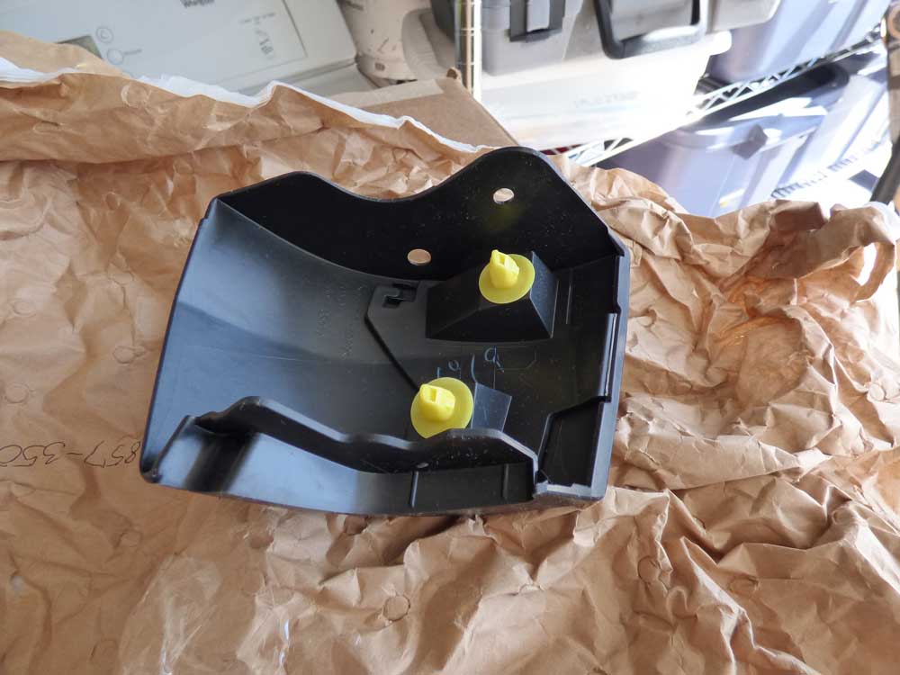

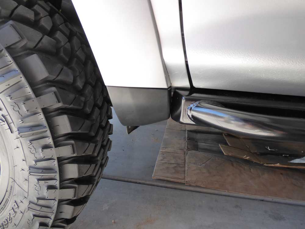

Can't say I am pleased with the fit of the end cap. No matter how hard I tried, I could not get the slider side to fit completely flush. Not positive why it won't snap into place. It's not going to fall off as it is screwed in from the front as well as clipped. (the image shows two clips. On the SR5 only one fits. The other may fit on the 2014 and up which is what these are for)

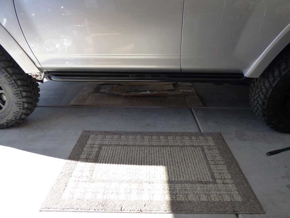

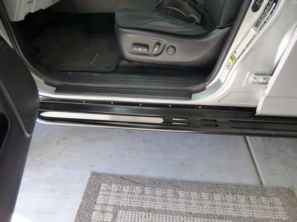

Overall I really like the looks of these. They are not really functional as a step up since they are nearly at the door sill height. Haven't tried to stand on one to reach the roof rack, but there is probably enough room to get a couple of toes on.
Check out this thread:
http://www.toyota-4runner.org/5th-gen-t4rs/150296-2014-trail-rocker-trim.html
I remember someone talking about the fit of that cap, and what they had to do to make it work.

I am happy with them. I find shorter people have a hard time getting in, as they sit higher than most other type, but that is what the grab handle is for:bounce:
Other than that, I haven't gotten into a situation where I have had to use them as sliders yet. You get more clearance at the sides so it takes a pretty big rock to slide one. They are still solid. I can climb on them to reach things on the roof. Overall pleased, I guess I just need to get taller friends.
