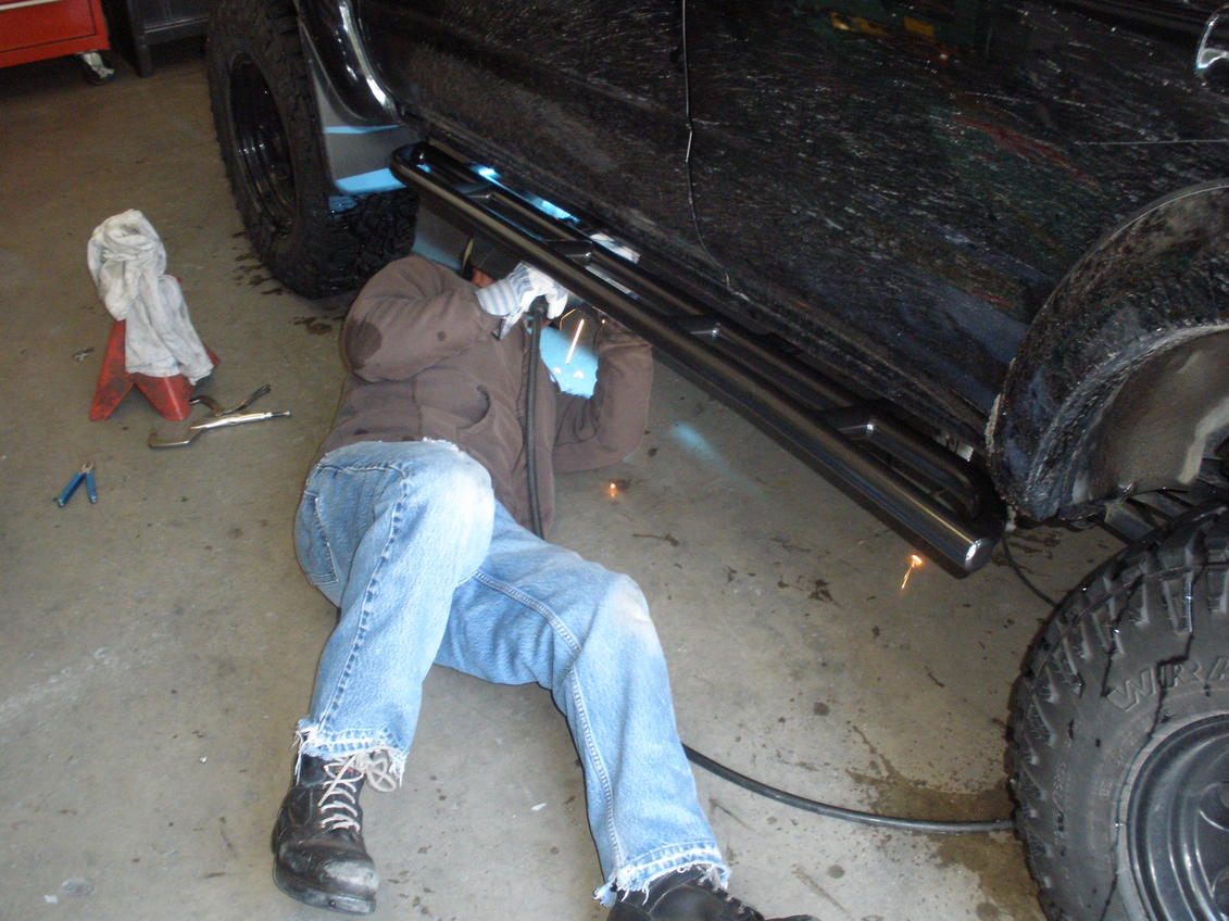

Richard is near you and he'll do the install, Charged me $400 for his HD-SKO sliders, painted and installed!

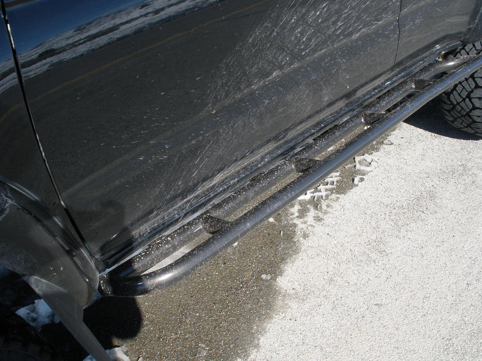

All of my sliders are weld-on. We really do not like bolt-on sliders.
The sliders we build specifically for 3rd gens are .188 wall 2x2" legs and main tube. The outer tube is still .120 wall. You should not have any deflection with my sliders if they are installed correctly.
They really do not stick out as far as most of the others on the market either. These angles shows it better
