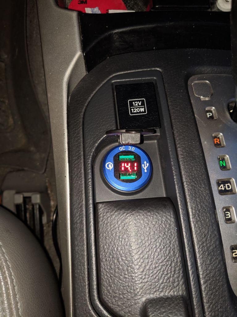

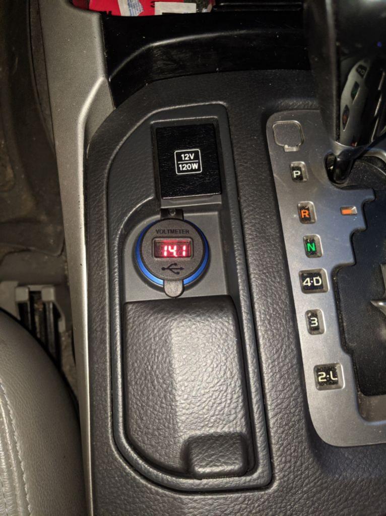

I did this...
I put mine here, too.
I got the double USB...
one for power (charging) and the other for audio.

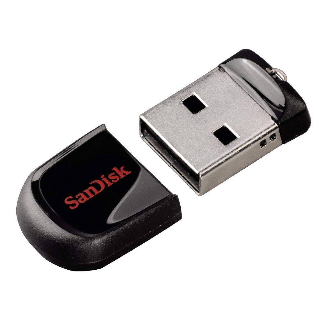

I did find that I kept bumping my USB thumb drive with it mounted there...
so I bought a low profile thumb drive and haven't had a problem since.

Yeah, I can see the "burger tray" hitting a full size thumb drive. A USB cord is no problem though.
Dude, that's cool! I hate the OEM location of the AUX jack. You have a writeup?
No write up. The little panel I bought has the USB and audio leads integrated and I just popped the blank switch, fished the leads through the hole, connected them to the back of my Pioneer H/U , and voila. :)

Just an update regarding this mod. I have been very, very pleased with everything I performed regarding this USB mod. I wouldn't hesitate at all to recommend this to anyone.

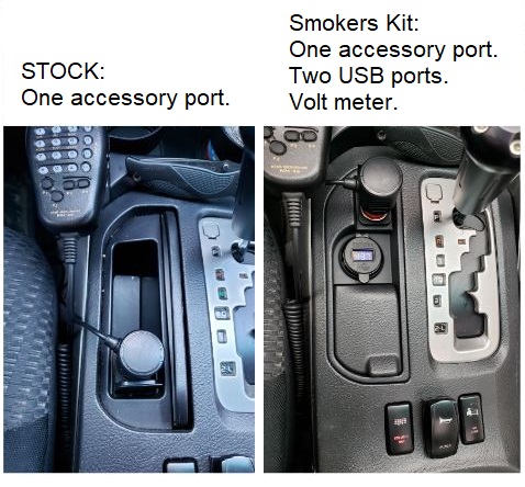

I posted elsewhere that my AUX 12v power adapter near the driver was not working. It was intermittent and it seemed as if it was because the connection between accessories and the socket was poor. In researching a fix, I came up with this idea.
Needed:
The "smokers kit" feels nice.The USB Socket kit feels like a cheap USB port. If it works and lasts a few years, it's no big deal. Perhaps it will feel better once installed.
I set it up this way as I wanted a USB connection going to the back of the headunit. If all you want is "power", there are numerous other options for that.
If you wanted, you could leave the ashtray light plugged in and installed. I don't plan on using the ashtray for anything other than storage of something random, so I took it out so I wouldn't have to plug anything like that in.
