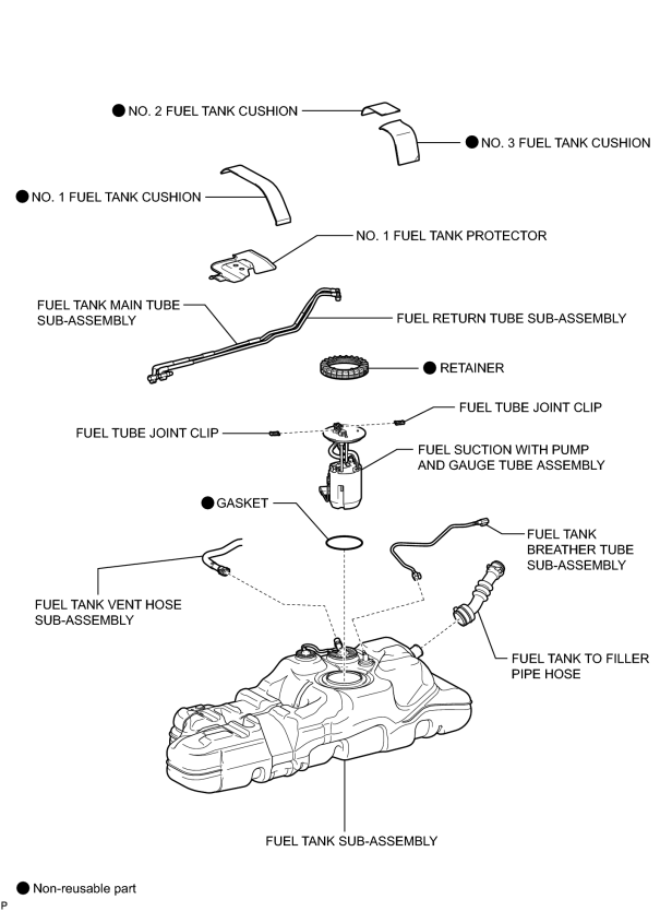

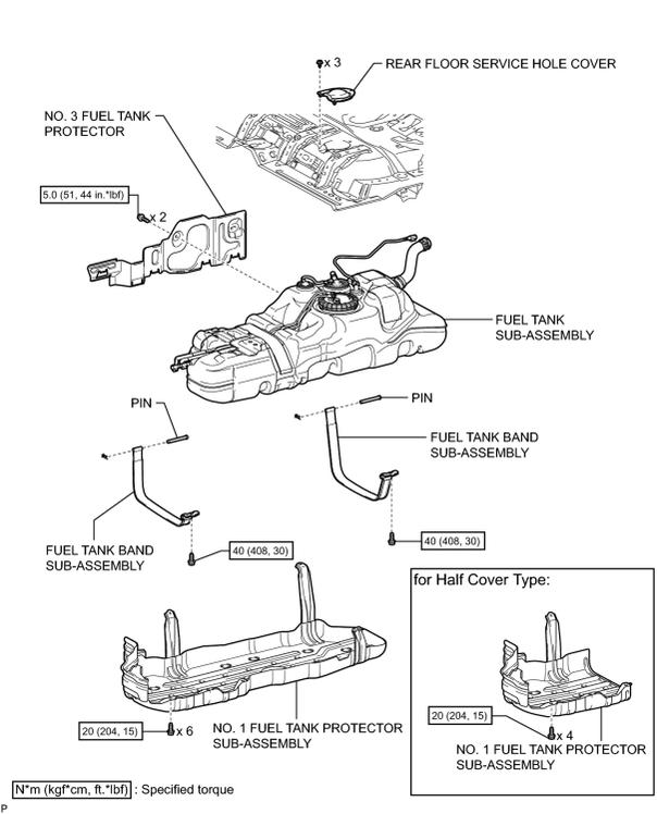

I've been doing some research and it was hard to get my head around your wording of the fuel line " snapping". IMO ,I think maybe one of the connectors was faulty or improperly installed and it came loose there and the reason it would look cut. Nylon fuel lines are used throughout the industry and are pretty tough and never heard of one or could even imagine one snapping in two.Them chaffing on something could rub a hole and make them leak but not snap.
Here's the fuel system where your talking about and you can see the lines on top and the connectors on each end.
These are what the connectors are like and probably what came loose.There are a male and female one at each connection.
*1 Retainer
*2 Nylon Tube
*3 Pipe
*4 O-Ring
*5 Fuel Tube Connector
