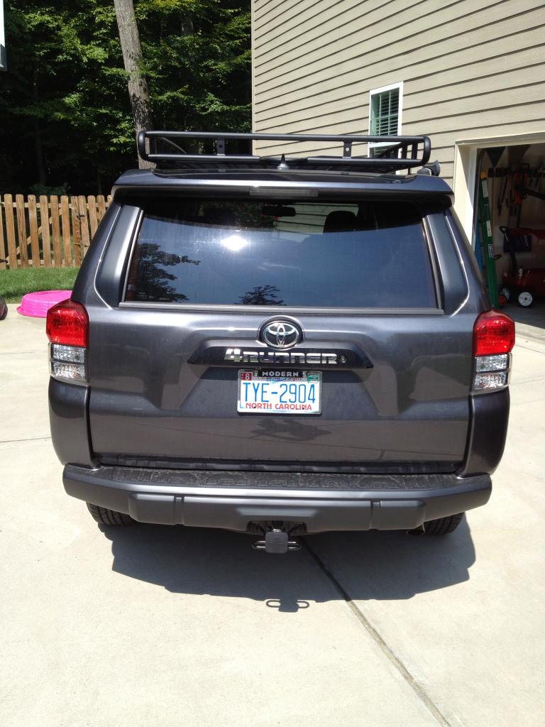

Some better pics of the Bajarack. A simple mod for two people, but by yourself is a little more challenging. Especially getting the rack up top. Took me about 2 hours roughly. Only difference on the install from other write ups on here I've seen is on the TE- you have no covers to pop off, just two bolts that use the star shaped ratchet bit.
