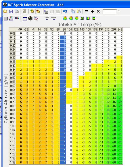

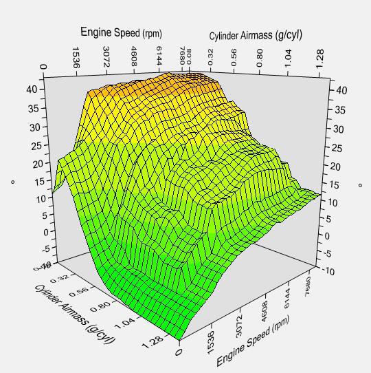

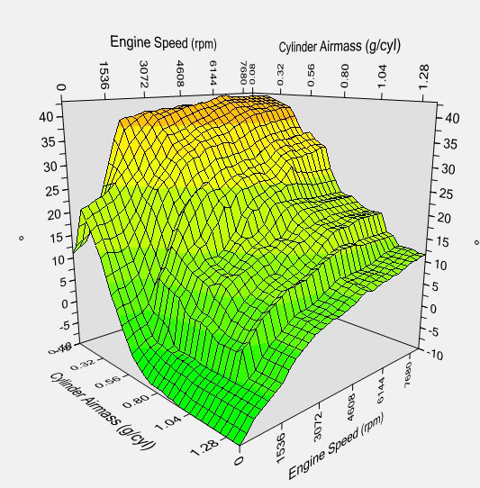

Tossed some pics from HP Tuners from my old LSJ for the OEM Stage 2 tune, my 100 Octane tune and the IAT modifier table. It can get really interwoven depending on the OEM's approach.
