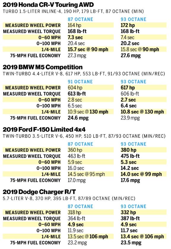

Until measured with data collection, we won't really know what differences there are.
Car and Driver did a somewhat recent comparison on a varied set of vehicles. Now while there are some differences in the 4R with these, there is one big takeaway from this: not much is gained from higher octane in these run of the mill production vehicles. Even when there was improvement, it was not significant.
Is Premium Gas Worth It? We Test High Octane on 4 Popular Vehicles

Wow, 7 pages of guessing and anecdotes...
