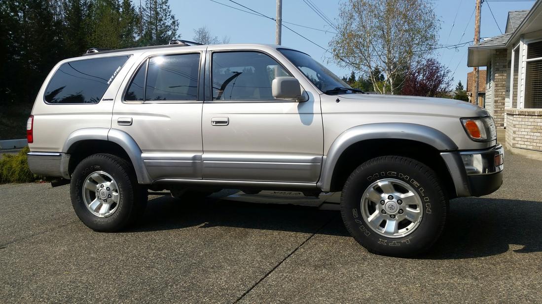

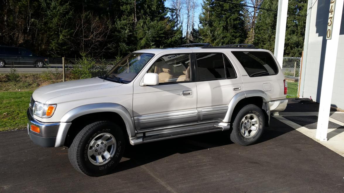

Last year I discovered that 4wheeling had instantly become a hit with the whole family so I had to sell my 89 Toyota pickup cuz the kids car seats just won't fit in the back even with the Xtra cab. So I looked high and low and found this 97 4runner limited 3.4L V6 Auto E-locker with 170k. I'm now the third owner and the first to 4wheel it. As much as I'd like nothing more than to go crazy with the mods, this will also be the family grocery getter so the mods will be modest but that's cool because so is the budget.
More posts and pics to come.

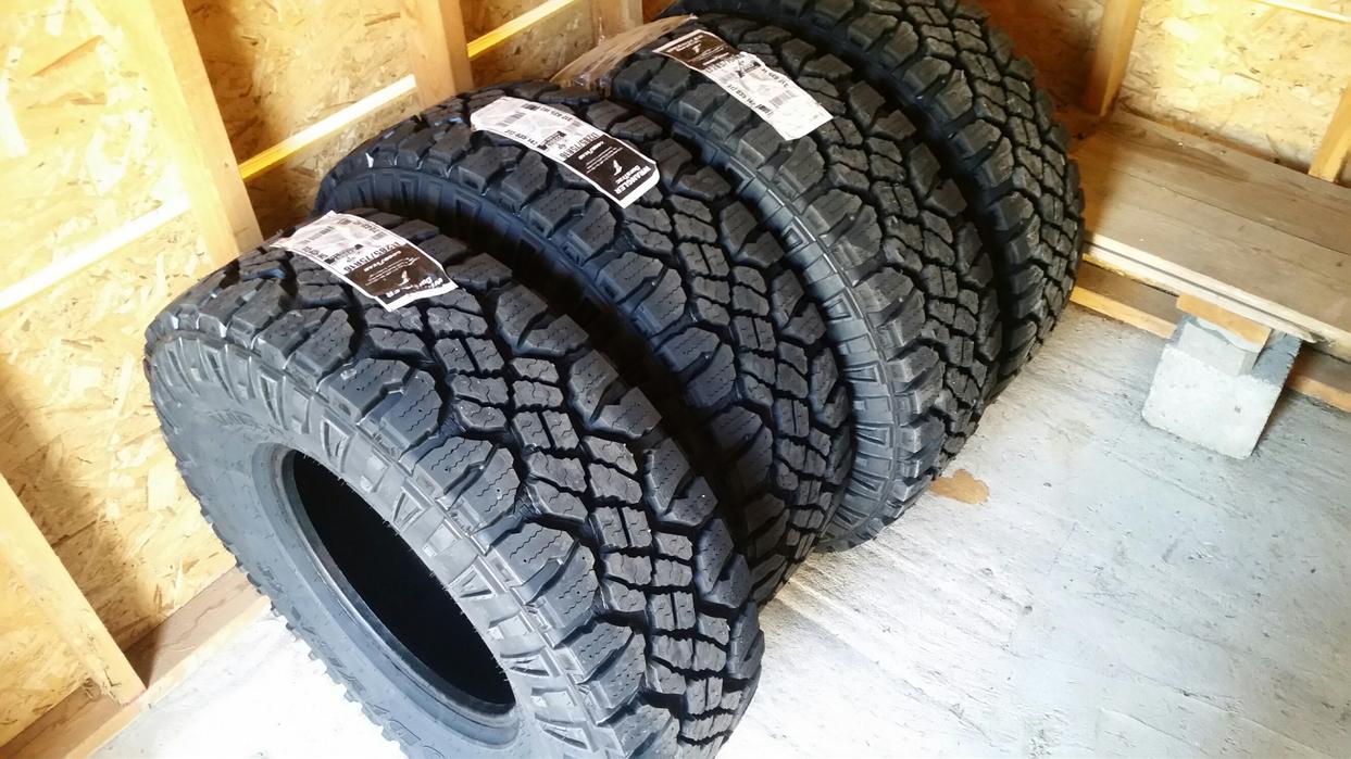

The truck is in serious need of some new rubber and other day I saw a great deal on some Duratracs so I decided to give them a try but they're not going on until I install the lift I've ordered.

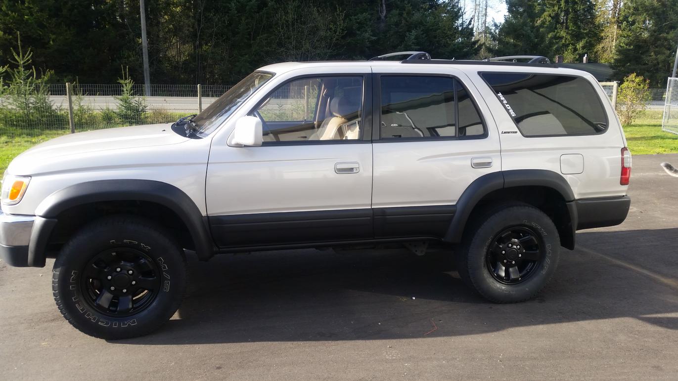

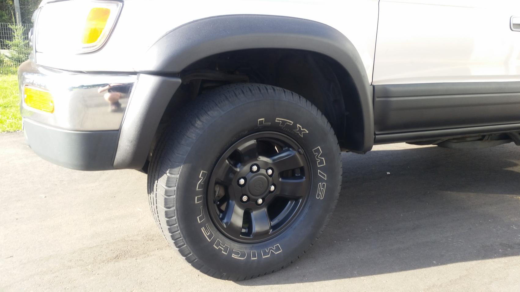

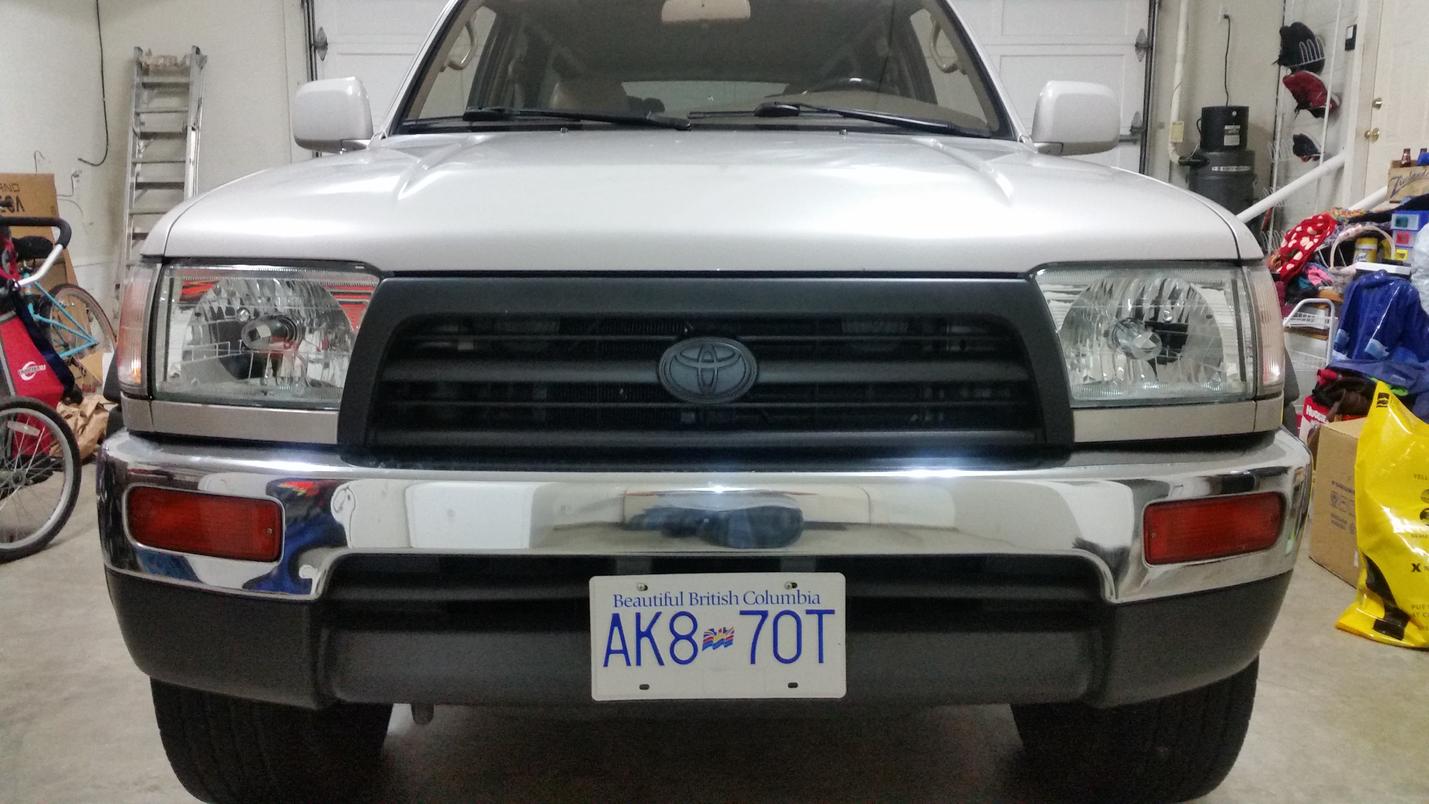

Spent the weekend paint the limited trim, flares and mud flaps with bedliner. Did the rear bumper as well. Also painted the wheels. Happy with the result.
Fenders look nice. I keep thinking I have to paint mine, their pretty beat up. Did you pull all the limited cladding off before painting it, or just do it on the truck?
Just did the trim and flares on the truck. Pulled the rear bumper to sand all the chrome off. Was a PITA because most of the bolts were seezed. They all got a dab of never-seeze when i put it back together. Green painters tape a can of rustoleum sandible primer and a can of rustoleum bedliner. All from home depot. Ran of of paint before I got around to doing the front bumper. Oh and I used self etching primer on the chrome pieces.

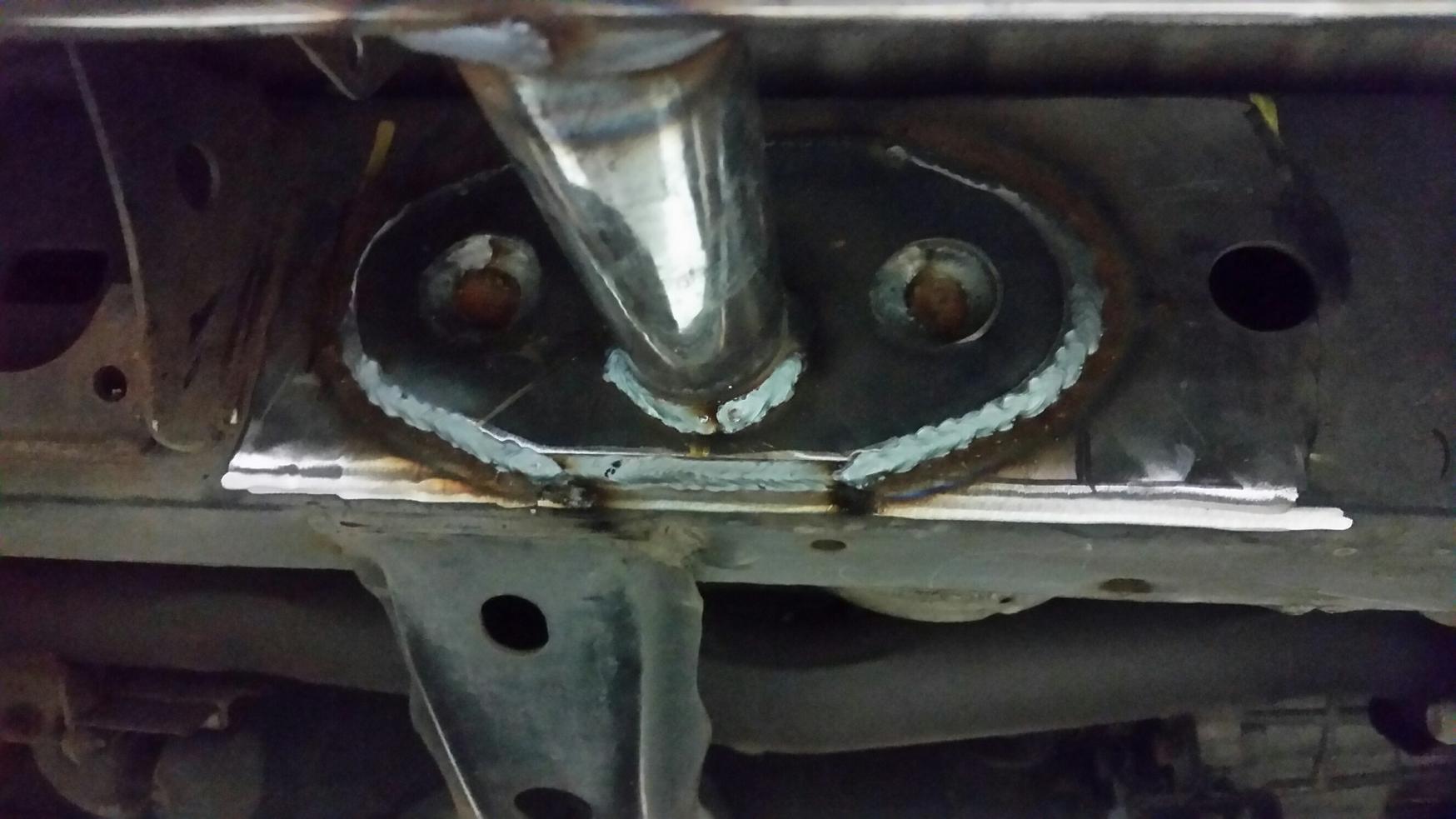

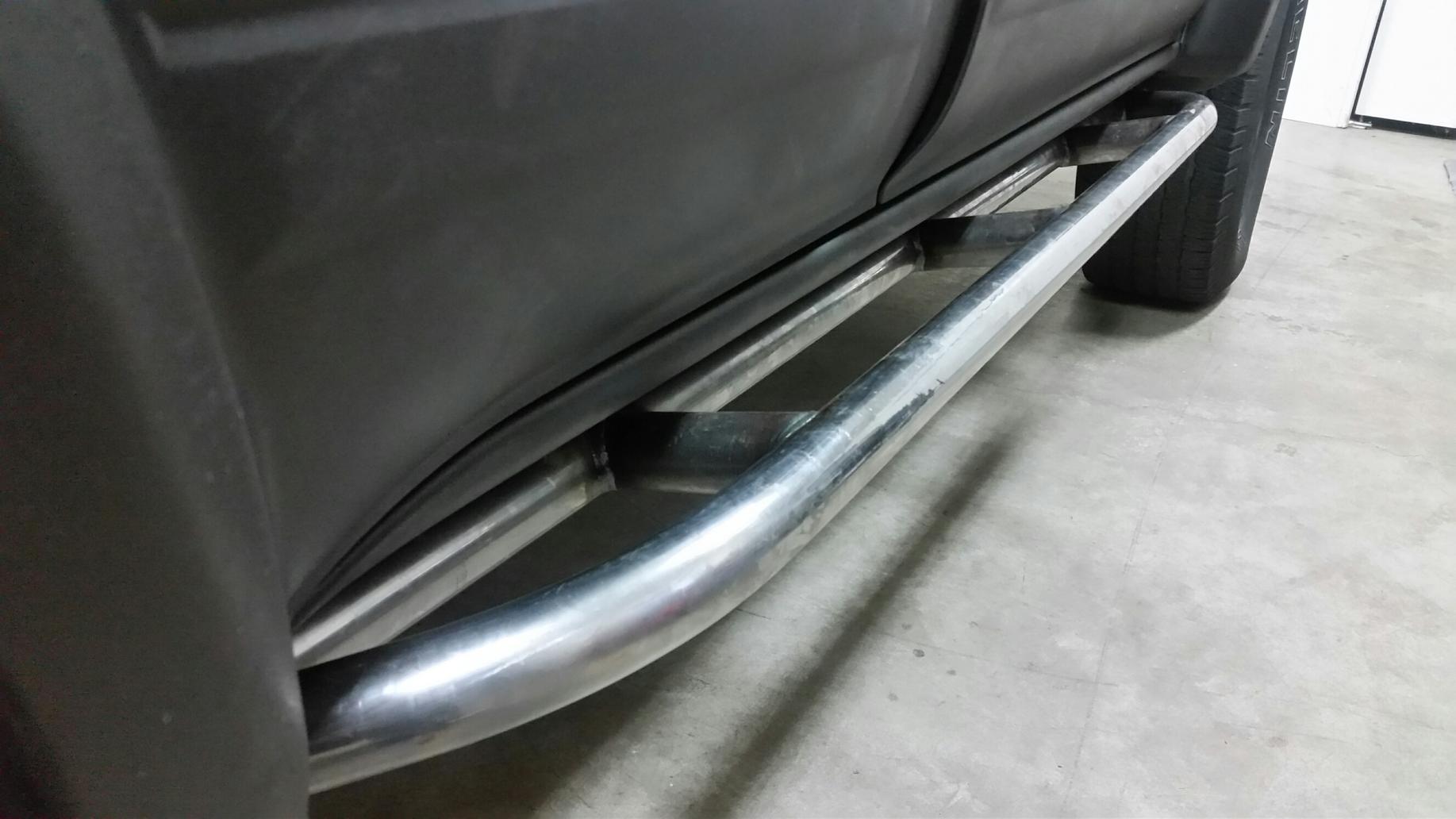

TG rock sliders going on tomorrow morning and I got an email saying my lift kit should be arriving soon, can't wait!!!

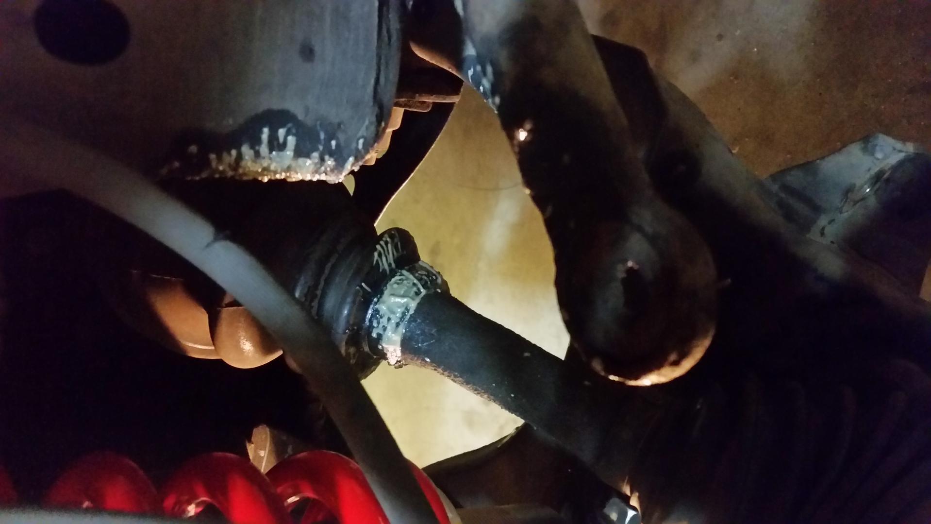

Toytec Ultimate Lift Install Update
Well the good news is the wife was not disgruntled. Also I've replaced the broken sway bar end links with aftermarket ones that can be greased.
The bad news however is my inner cv boots started leaking grease as soon as the lift was installed. I've ordered a diff drop kit and it will go on as soon as it arrives.
Will hopefully be able to get the new tires on and an alignment done this afternoon. The front wheels are really pigdeoned toed at the moment.
