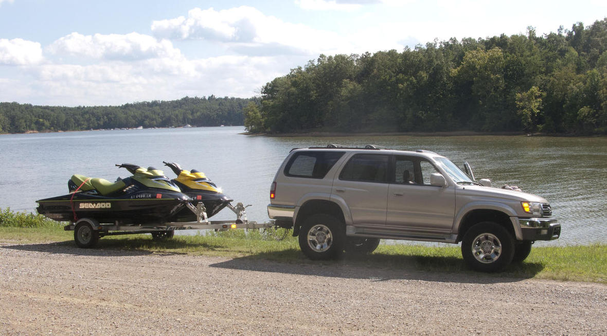

I have the 1.2 and tow two skis about 90 miles round trip in the summer. I have no complaints or regrets. I also DD it to work and back around 40-50 miles a day. The only thing people say is how high the back is compared to the front. But I do plan on adding a bumper.
