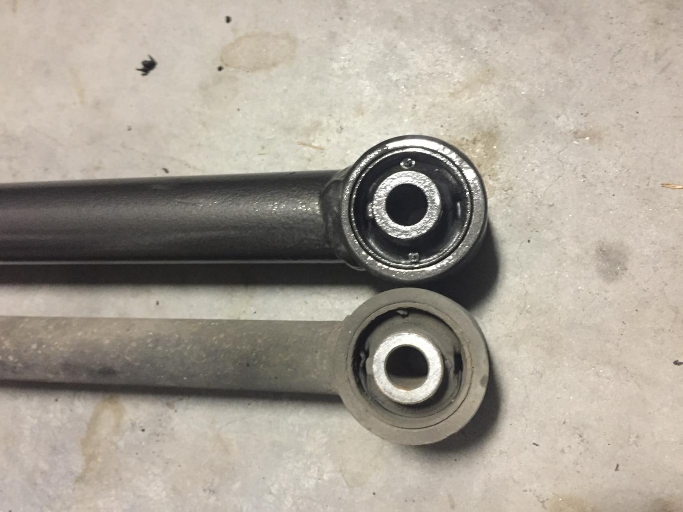

I am now post install and test drive with Sonoran Steel's rear lower links and replacement rear upper bushings.
--easy job, did this in my garage with all 4 tires on the ground, one link at a time
--I cleaned up the upper links and repainted
--both my upper and lower link bushings looked good but they were pretty soft
--needed a ratchet strap to get the lowers back in
--initial thoughts with driving around town (no wheeling yet), back end is noticeably tighter
--it is worth noting last December I installed some other gear from Steve to include an adjustable panhard bar, Tokico shocks and OME 861s...
--BL, I am happy with this mod and would recommend it, if you have any questions Steve has great customer service, just call him

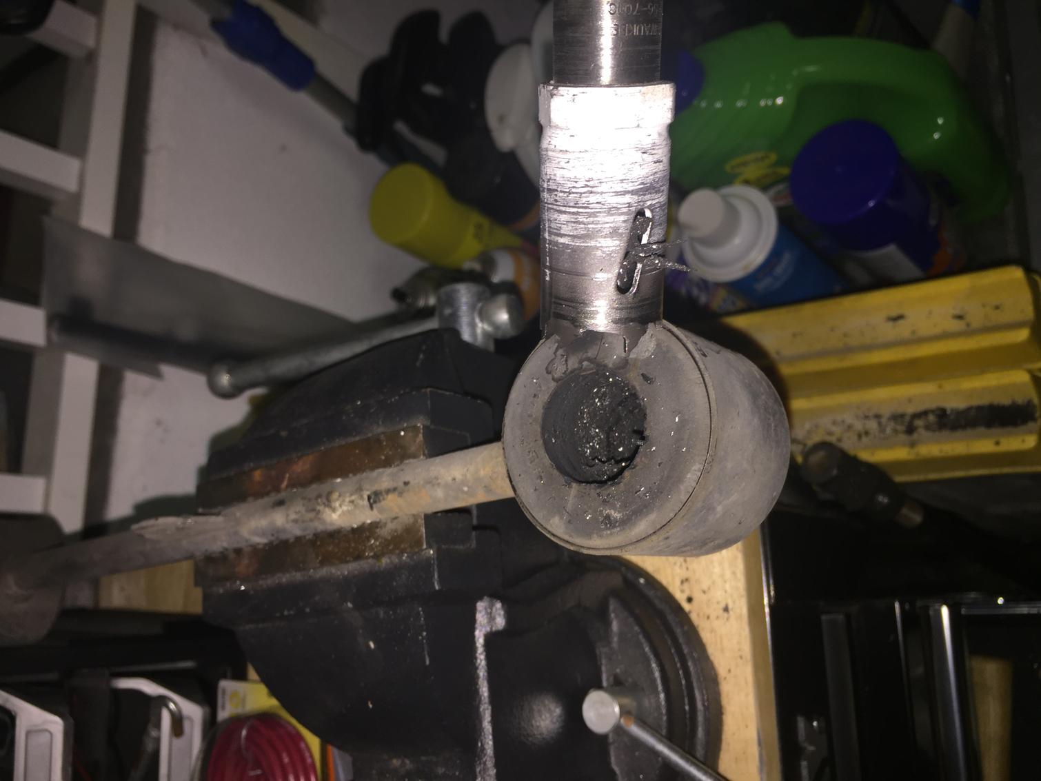

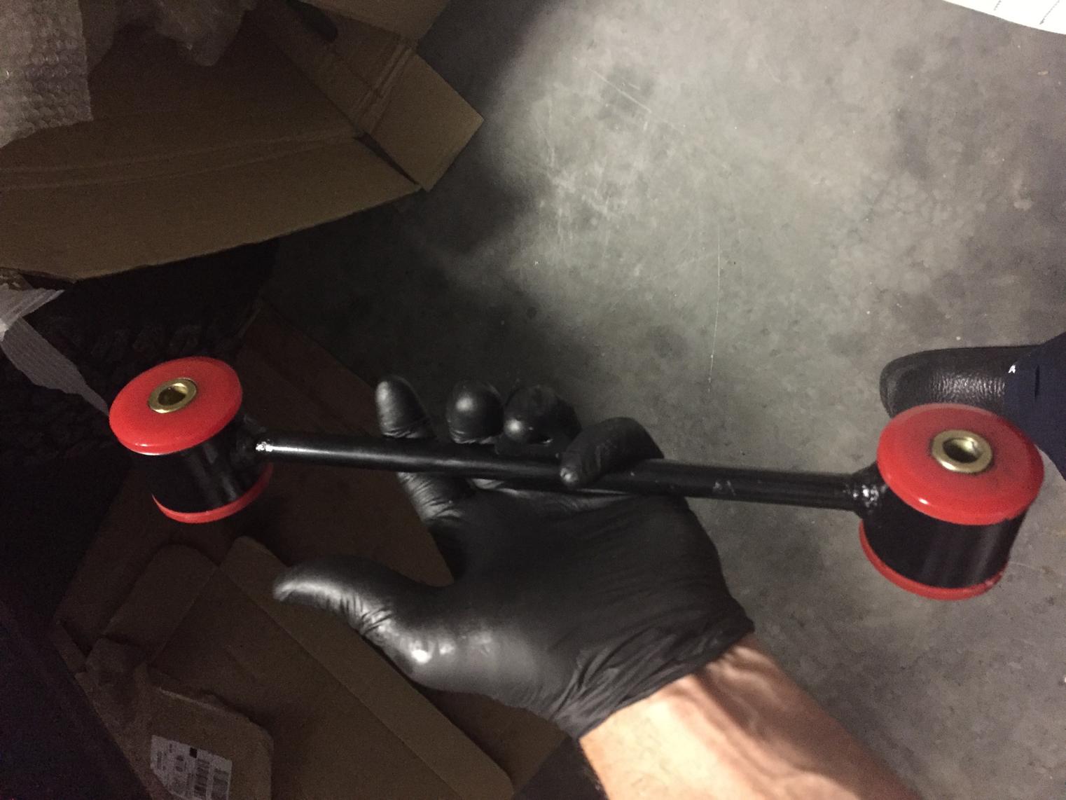

I have the SS lower links for 10 years, still holding up great.
A few years ago I figured its probably time to replace the original uppers. I found something from Amazon, i think they were like $14 each or something... surprisingly inexpensive (complete upper, not just bushings). So far so good, time will tell how they hold up.
