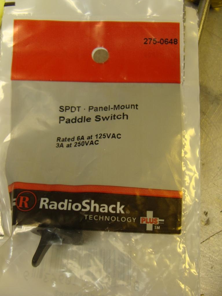

Radio Shack Paddle Switch (about $7)
Also need: some speaker wire, small zip/wire ties, and shrink wrap

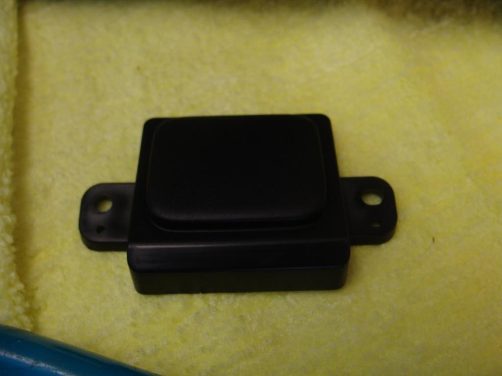

Here’s the switch we both used for this mod:

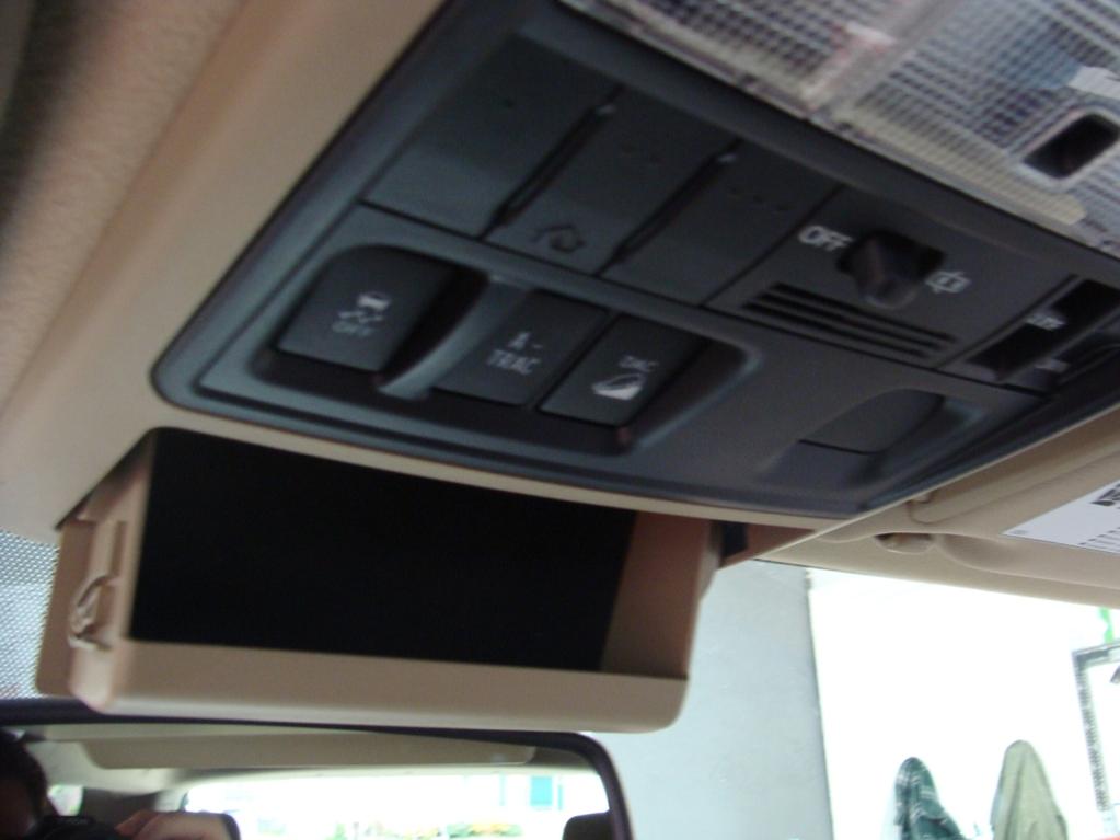

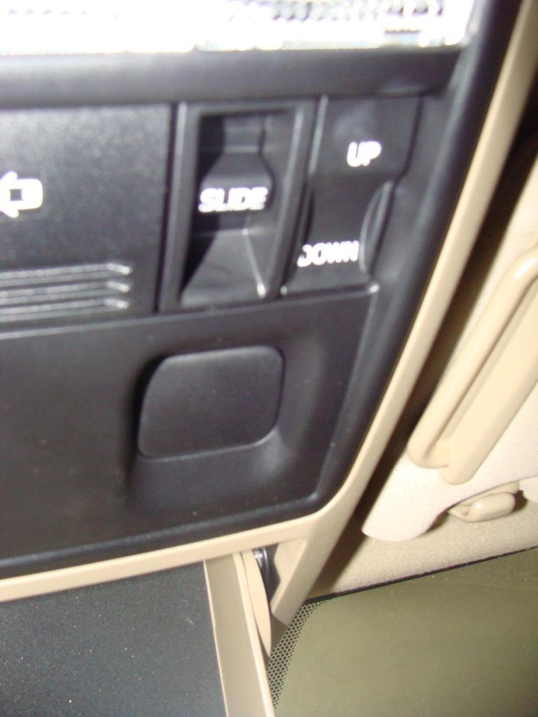

Identify your overhead console. It looks like this if you have an SR5 (Trails and Limiteds may have different buttons and whatnot):
If you have an SR5 like mine (and Antman’s), you have a “blank” on the passenger side of the overhead console. That’s where we mounted our switch.

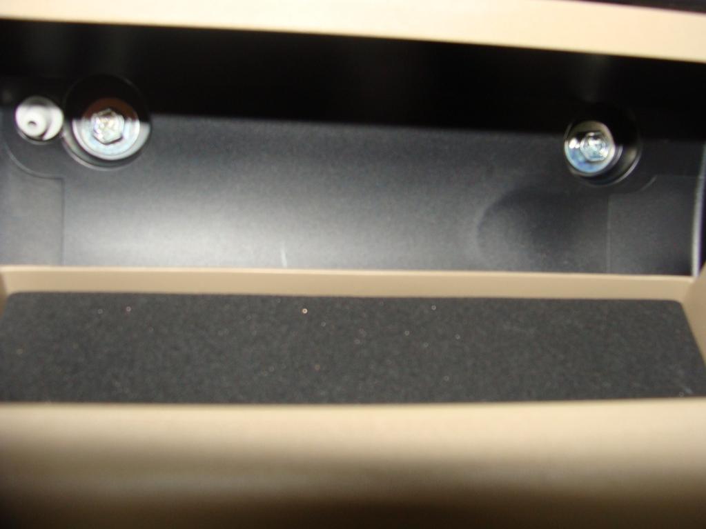

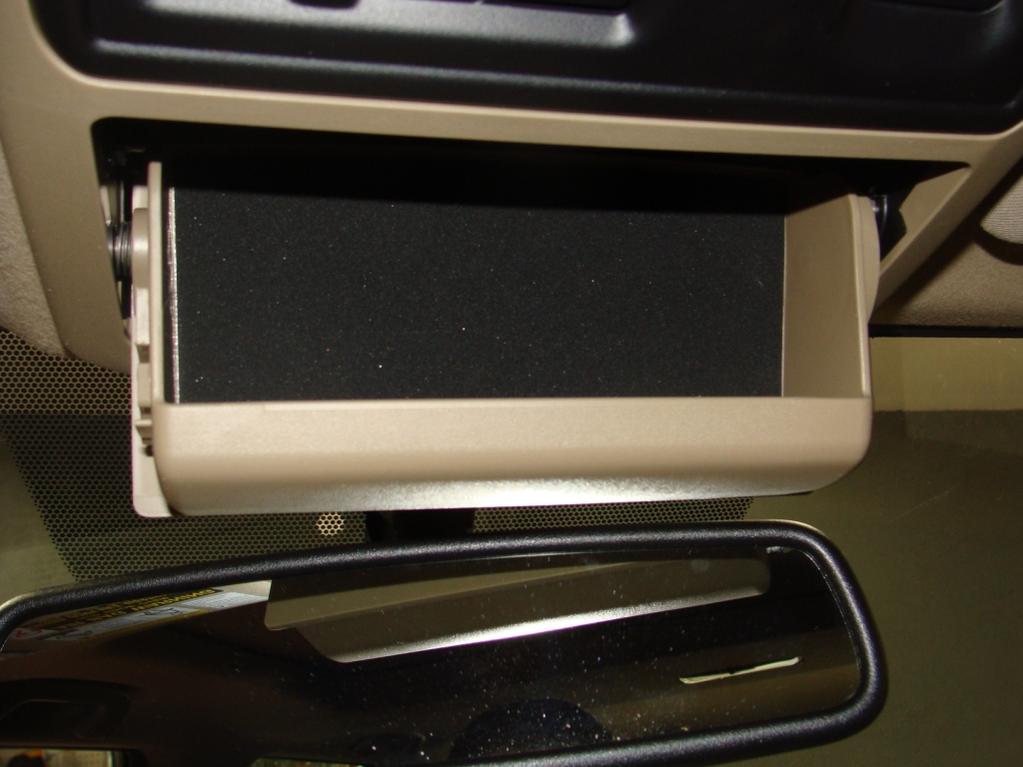

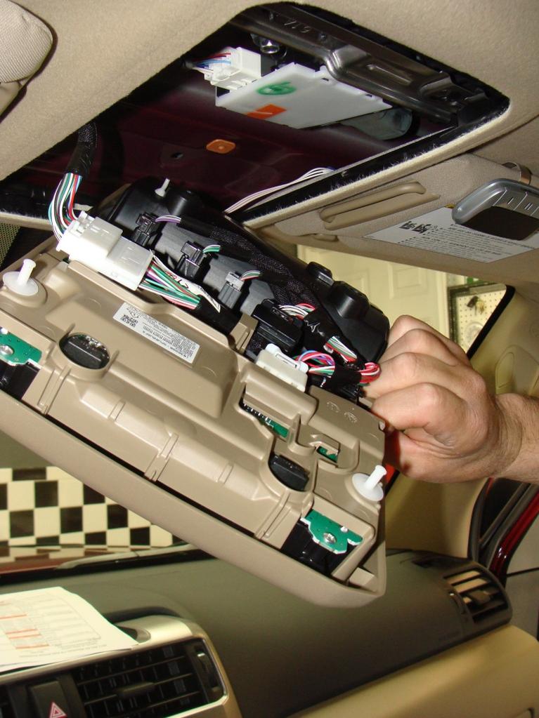

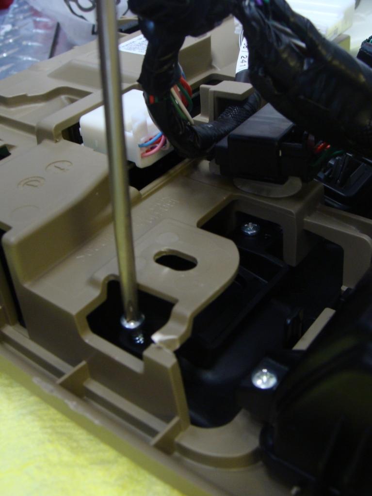

Lower the sunglass holder compartment thingy. There will be two screws in there that hold the console to the roof.
Once those screws are removed, you can just pull down on the console and it will pop out. See that white wiring harness on the driver’s side? You have to disconnect that to completely remove the console.

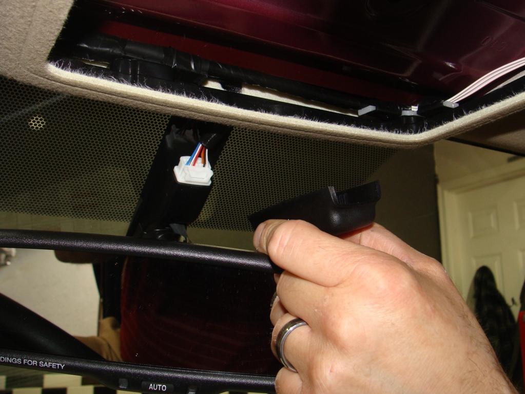

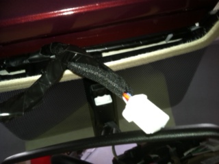

Pop off this plastic cover between your rearview mirror and headliner/console.

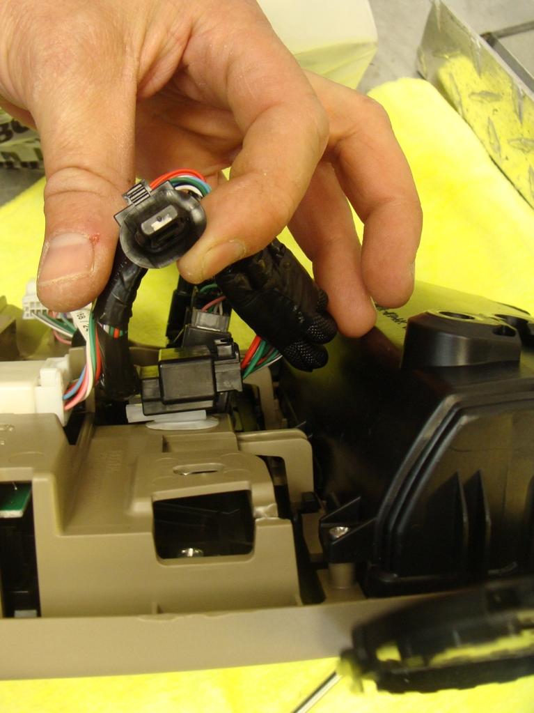

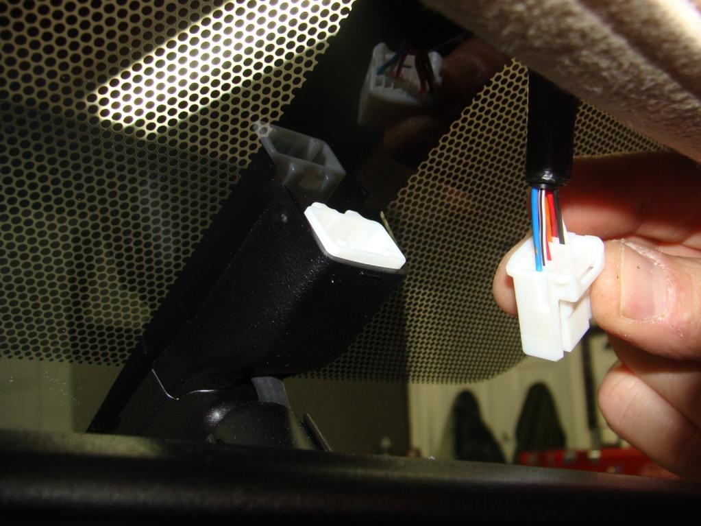

Disconnect the white connector that runs between the mirror and the overhead console.

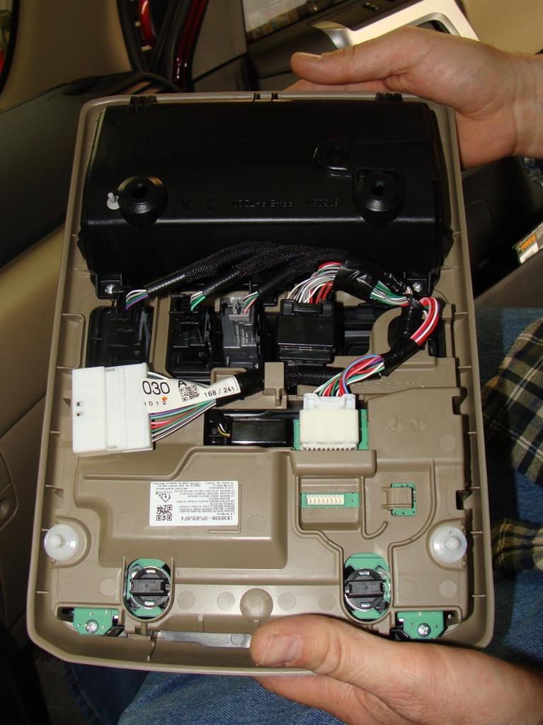

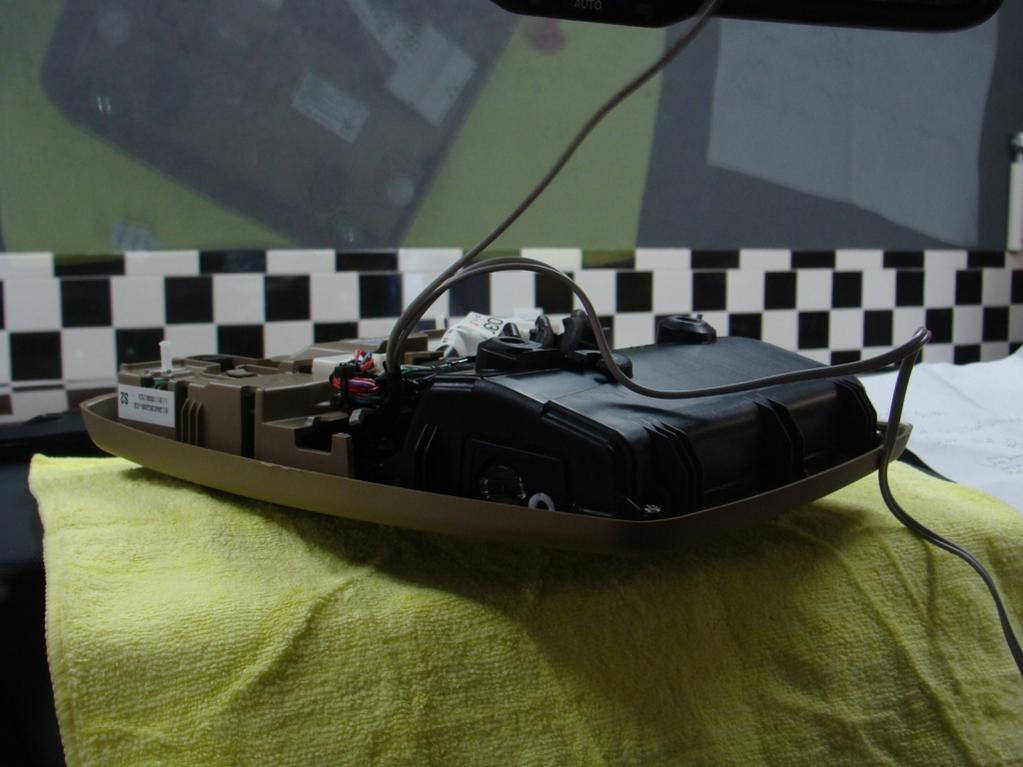

Wrestle that white connector (that you disconnected from the mirror in the previous step) between the windshield and the headliner, pushing it back into the space vacated by the overhead console.
Put down a shop towel or rag to protect the “cabin” side of your console, and place the console on top of this towel, with the electronics facing up. The inside of your overhead console looks like this:

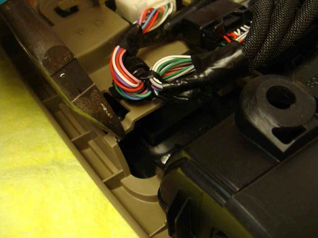

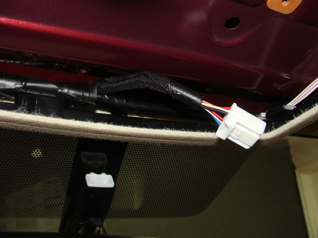

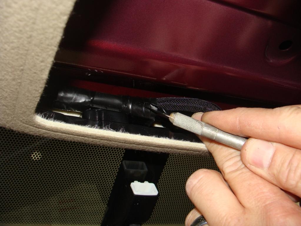

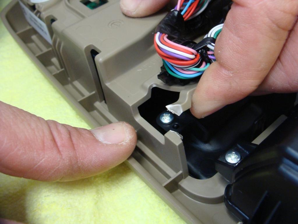

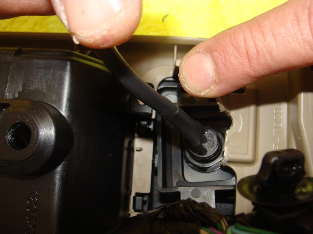

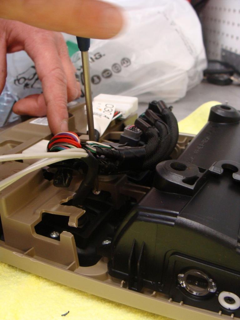

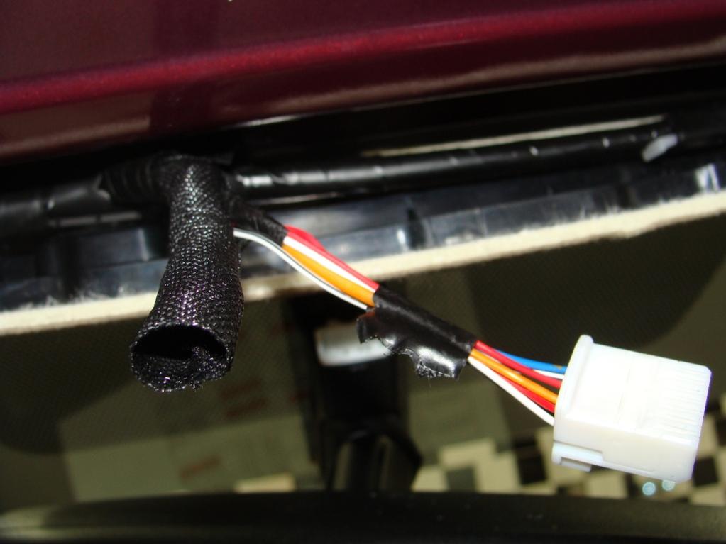

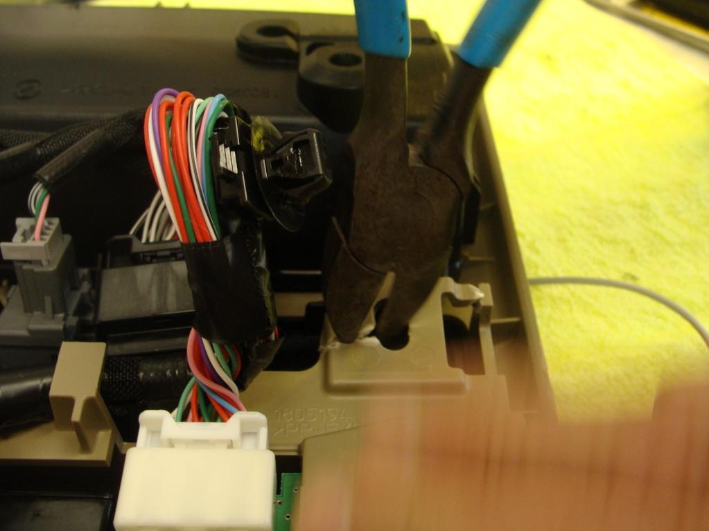

Immediately above the “blank” is this bundle of wires. They’re tied together and snapped into a hole right above the blank.
Gently cut the small piece of plastic bridging from the side of the console to the plastic area to which that bundle of wires is clipped.
Pop out that bundle of wires snapped into the plastic.

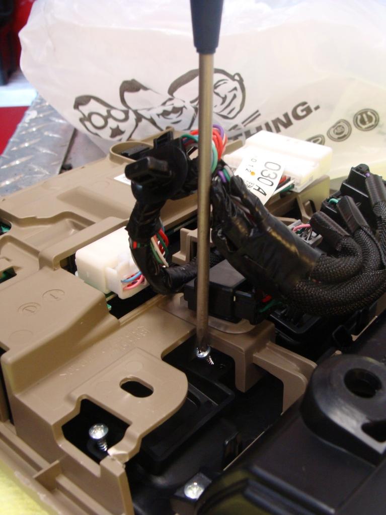

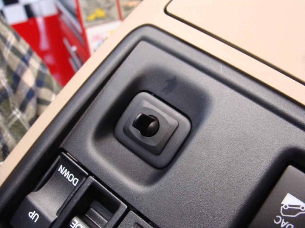

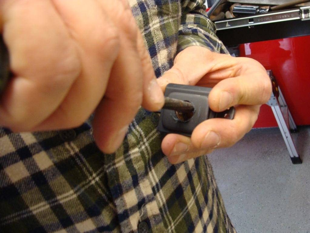

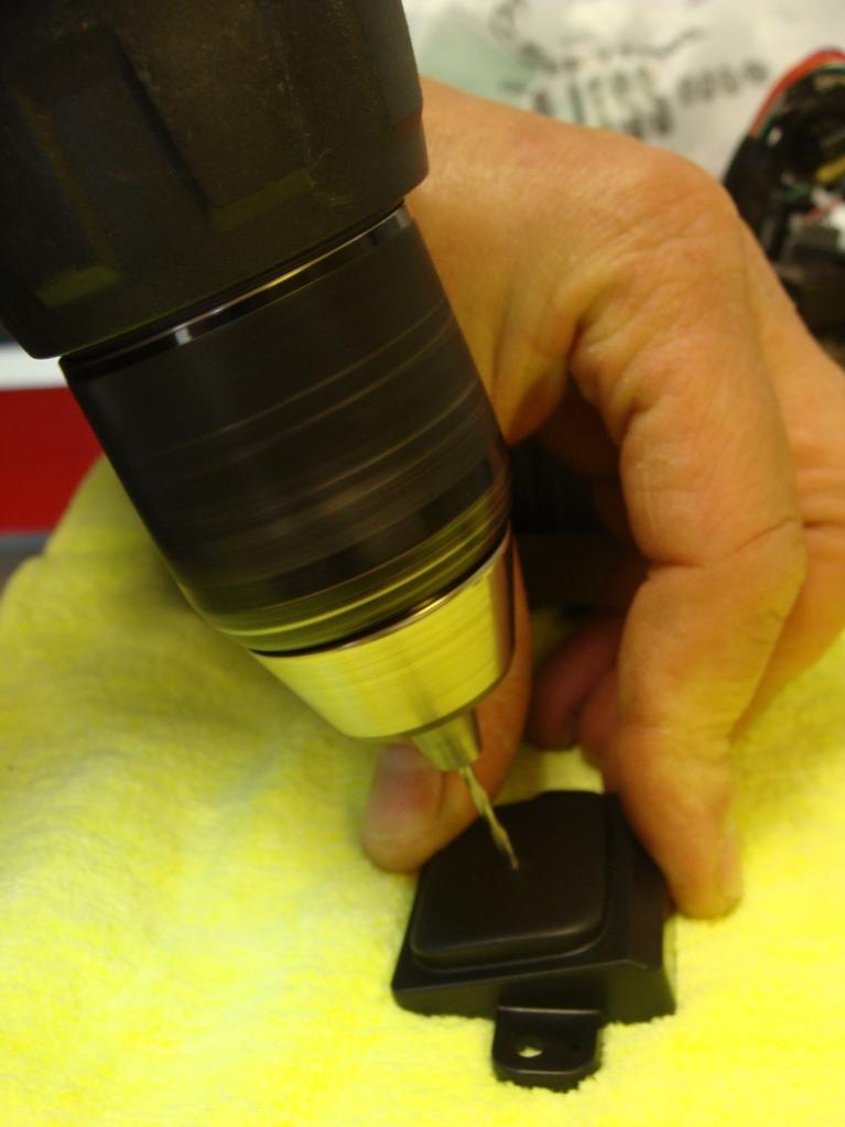

With a long, thin screwdriver, unscrew the two screws that hold the “blank” in place, and remove the blank!

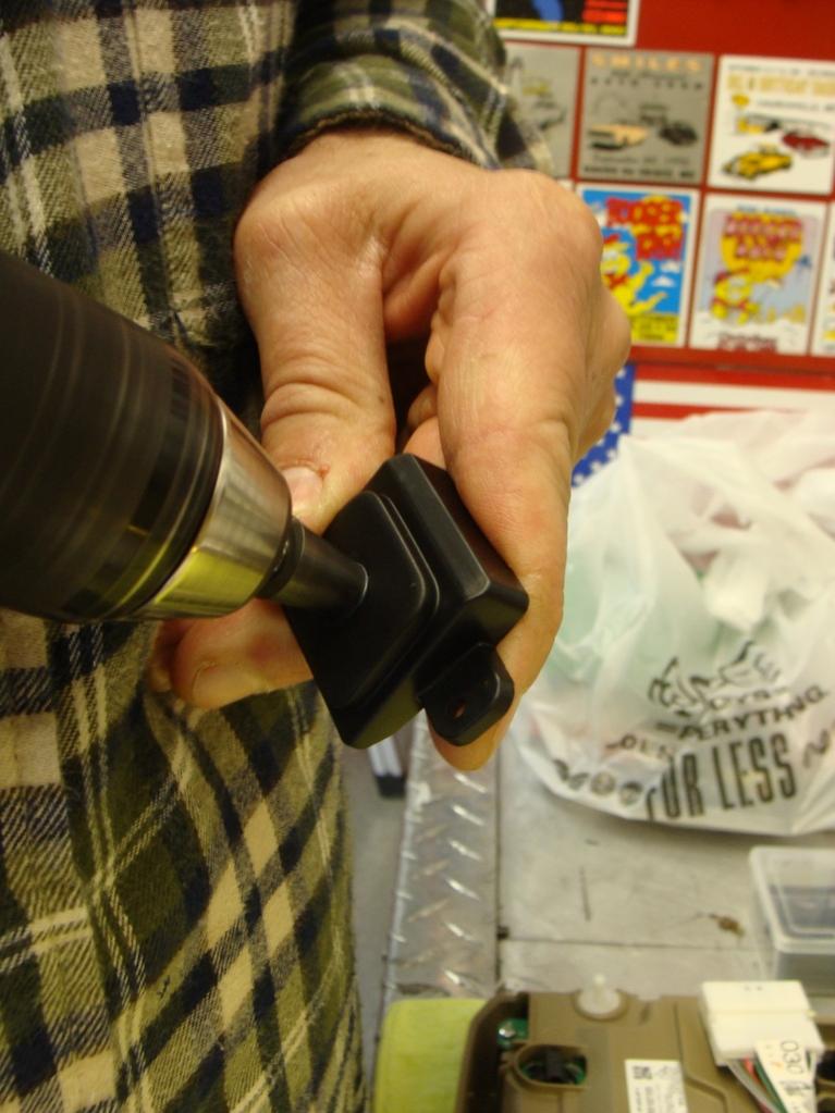

Mark the center of the blank, and drill a pilot hole.
(Warning: Sp8ball is not responsible for your safety if you attempt this mod and do something unsafe or stupid and mutilate your fingers…)

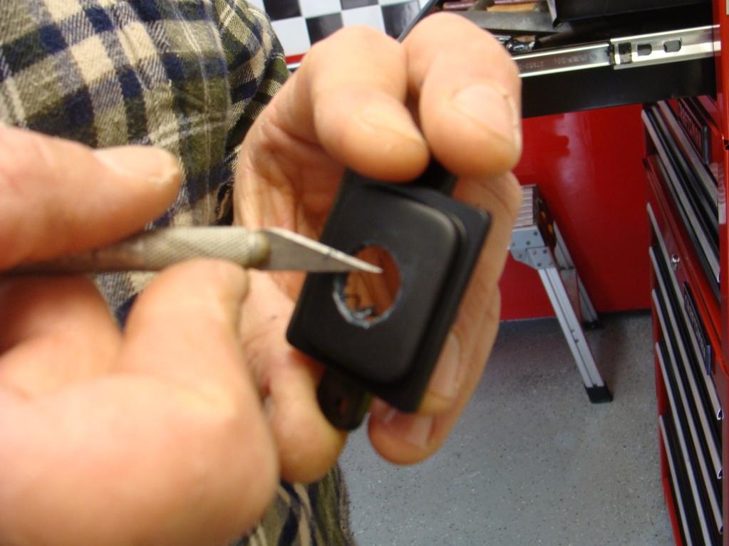

Use that pilot hole to center and drill a hole of identical size to your switch. (Warning: Again, sp8ball is not responsible for your safety if you attempt this mod and do something unsafe and mutilate your fingers…like holding something you’re drilling like this)
We used a round file and an exacto knife to file the hole to the correct size and deburr the edges of the hole. We were shooting for it to be tight enough to be snug (no squeaking down the road!), but didn’t want it to be so tight that we had to screw it on.
Please don’t cut yourself.

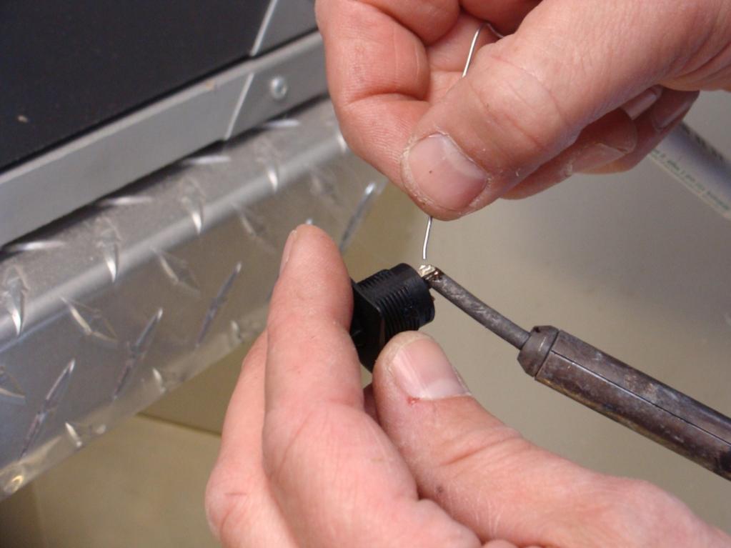

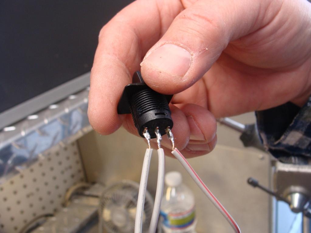

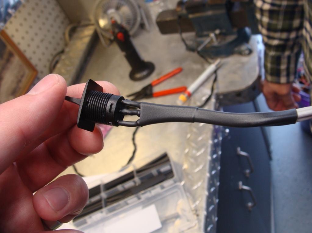

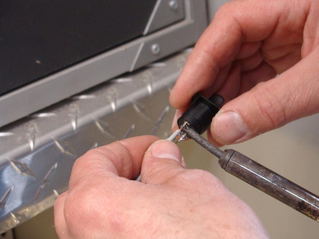

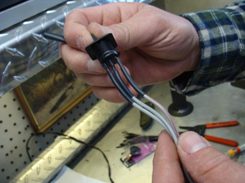

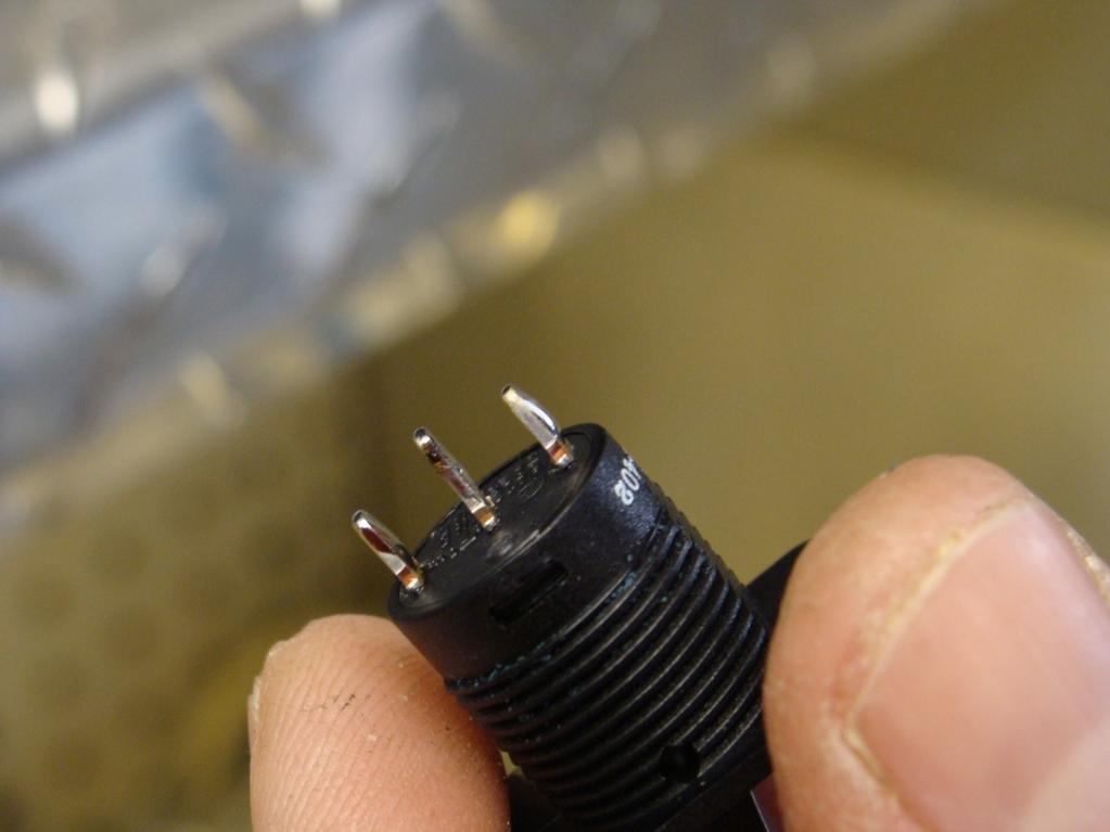

We added some solder to the ends of all three switch poles.
Then we pulled out Antman’s “Giant Tub O’ Wire” to get some wire to connect the three poles on the switch to the three wires in the console into which we need to tap.
We elected to use one two-wire bit of speaker wire, and one single-wire. This also helped us keep track of which wire did what.

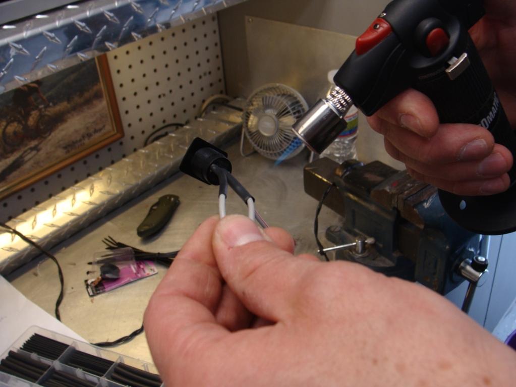

Then we soldered the wires to the posts, and (of course) shrink wrapped them for excellence.

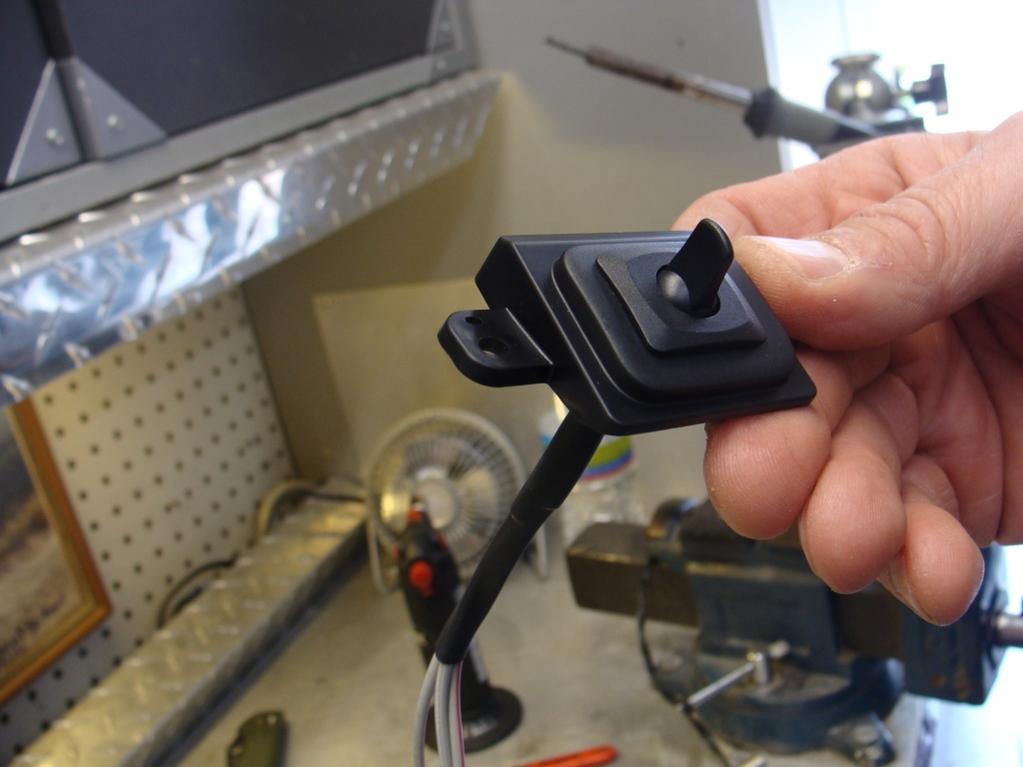

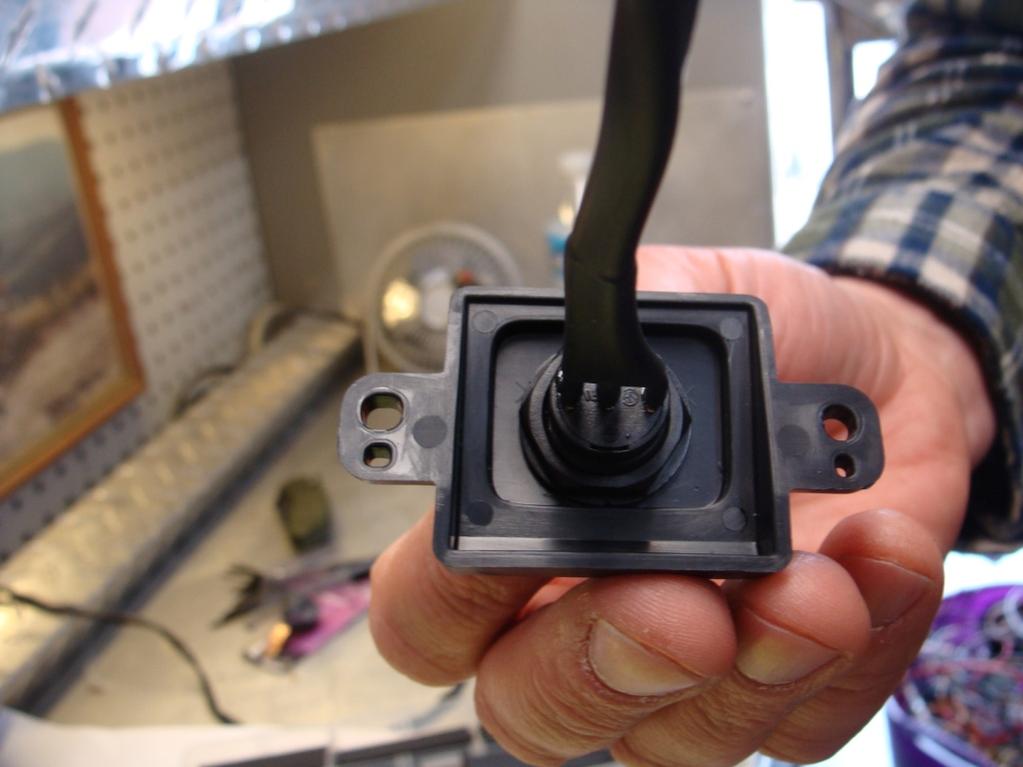

Here’s the completed switch assembly, with wires.

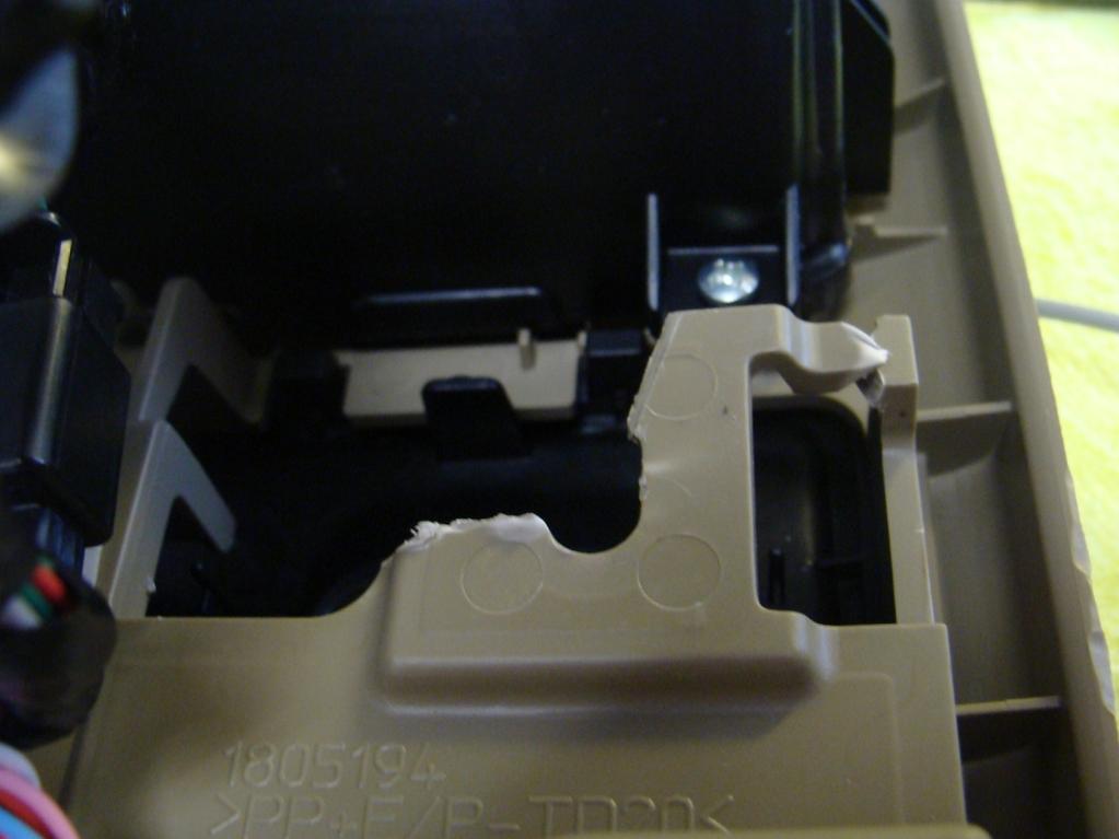

But wait! That wiring and deep back of the switch assembly won’t allow it to fit back where it was! The horror!
So…you have to trim that plastic piece a bit more…
Gently pull up on the remaining plastic “tab” that’s left behind, and it will now fit.

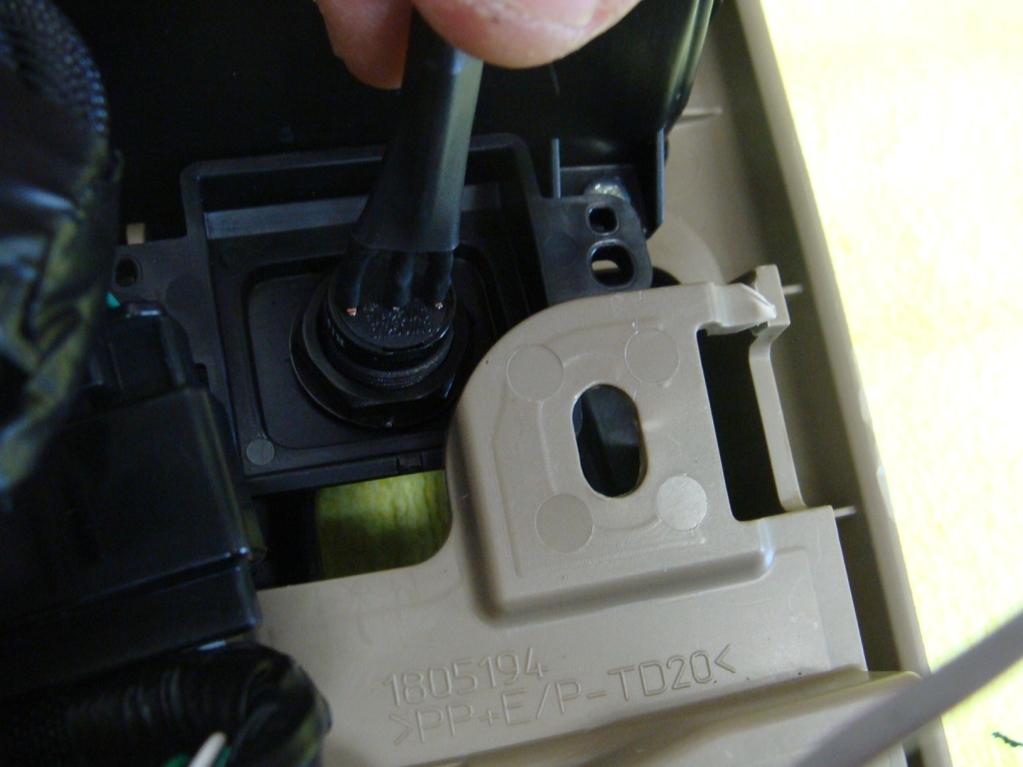

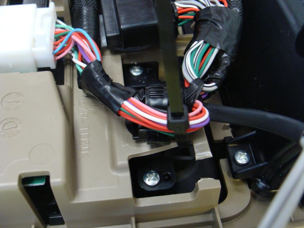

Screw the blank back in place.
And then semi-snap the wire bundle back to where it originally went, and use a small zip tie to secure it.

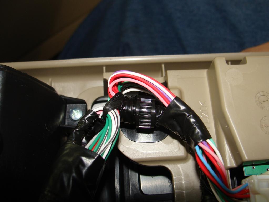

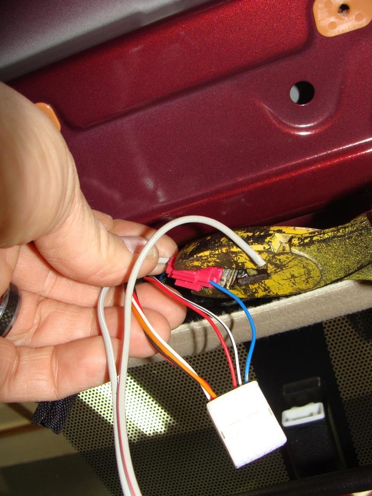

OK…the console work is done, and you just have to do the wiring. Back to the truck! Put the overhead console on the dash, and hopefully you have enough slack in your wires to reach to the overhead area.
Climb in and find that wire bundle that was pushed into the console space between the headliner and windshield.
Take the plastic electrical tape and gently cut it away to free the wires.

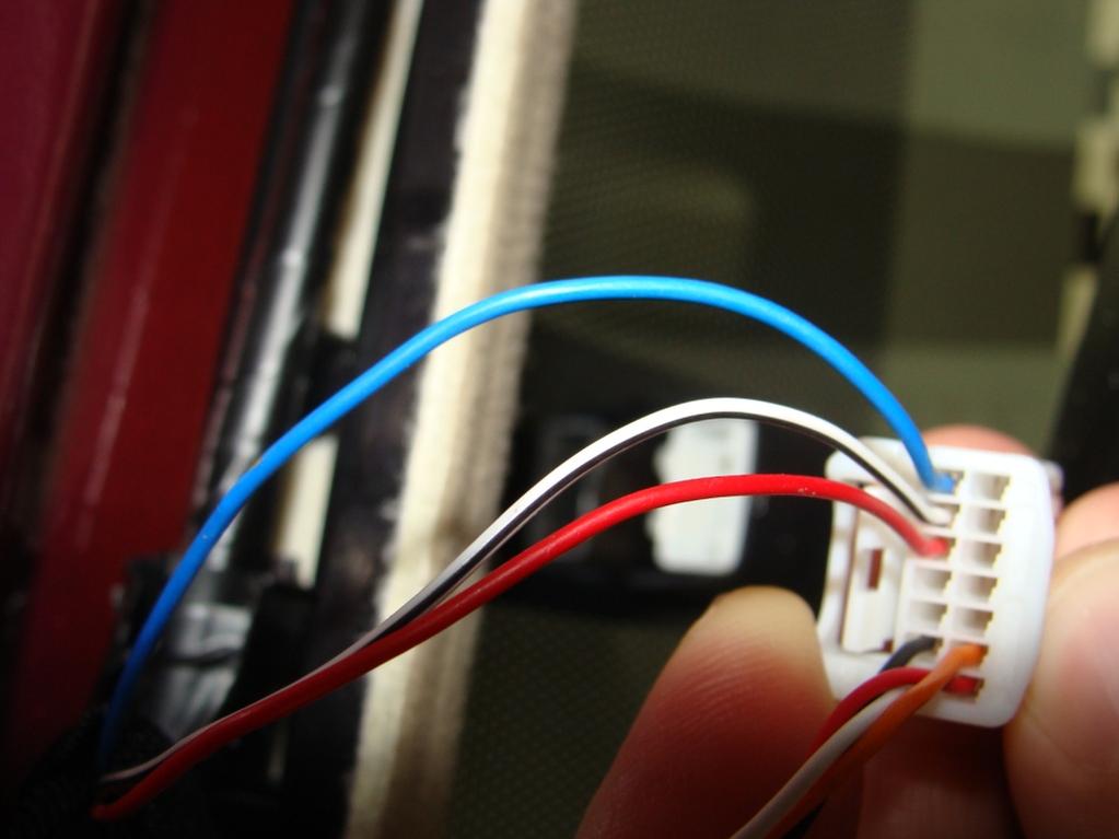

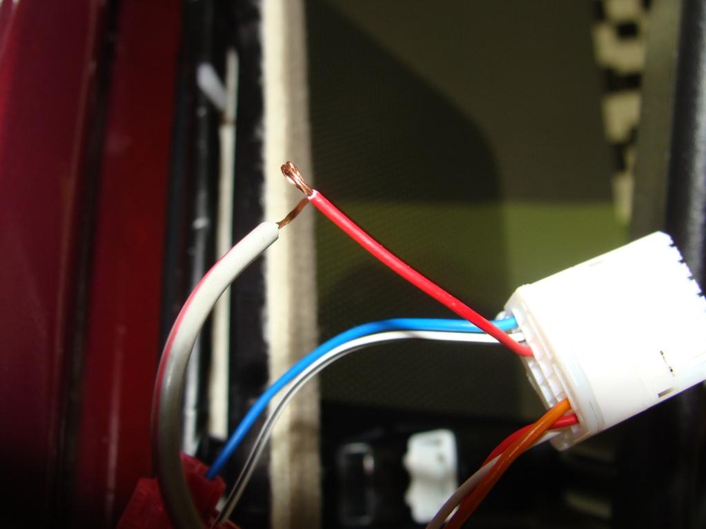

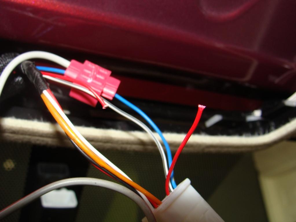

Isolate these red, white, and blue wires (“on the clip side”) - the red and blue wires are the ones we’re going to be tapping into during this mod.
Tap your wire from Post 1 on your switch to the blue wire in the overhead connection.
Cut the red wire. (ulp!)
Added July 2011: Now that you've cut the red wire - and for the sake of clarity - GO TO THIS POST AND READ IT.
The “clip side” of the red wire gets connected to Post #2 on the switch. The “harness” side of the red wire gets connected to Post #3 on the switch.

Once you have secure connections, put electrical tape over them and then re-wrap them as best as you can with the factory wrap. We didn't use shrink wrap, because we didn't want to use the torch near the headliner.

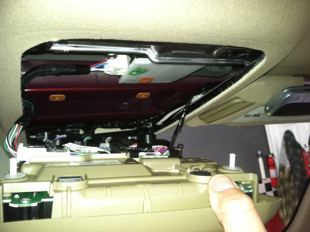

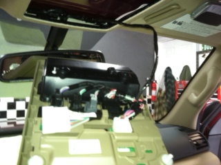

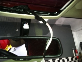

(note: my camera died during the mod, so these smaller pics are from Antman’s phone!)
Push the wire bundle back between the headliner and windshield, towards the mirror. Plug the connector back into the mirror.
We wrapped the whole entirety of the speaker wires in electrical tape to protect it and make it look nice. Then we tucked it into the headliner space as we raised the console into position.
Snap the console back into place, and re-secure the console with the two screws in the sunglass area. Fire up the truck, and flip on your switch.
