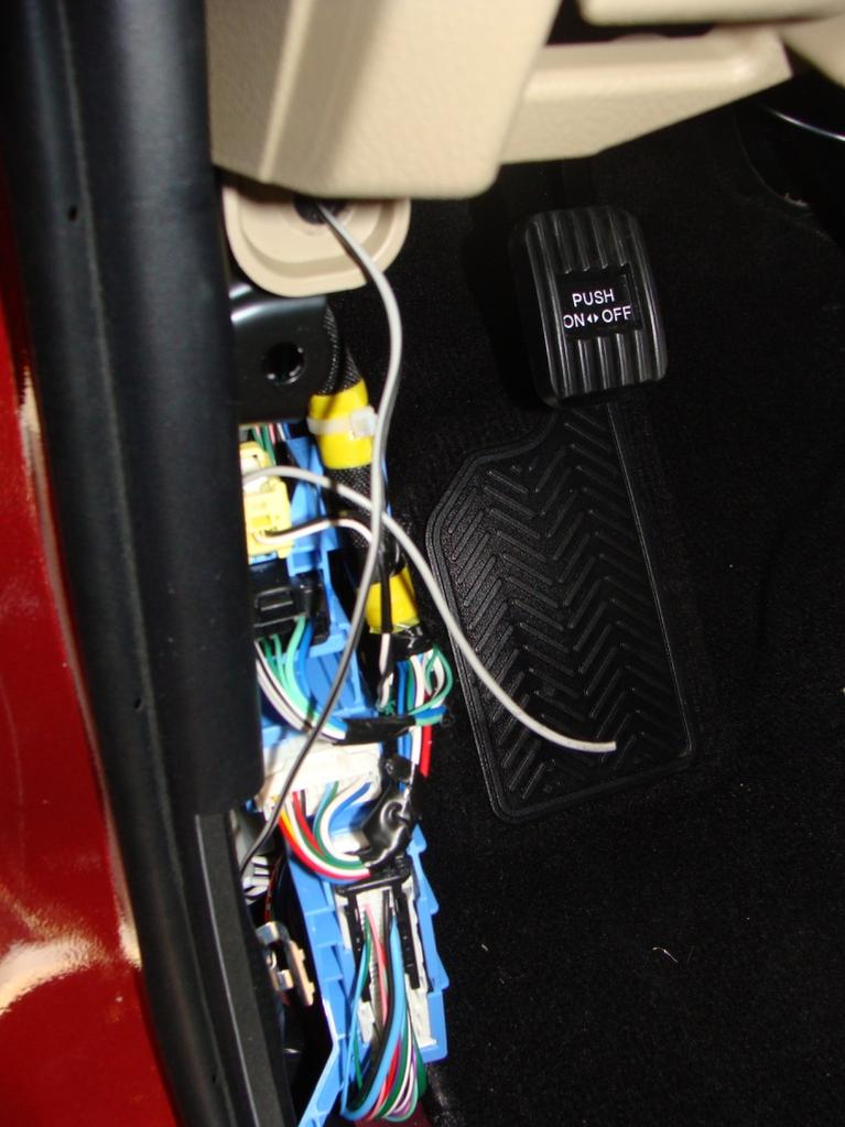

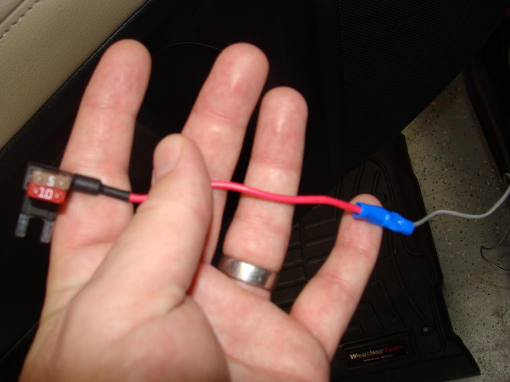

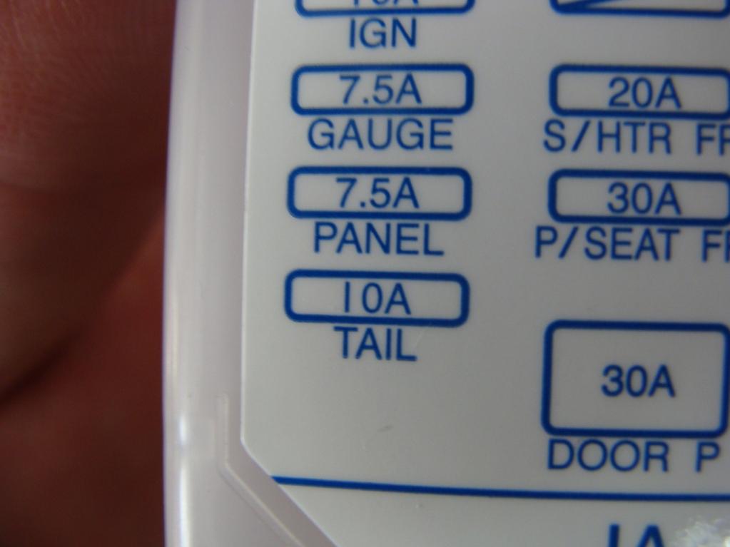

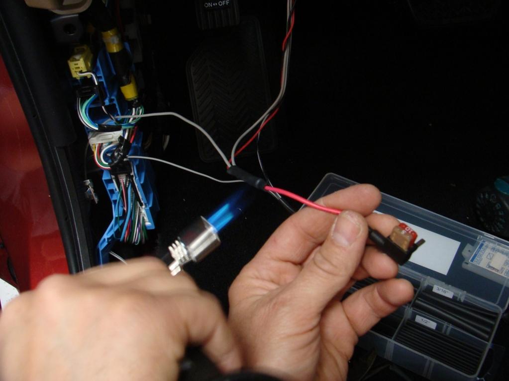

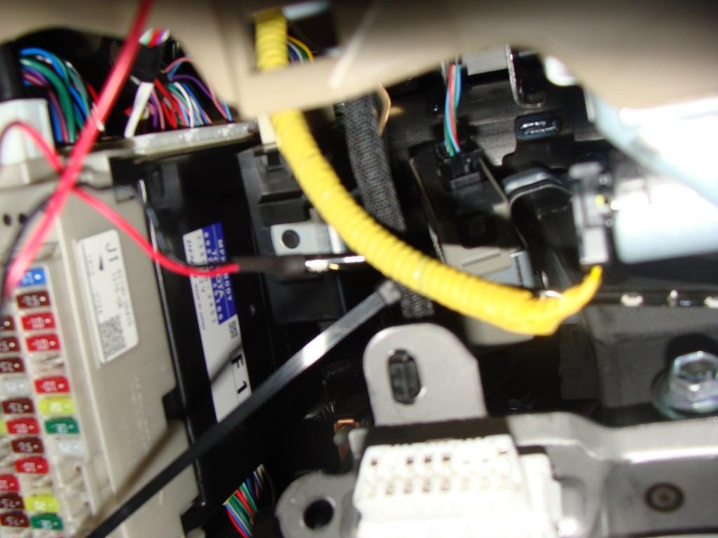

Get yourself an “Add-a-circuit” type connector to plug into your fuse and add another circuit.

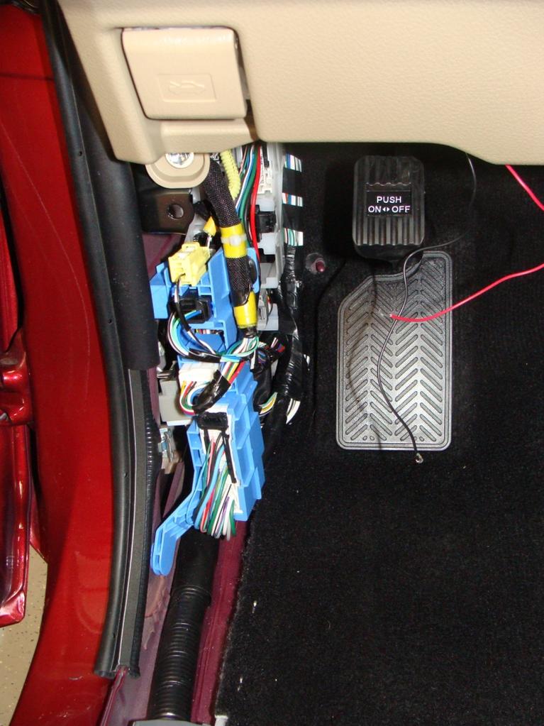

We wanted to have the accent lights only come on when the headlights were on, so we checked out the fuse box cover to get the lay of the land.
We decided to tap into the “Tails” fuse, because those only come on when the Parking or Head lights are on, which is what we wanted to do. And it has a 10A capacity, which fits with what our Add-a-circuit could handle.
It should be noted that you can’t use your fuse box cover anymore once you connect the Add-a-Circuit.
IMPORTANT: See that yellow-wrapped wire. Don’t mess with those. Don’t tie anything to them. Don’t cut them or work too harshly around them – they are your airbag wires.

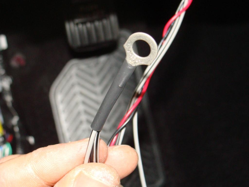

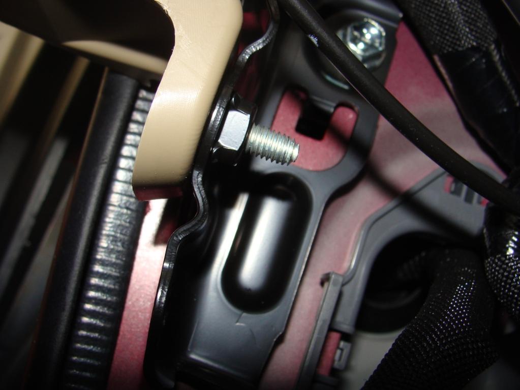

You will need a ground for your lights. The next two steps walk through using the location we identified for our ground.

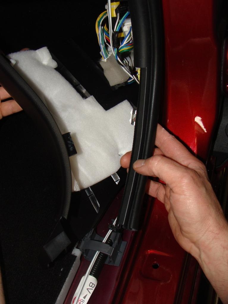

Remove the cover (mine was tan in color) by your left ankle (driver’s side). You first need to remove this fastener by unscrewing it from the back of the housing.
Those red and black wires in the right of the picture are coming from the LED strips which are just hanging there as a "fit test", which are on the underside of the dash equipment (more on that later).

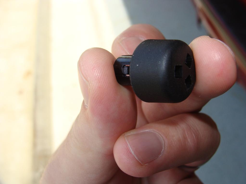

Also, see this piece of weatherstripping? Leave the metal clip on it. When you go to put that front piece back on, clip the molding/trim piece to the weatherstripping clip first, and then snap and secure the molding back onto the car. (this is the passenger side, but it’s the same on both sides)
You’ll see this bolt behind the housing. This is where we mounted our ground. (more on that later)

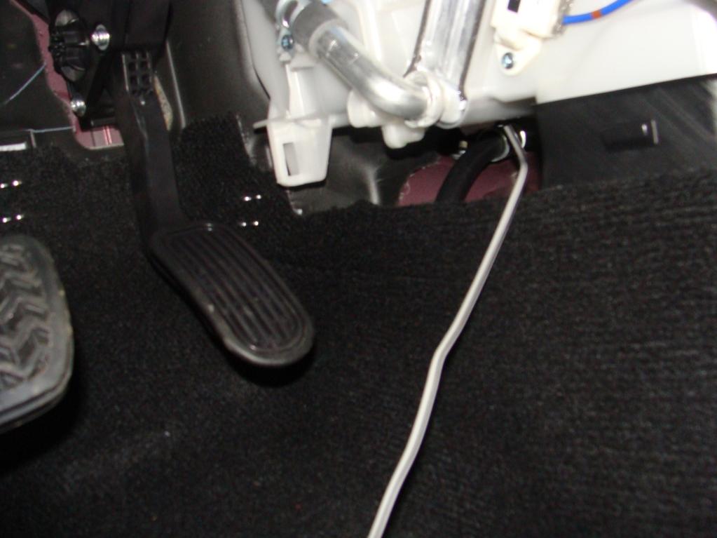

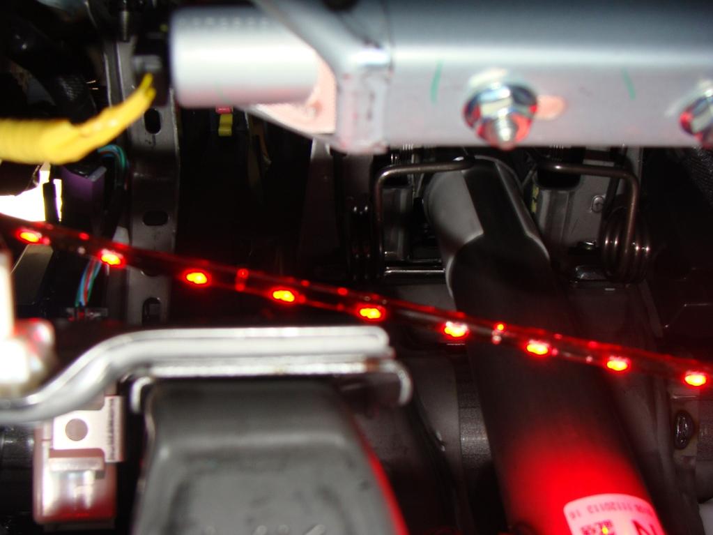

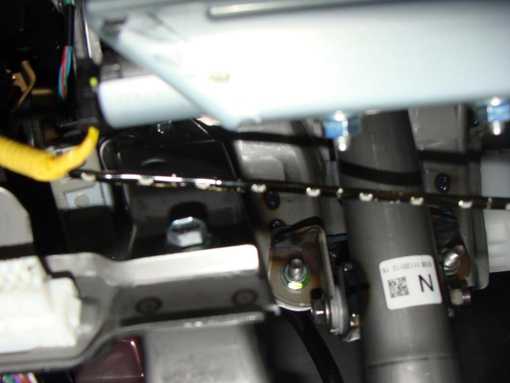

Figure out where you want to mount the first LED strip under the driver’s side of the console. Keep it free from your feet, and elevated to avoid inadvertently ripping it down when you get in the car or while you’re driving. Remember that this is accent lighting, so it can go way up in the dash and still be effective. One other thing: we noticed that the LEDs run down a side of the strip, not down the middle. So be sure that the LEDs are on the side of the strip that faces in the right direction for your tastes.
Loosely wire the LED strip to some speaker wire, and connect that wire to the fuse set-up and ground to test it out.

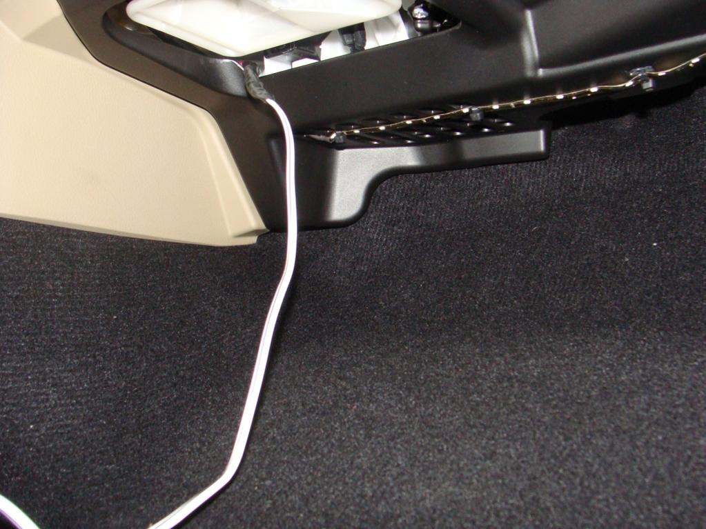

Once that works, you can start running wires from these connections to the other points where you want accent lighting in your car. I elected to put them in the first and second rows, which meant they went under the dash and under the front seats, respectively.

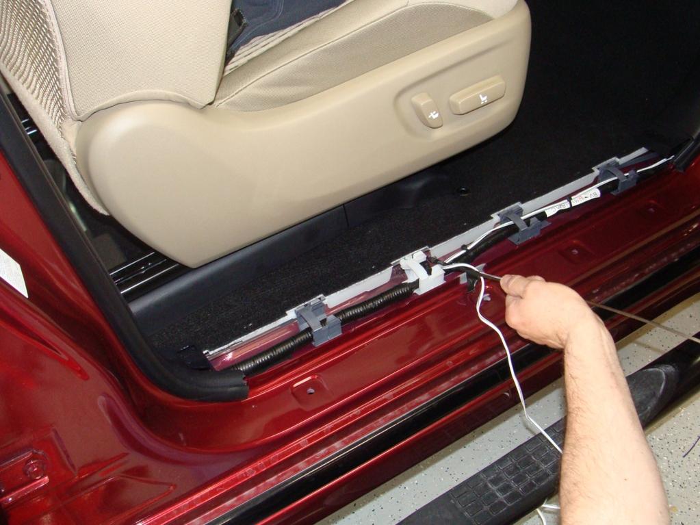

To route them to the bottoms of the front seats is pretty easy, and the coil structures under the seat make great mounting points.

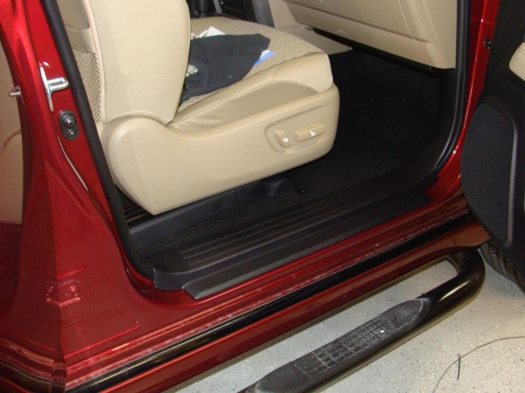

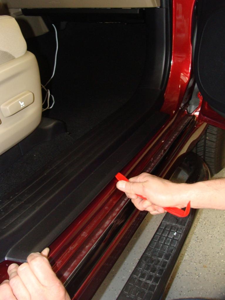

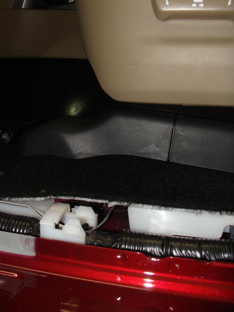

Remove this plastic sill plate –it just pops off. This is us doing the passenger side, but you get the point.

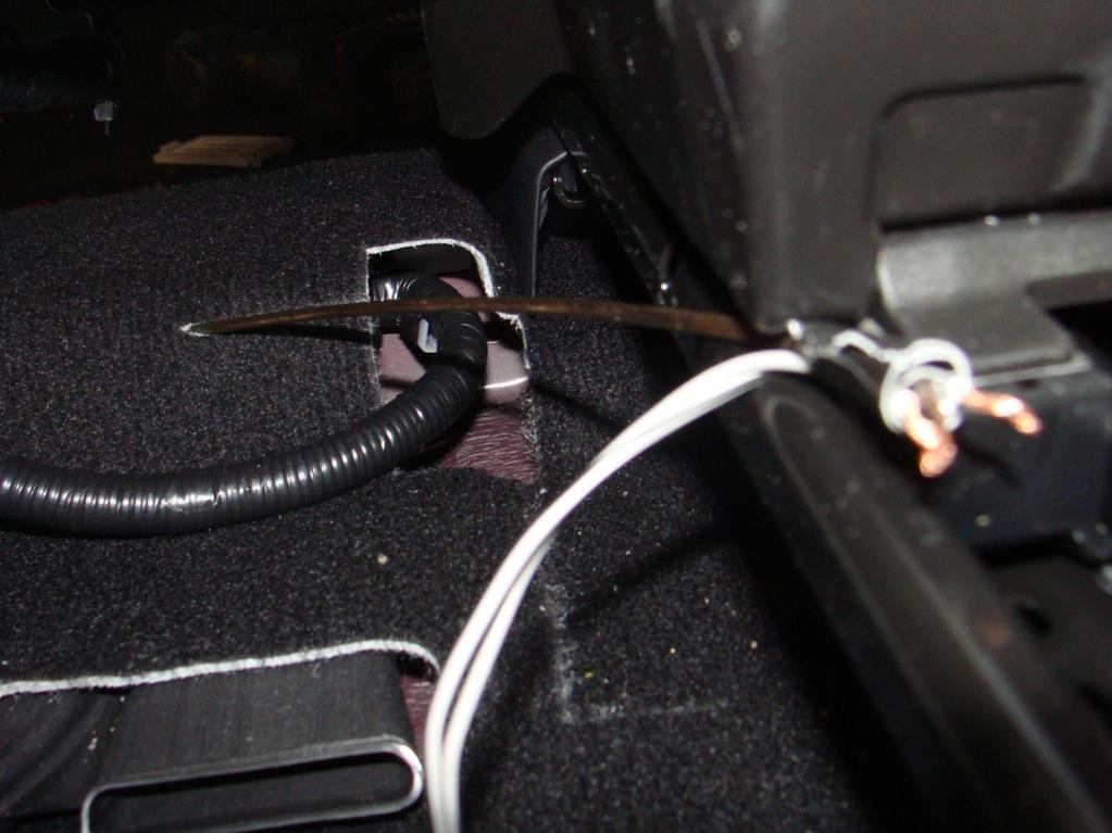

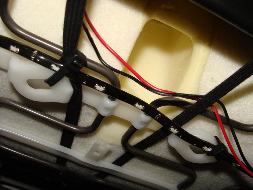

We attached the LED strip under the driver seat.
[Note: This picture is from the back seat on the driver’s side, looking forward in the car. See how the LEDs are on the far side of that strip? When we lit this up at night, the rear footwell on this side was dimmer than the passenger side, and there was light coming out from the driver’s seat towards the pedals. We ended up taking this strip out, flipping it around so the LEDs were facing TOWARDS the camera, and it was much better (i.e. brighter).]

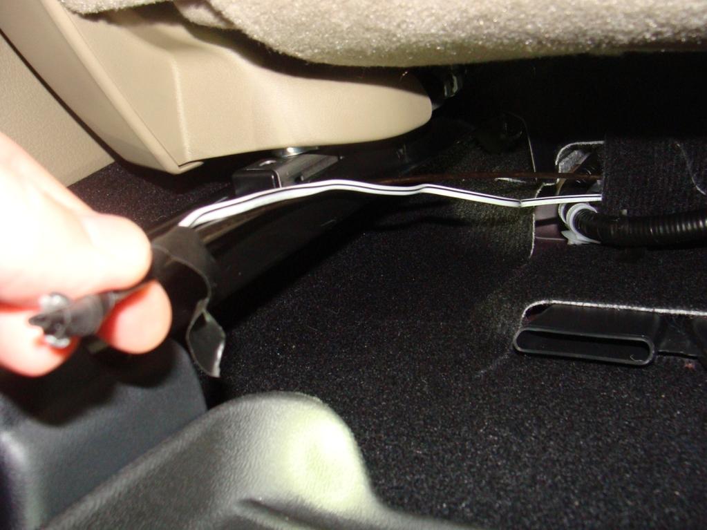

Fish the wire through from the side (you’ll see where in a couple of pictures).
Make sure you have a good bit of slack in the wire and hook it up to the LEDs. Secure with electrical tape or shrink wraps. Use this slack to secure the wire to the existing wire bundle, because that black bundle travels with the seat. Move your seat around and make sure there’s plenty of play in the wire.

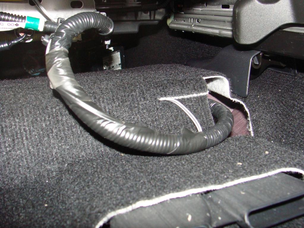

Here’s where the wire comes out under the (now removed) door sill. Route it down the channel back to the front of the car.

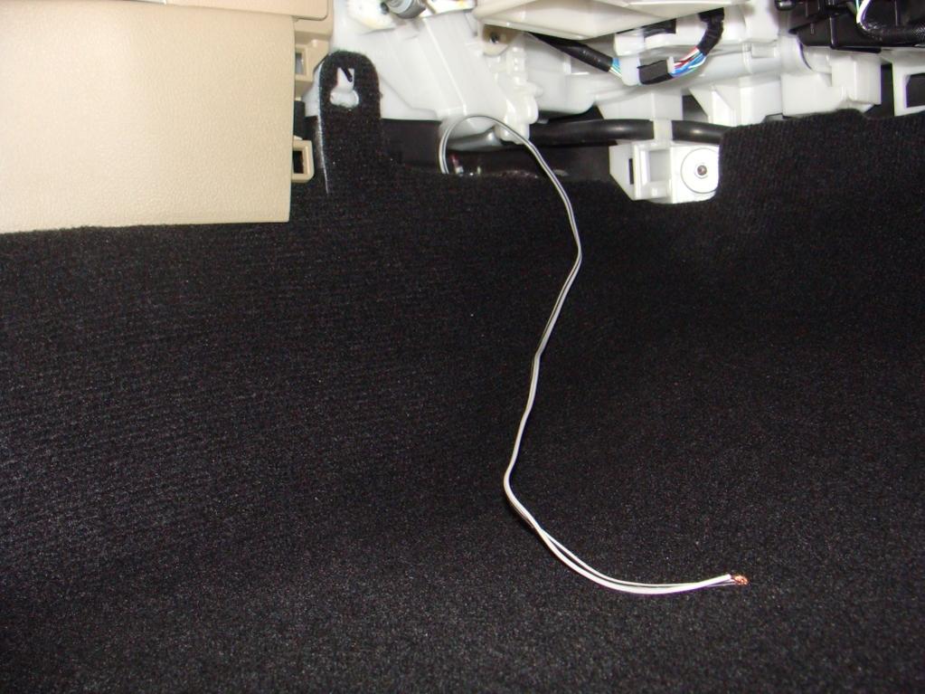

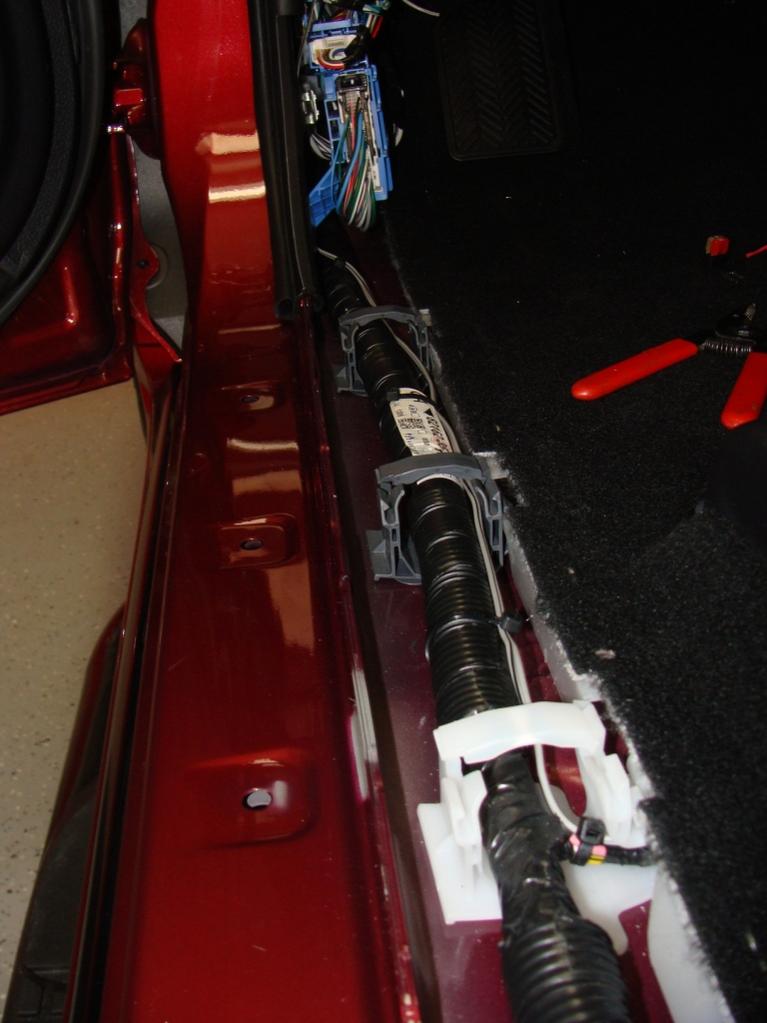

Route the wire behind this section with all the wires/connections, making sure you have enough wire left to attach it to your original LED connection (with the “add a circuit”). Cut any remaining wire.
Route another speaker/electrical wire from the driver’s side to the passenger’s side. There are small plastic trim pieces behind the center console that snap out where you can route it.

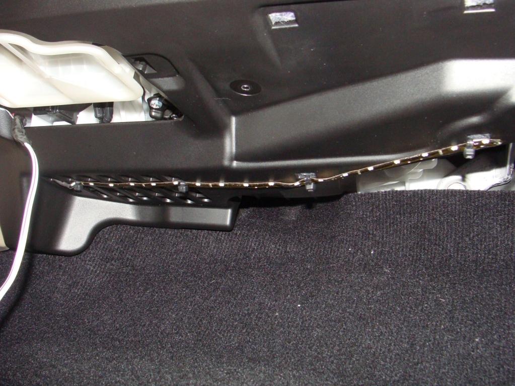

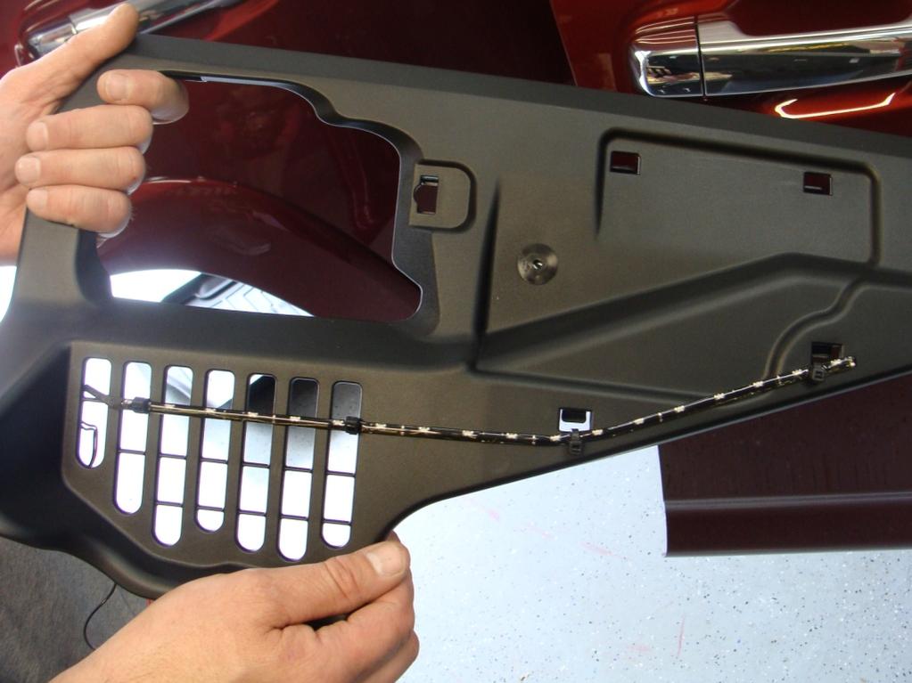

The entire bottom of the passenger-side dash (under the glove compartment) pops out, so you can take that off to more easily mount the LEDs. Just yank it down!
It should be noted that these particular strips have a silicone/gel feel to them, so they are particularly pliable. That makes the use of wire ties a pretty good option, because the ties dig into them (be gentle-ish) and grip them in place very well.
Then you pop the under-dash trim piece back in place and wire it to the wire you passed through the middle console earlier in this post. (If you’re doing rear footwell lights as well, add an additional wire (long) that will be routed to the underside of the passenger seat for the rear passenger-side footwells.)

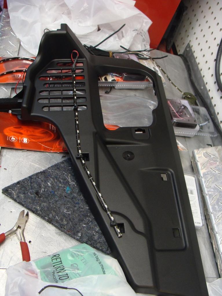

You now have three lights wired, with one to go (if you’re doing the rear footwells – if you’re just doing the fronts, you can skip this).
Your passenger-side footwell should look like this, with that wire being the wire that’s ready to go to the underside of the passenger seat:
You’re now done with all the wiring that will be connected to the fuse, so you can go ahead and finish that section off to get the “power” part of the wiring in place.

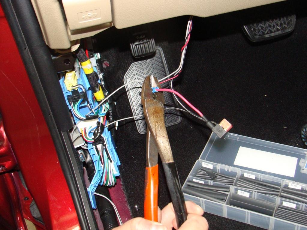

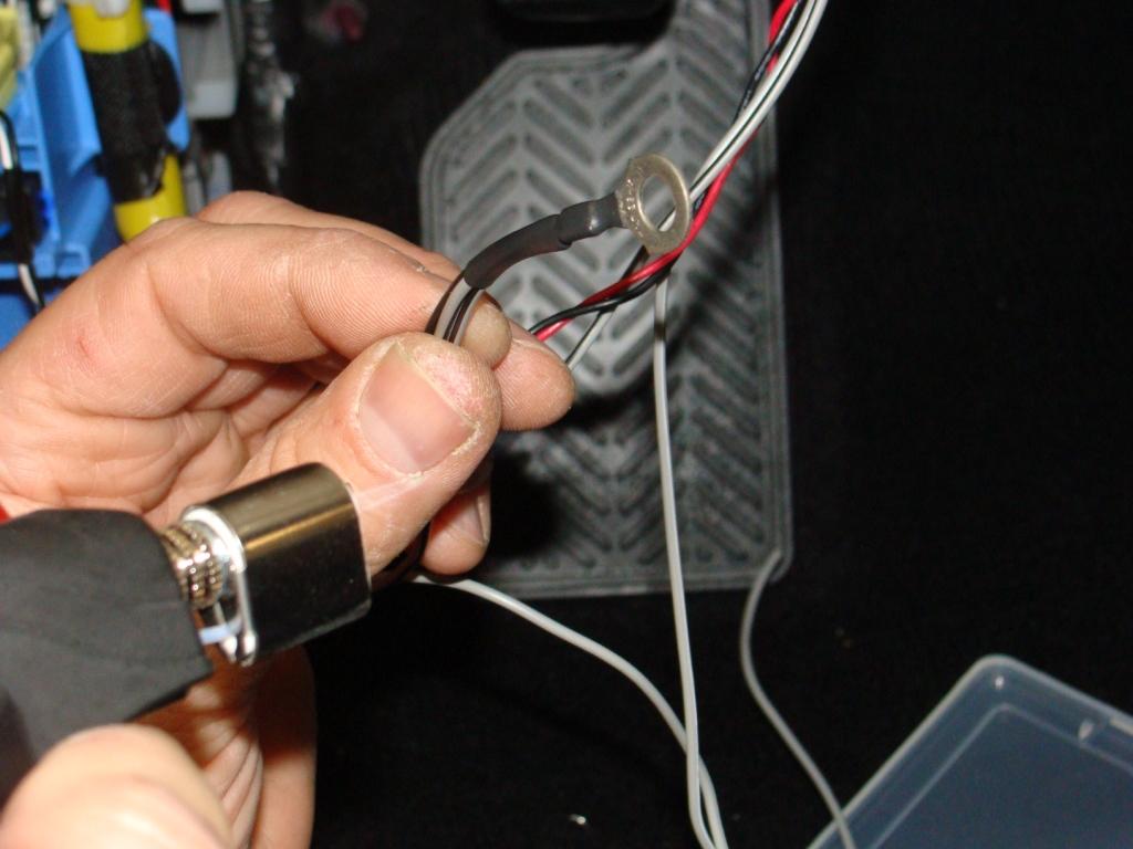

Find a good terminal connector that will fit under the nut in our previously identified mounting bolt. Connect your ground wires to it, and shrink wrap them to keep the connection tight and protected.
Wire all of your power wires together with a connector that will allow them to be connected to the “add-a-circuit”. We used this blue junction thingy.

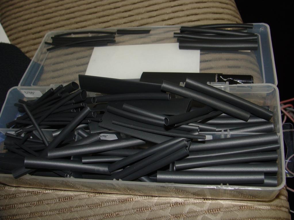

(note the nice, organized box of heat shrink sleeves in the background)
Add in the “add-a-circuit” and crimp down for a good connection. (again…note the nice, organized box of heat shrink sleeves)
We put heat shrink sleeves on everything to protect the connections. It’s cheap, and highly recommended! Again, notice the nice, neat collection of sleeves.

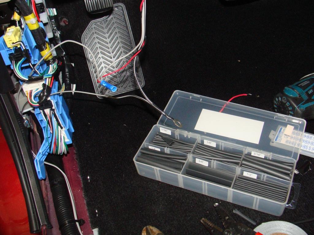

Plug the “add-a-circuit” into the fuse box in the “Tail” slot. Loop your grounding connection to the bolt and tighten it down with the nut.
Make sure that connection is tight before you test it out. Why? Because if your ground is not tightly connected, the lights won’t work. And if the lights won’t work after you made all of the connections “final” with shrink wrap and the like, you might panic.
And if you panic, you might knock something over. Like a container full of shrink wraps.
OK, enough of that. Now you just have to route the wire under the passenger seat and tuck the wires away, connect up that final LED strip, and you’re done!

Secure the LED strip to the coils under the seat (like under the driver’s seat), and make sure the LED lights are on the correct side of the strip.
Connect the speaker/electrical wire that you fished through to the LED strip, leaving enough slack to attach to the black wire bundle (like under the driver’s seat). Make solid connections and shrink wrap them tight.
Attach the wire to the black wire bundle and move the seat to see how the wire travels.
Once you’re satisfied, route the wire nicely through the channel under the door sill.

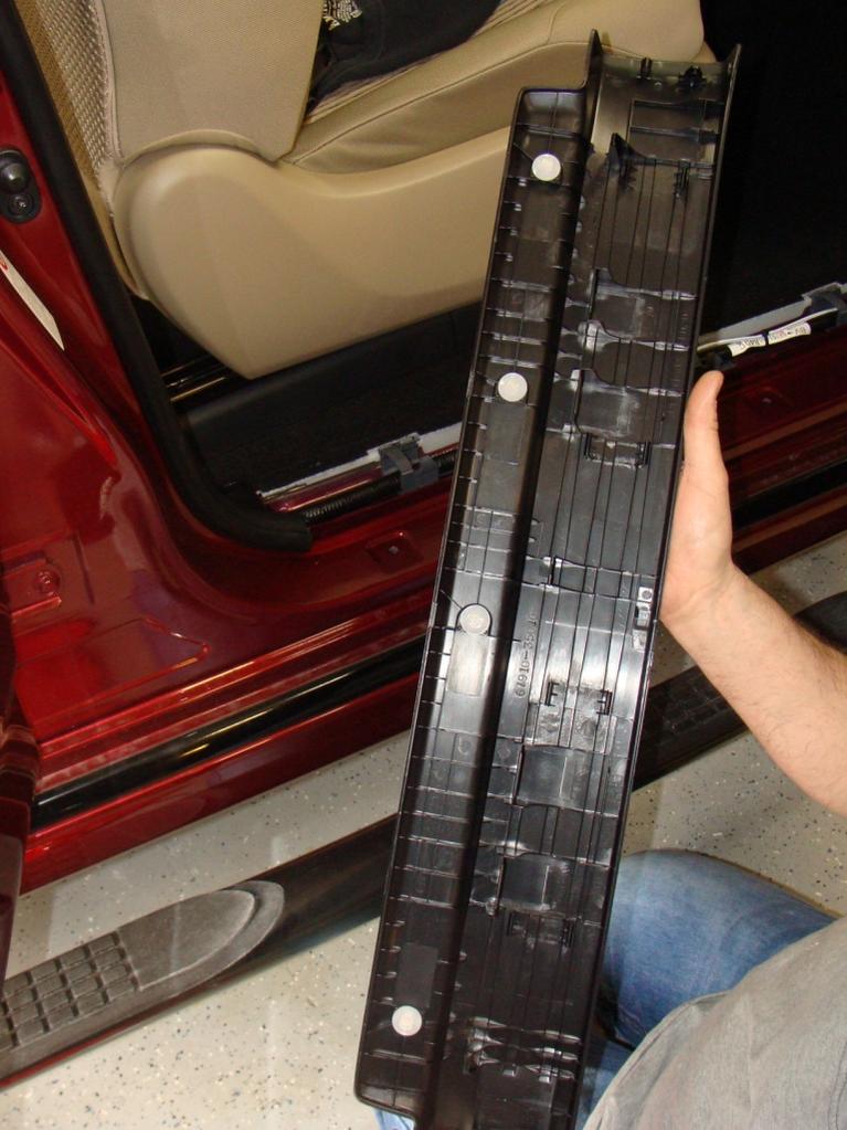

Pop the door sill back in place (on both sides). They have these white pegs that line up with holes in the metal body – they just pop right in with a good push.

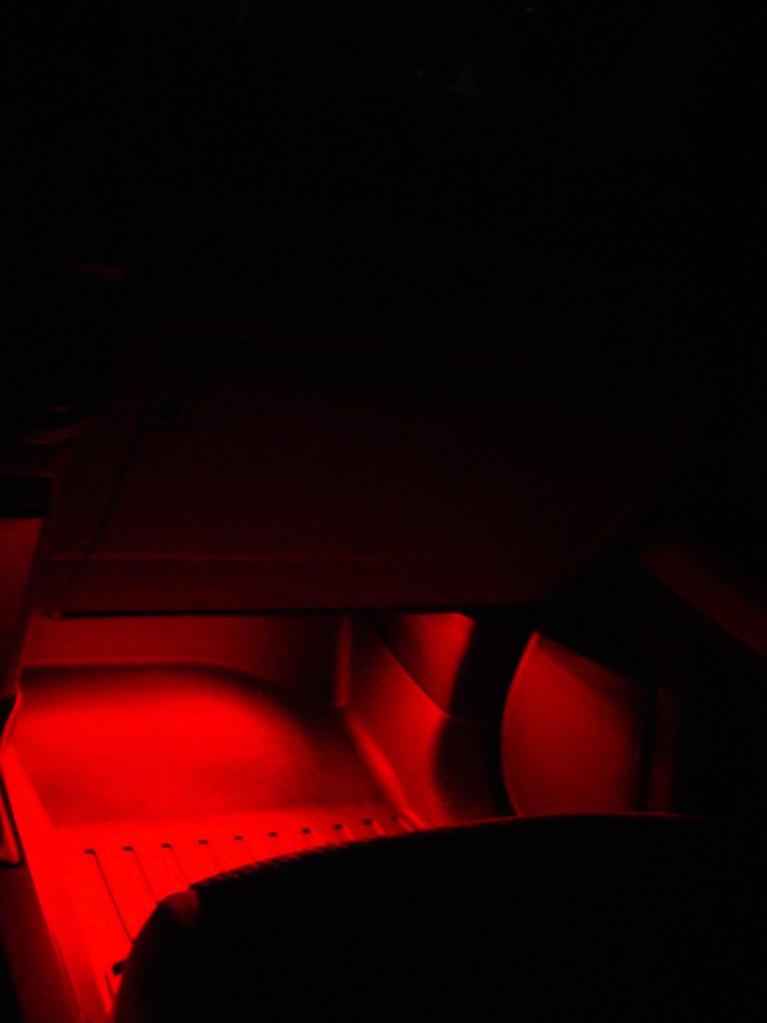

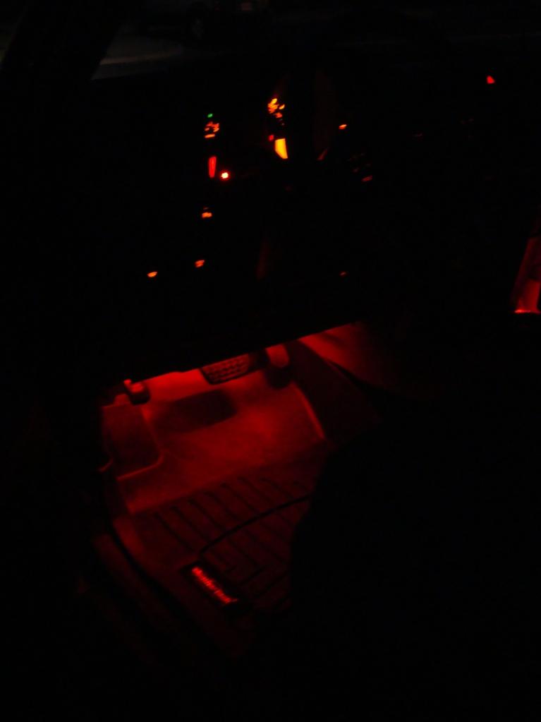

Driver and Passenger footwells (front row):
Driver’s side footwell:
Passenger’s side footwell:
Taken from the back seat of the front and second row, passenger side:
Is this cool? I think so. People like it. It might be a novelty thing. Who knows? Antman and I are adding a switch (mounted in one of the black “blanks” near the Parking Assist button, by the driver’s left knee) to give me the option of turning them off. But for now, I like it a lot! It adds a little “oomph” at night, for sure.
(Note: Kids love them)

whats up with that plastic box of black pipes? Or is that shrink wrap for the wires? You didn't really talk about it in the description. :lightsaber: hahaha
yeah, those shrinkwraps.. :P
he actually says
I was going for "inferred" humor. (that's "inferred", not "infared", despite the red glowing lights in the project)
By showing the box being very neat in the previous pictures (some haven't posted yet) - and then saying "don't panic or you might knock something over" and showing a messy box - I was showing people that the lights didn't work, one of us panicked, and in our rush to react knocked over the neat box of wraps.
(jokes aren't funny when you have to explain them)
I edited the text right before the "messy box" post in an attempt to clarify.
he actually says
In fairness to Johnny Utah, I made that edit (to add "like a box of shrinkwraps") after his posting.
