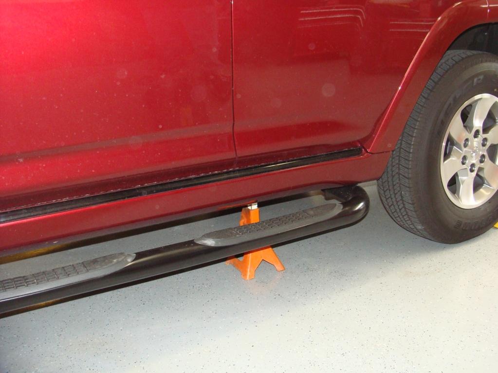

Step One: Chock the rear wheels.

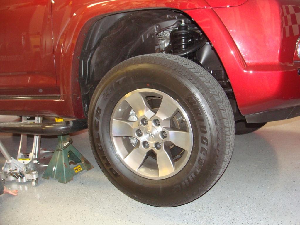

Step Two: Jack up the side on which you are going to install the lift. Put a jack stand under the truck and slowly lower the jack. For this series of posts, we are working on the passenger’s side. (we started with the passenger’s side because it was closest to the coffee pot)

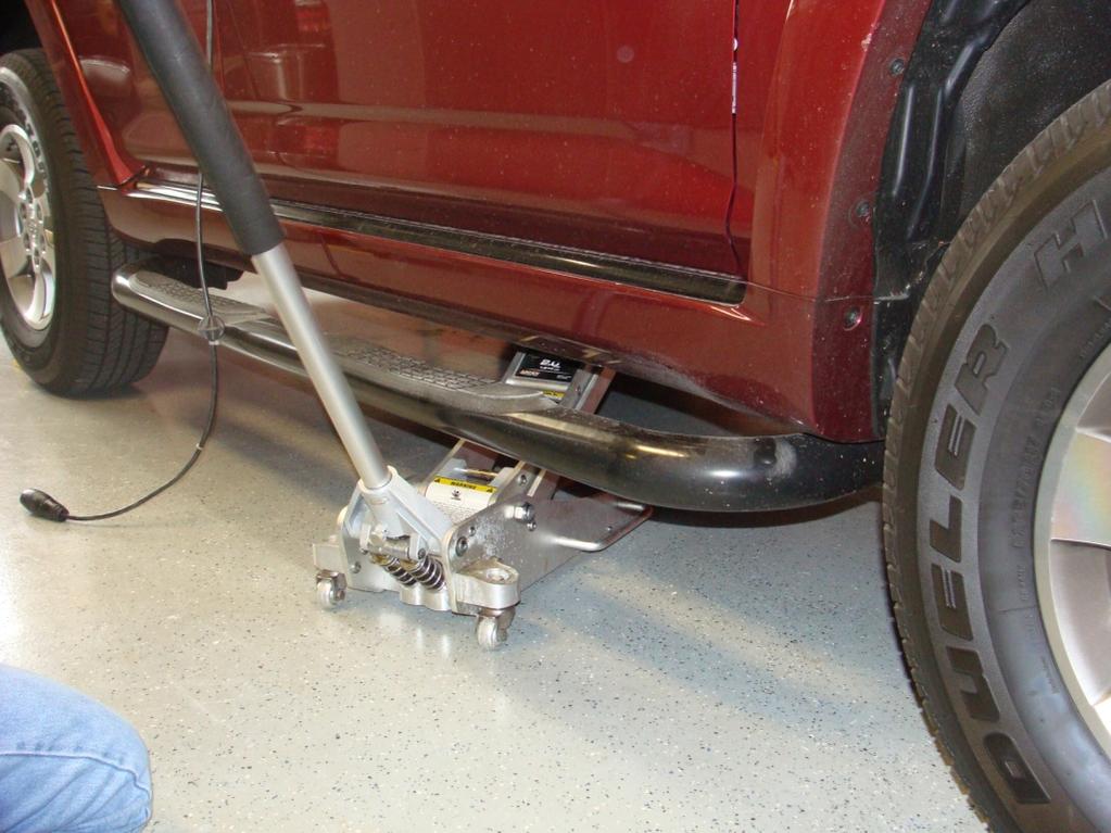

Step Three: Give the opposite side of the car a slight lift, and install another, lower jack stand on that side for stability.

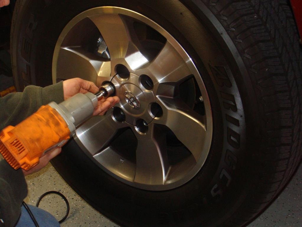

Step Four: remove the six lugs holding the wheels onto the rotors.
Step Five: Remove wheel.

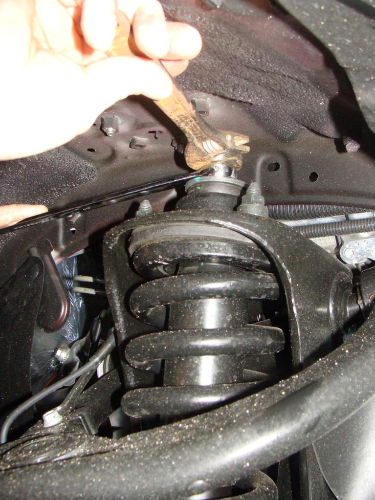

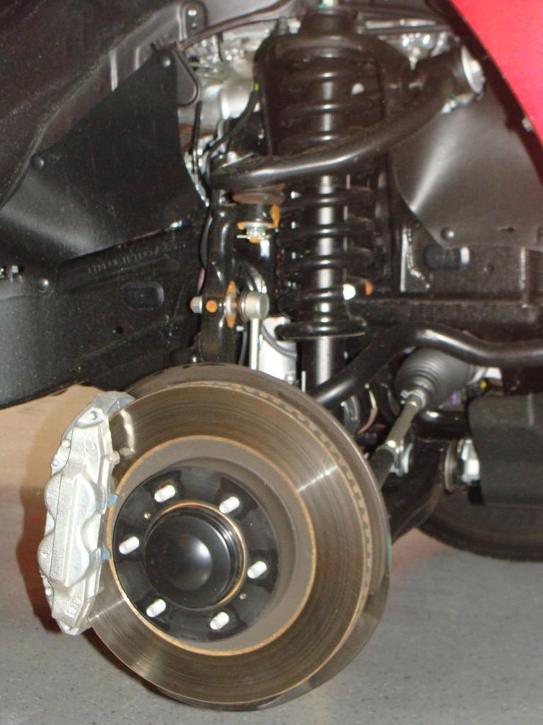

Step six: place the jack under the lower control arm (large metal part of the suspension just behind the rotor) to support it during the next few steps, because you’ll want that slight upward pressure on the spring while you do step 7.

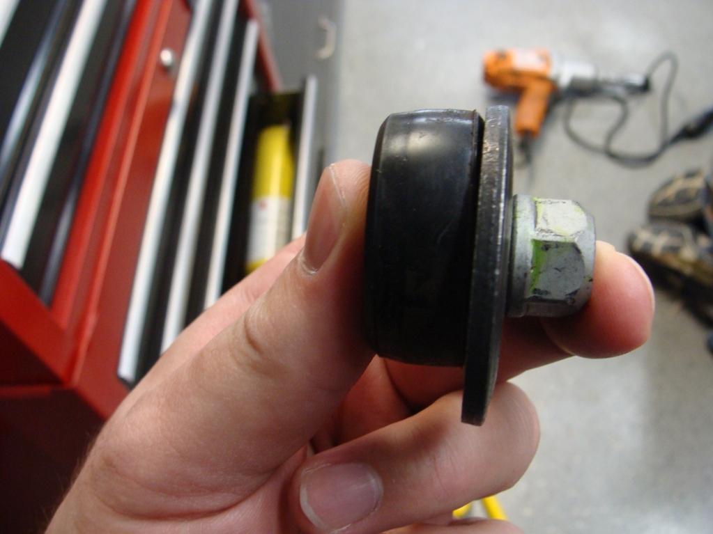

Step seven: Loosen and remove the nut, cushion retainer (a metal washer), and shock absorber cushion (a thick rubber disk).
[continued on next post...]
